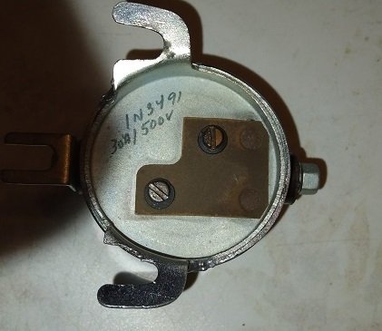

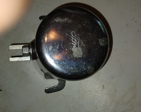

I have found in my stash of parts what is either a cutout or voltage regulator or possibly a diode cutout. Is it positive or negative ground. The reason I am asking is do I keep it for my Model A Ford or sell it because I no longer own T's?

"IN3491" is the part number for a diode... https://www.ebay.com/itm/144864349172?h ... R_aQ2rPNYg
A volt/ohmmeter test can determine whether it's meant for positive or negative ground.

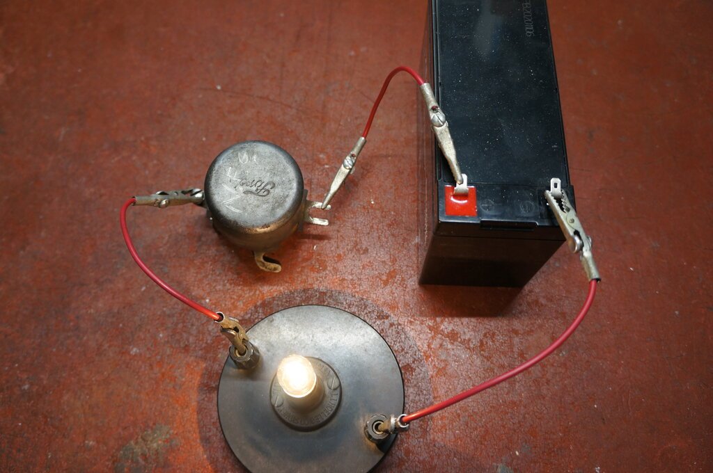

Short of opening it up and examining the diode connections, it can be tested to see which polarity it is designed for.
Aside from an ohmmeter test, a circuit can be built with a test light and battery: If it lights up as shown it's negative ground. If it lights up with the battery polarity reversed, it's positive ground. If it lights up both ways or not at all, it's faulty. Of course, this is applicable to diode cutouts only. Mechanical cutouts are not polarity conscious.

Re: CUTOUT CONFUSION
FWIW that is an A model cutout. TheT model ones with which I am familar, have both contacts on the flat. Being A model specific, should it be positive earth?
