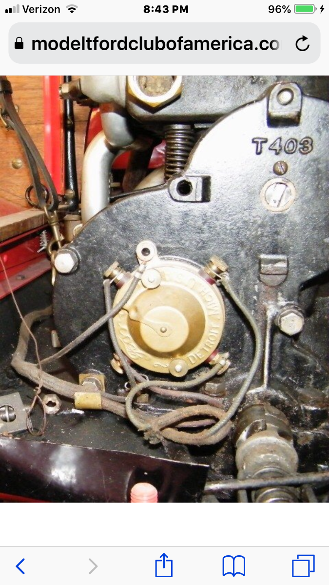

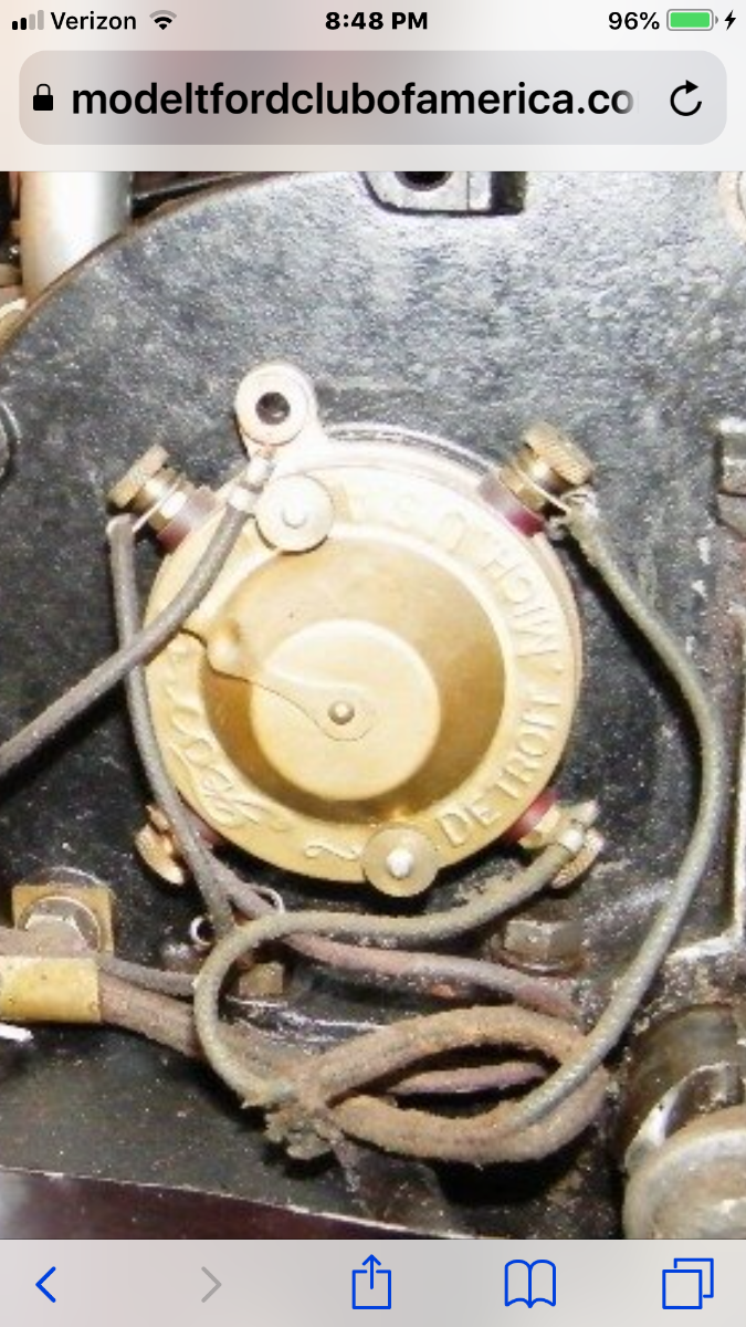

There is another thread showing a magnificent drawing of the early (up to 2500) fan assembly. In the discussion there is a picture of an actual car, seemingly #371, and it shows the wiring of the two piece timer. It appears to use a wire loom and shows a fifth wire which appears to be a ground return.
I thought the loom was actually four individual wires in a casing with rubber ends.
I have never previously seen a fifth wire as a ground return. Where does it connect on the coil box?
Anyone any comments.
Anyone know what is “correct”?

I do not know! However, to me, that looks like the standard timer wiring loom including the wire for the generator. In the past, some looms suffered availability issues. As I recall, some reproduction generator era looms were sold without right headlamp wire. Of course, we cannot see in the photo if that loom has the headlamp wire or not.
My guess, and this is wholly a guess, someone used a loom with a generator wire and no generator. So they simply put the extra wire on the two-piece timer thumb nut. And? Maybe they thought an extra grounding might help?

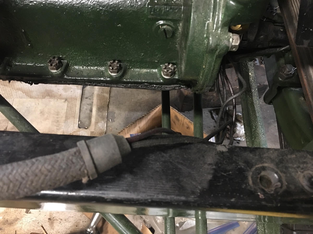

I took a photo of the loom on my 09, it is basically four wires inserted into a cable housing with a rubber end.
On looking more closely at the loom on #371, I believe it is a “generator” loom, with the generator wire used as a ground wire.
