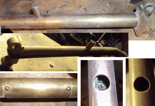

Post by Rich Eagle » Mon Aug 21, 2023 3:22 pm
Is this anything like you are talking about?
If so, I'll take some dimensions and better pictures.

Thanks for the suggestions, fellas. What I see in your photo doesn't resemble what I remenber, Rich. Thanks for the reply and offer though.
Re: Brass windshield bumpers
Post by Rich Eagle » Mon Aug 21, 2023 4:16 pm
Sorry it didn't help. For reference, mine is a Springaction.

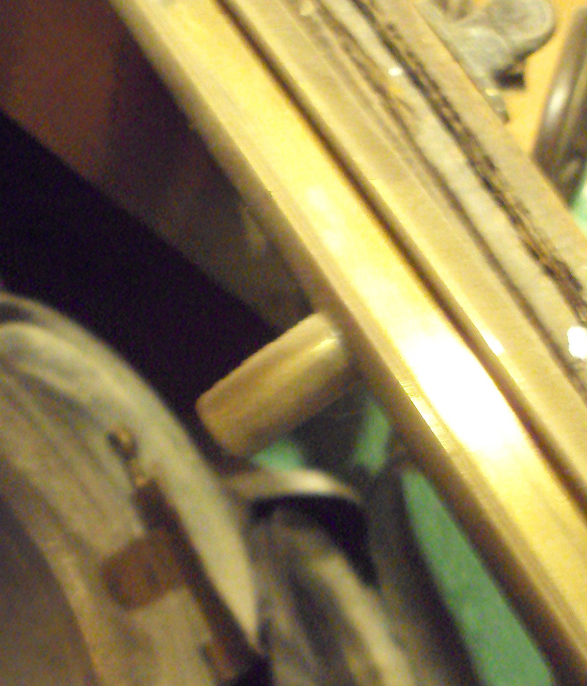

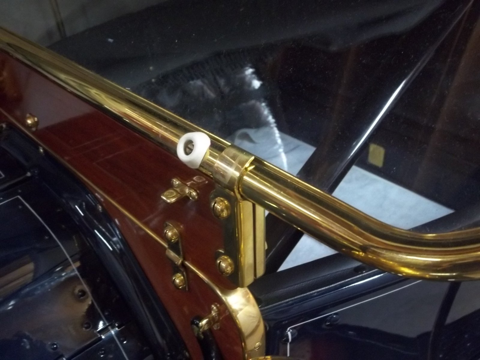

Post by Russ_Furstnow » Mon Aug 21, 2023 6:25 pm
Richard, I have an Automatic windshield on my Torpedo and it has white rubber bumpers on the lower half of the windshield. I don't know if this is what you are looking for or not. Russ Furstnow

Post by RGould1910 » Mon Aug 21, 2023 8:12 pm
Russ that's what I envisioned. I'll have to do some thinking how to attach them.

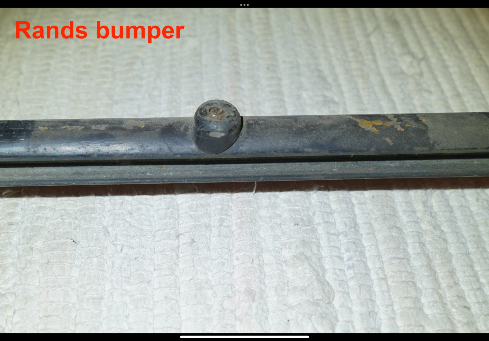

I had both a Rands and an Automatic ‘11 Torpedo windshield. The Automatic had the screws in place for the bumpers and the Rands had original bumpers intact. Here’s a picture of the Rands.[image][/image]
Here is a photo of a late 1910 square tank Torpedo courtesy of the Detroit Public Library showing what appears to be a Rands windshield and black bumpers. https://digitalcollections.detroitpubli ... a%3A174631
I have also seen photos of ‘11 cars with what certainly look like white or lighter colored bumpers.
