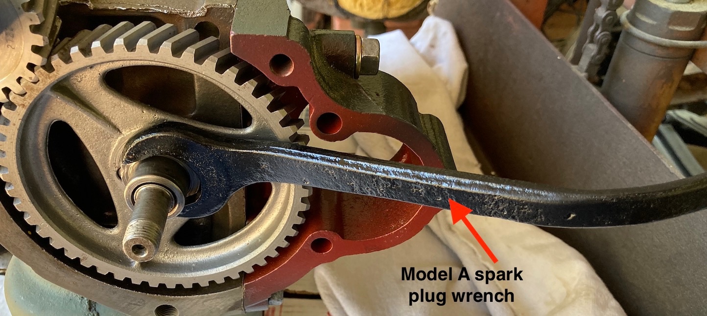

Post by DanTreace » Tue Sep 12, 2023 1:09 pm
A friend just uses a Model A spark plug wrench, bend in handle works ok. But a specialized tool would be likely best.

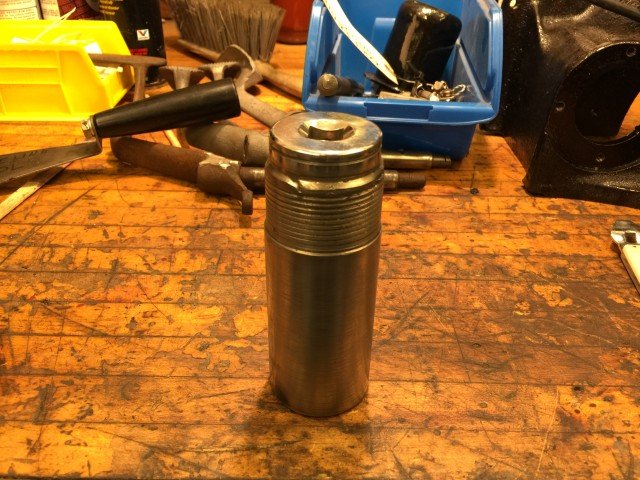

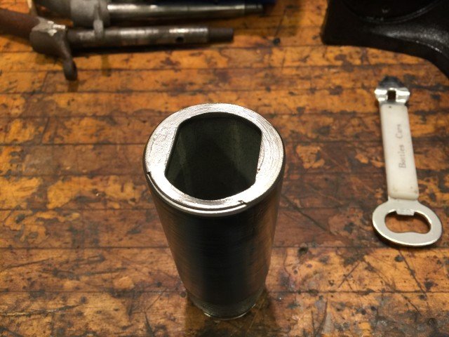

Re: Cam nut wrench!
Post by BE_ZERO_BE » Tue Sep 12, 2023 2:58 pm
A Snap-On 36-F socket is the correct tool.
Or one can be made from a front wheel bearing wrench
(cut from a hubcap wrench multi-tool),
a piece of tubing and an old socket.

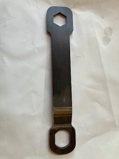

Post by Les Schubert » Mon Sep 18, 2023 5:32 pm
I picked up the cutout wrenches and now to bend them!!

Post by Les Schubert » Tue Sep 26, 2023 5:15 pm
The first one!
17 more soon!
