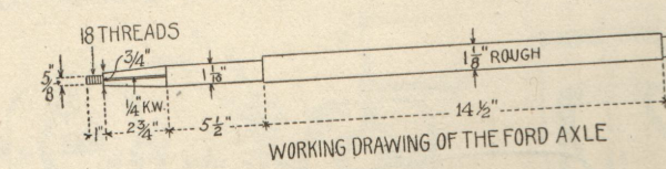

Can someone tell me the taper on the end of an axle?

maybe this helps?

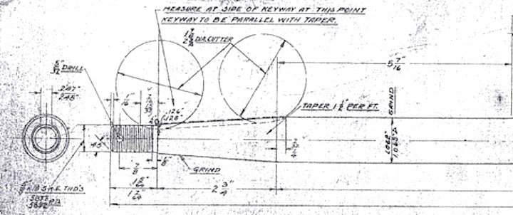

This post mentions a taper of 1.5 inches/foot.
https://www.mtfca.com/discus/messages/2 ... 0tolerance.
For the dimensions shown in the drawing in this post, the taper is 3.546 degrees
A 1.5 inch change in diameter per foot of length gives a taper angle of 3.576 degrees

A little trig work, I come up with 3 degrees 15 minutes. Or 3.25 degrees/side. 6.5 degrees total

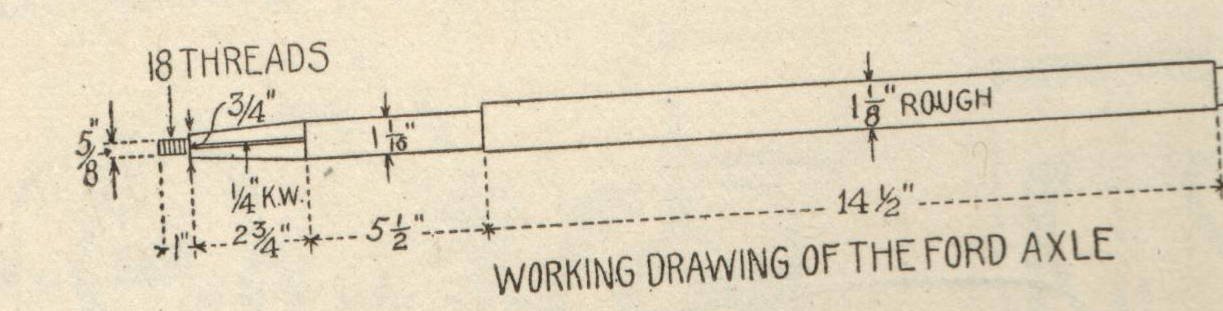

1 1/2" per foot. Ford axle drawing.
