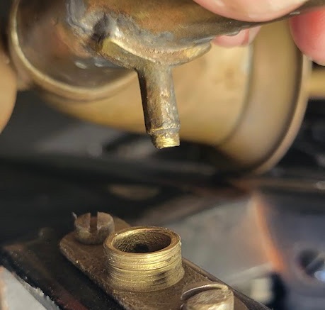

My brass horn mount decided to break on me and I'm looking for options. I've never soldered brass but I'm willing to give it a try. What you see here is what I'm left with. The stem snapped and the brass cap is missing. Do I need to de-solder the remainder of the stem? Lang's horn mount doesn't seem like it would fit this horn.
How would you go about repairing this?

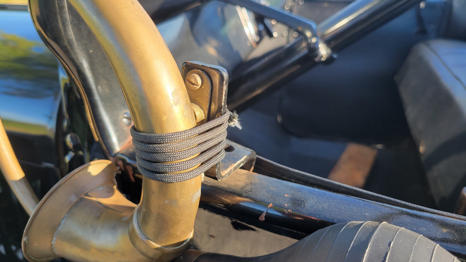

I'll have to MacGyver something for now for a fair I'll be at tomorrow.

Dan, check this post: What have you done to your Model T in September? - MTFCA Forum
https://www.mtfca.com/phpBB3/viewtopic.php?f=2&t=38488
Post by RGould1910 » Mon Sep 11, 2023 3:57 pm
Repaired a broken horn bulb bracket. Langs says the soldered joint often breaks. Mine did. I saw no sense In resoldering so I did a mechanical repair with a 10 32 machine screw and a small copper washer using blue Loctote to hold things tight.

Silver solder

For my son's baseball game tonight and the fair tomorrow I have a temporary fix...
I'll need to figure out a more permanent solution soon though.

Any place that repairs brass band instruments should be fine with repairing that horn. They will do a much neater job than the people that built it originally, and they will probably silver-solder it. (Much stronger than soft solder.)

Dan, as stated earlier silver solder should work. A few issues you’re having are based on the cast & the length of the post. The mount post looks like a sand cast and just my experience with sand casting is how brittle it is. The other problem is the length of the post. This issue is also seen with the mounts the vendors sell. The originals are fairly short compared to the repops. The longer post creates more vibration than the shorter style thus not sturdier than original. Good luck.

I never would have thought of going to an instrument repair shop but it makes perfect sense. I just checked and there are about 5 of them within a 40 minute drive. I'll have to reach out.
JTT3 wrote:
Fri Sep 15, 2023 7:31 pm
It does appear to be a very thin post considering the size of the horn. I can see why these break easily. With the missing cap and part of the post, I'm thinking this is a little more difficult of a repair.

Dan I think you could do it very easily, especially if you unscrew the other part of the mount so you could work with it a use Silver solder not just solder. Looks like you could sink the post deeper and fill the hole up with silver solder. Just remember you’ve got to screw that back on so have a way to do that. You might even be able to die the post and put a nut on it after a fill & drill on the piece off the horn.
