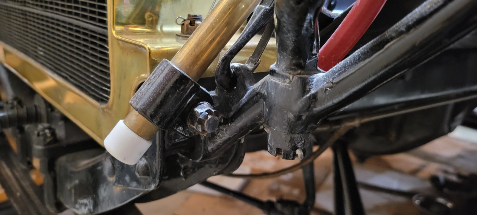

My car has them, 85,XXX, but they are not easy to photograph...

and they are not that easy to reach to disconnect the strap clip either, especially when the radiator is warm!
