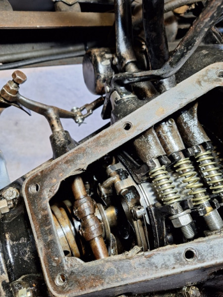

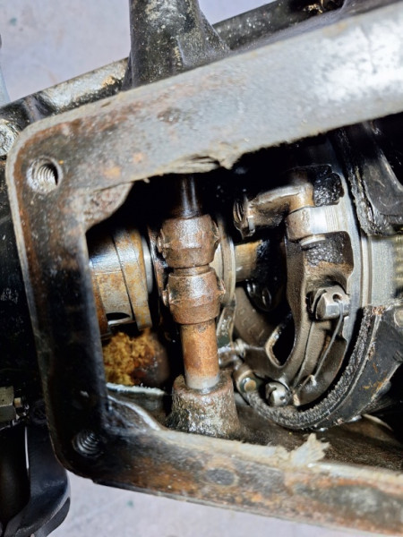

Here are some photos of the inside of my transmission, I placed the band central to the brake drum and adjusted it so that the pedal stopped about an inch from the floor. I them pressed the pedal a few times and the band slowly moved rearwards with every press until it moved enough off the drum for the pedal to hit the floor. Looking at the bolt and lock wire I would say that it has been running in this position for a while.

Not necessarily pertinent to your problem, but it appears you have a late(26-7) output plate on an earlier narrow drum. The output plate edge becomes part of the brake drum surface. There should be no gap between the drum & plate. As is, you potential have 2 razor edges cutting your lining.
That situation may be cutting & wearing out your band material.(likely) I do believe you have the correct HH to match the narrow brake drum.
To that point, judging by your return spring, your band lining is worn out . Needs replacing.
The shifting band may be caused by loose material on the band as described earlier. With a relatively round band & properly attached lining & tightened, the band hasnt the room to run off until severe slack takes place from wear in the band material.

the band material looks THICK! and yet the band is adjusted as though it is worn out. I pondered about the pedal suddenly going to the floor along with the band material pooching to the rear and I really wonder if perhaps the steel band is not fractured and the friction material is now free to wander

The fractured band theory is a strong one. Its quite common to find bands with the beginnings of a crack @ the lower rivet tab on a demountable band.
It should not be repaired. The band should be replaced. Welding the crack up typically insures its eventual total failure.
I have experienced a brake band complete break. Going down a mountain highway on a newly (hours earlier) purchased T. Fortunately the 27 big drum parking brake was just dry enough to eventually stop the car.
Anyway if you tighten the band & it loses its setting quickly, it may well be the lining is stretching & the only thing holding the band in place for now.
Either way the next step is to pull the band.
If you do replace the band & lining, get in there & file down the 2 sharp edges @ the back of the drum to minimize the lining damage untill you get around to tearing things down to replace the drive plate. I would use a tough lining like the scandinavia "tar baby" in the mean time.

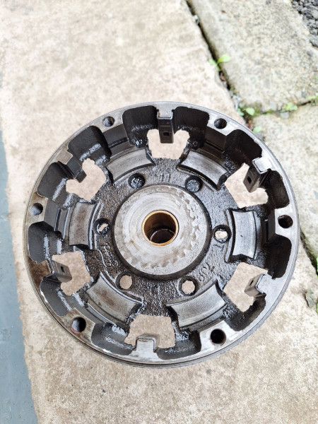

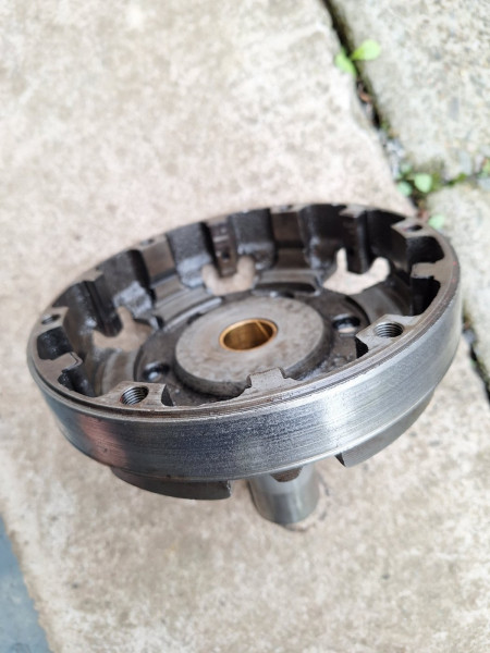

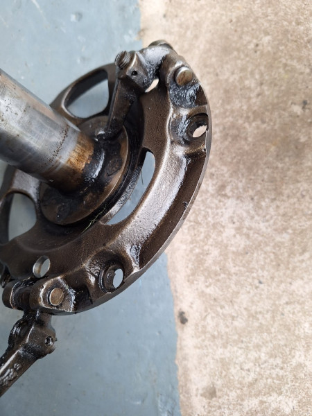

I have taken my transmission apart to try and solve the issue with my brake band, hopefully someone can advise me on what I have and the best way forward, I believe my drum is a wide drum which has been machined in to a narrow drum but then they have used the drive plate off the wide drum, can the narrow drive plate be made to work with a modified wide drum?

Your drum isnt necessarily a cut down wide drum. It looks like the late narrow replacement drum that did come with shoes. The drive plate would have the lip like the pre 25 plate, but with a slightly different bolt mounting pattern. That lip was actually part of the drum's lining surface.

Your drum appears to be fine. You just need the proper drive plate. Is the outside diameter of the drum, (where the brake band rides), straight, and not tapered?

OK, now it can be seen what has been done, the drum is an 1925 narrow band and fitted shoes, a rare drum, if it was a wide drum turned down, the number on it would be T-709-B The T-709 is the narrow drum number, The drive plate is a wide drum one that has had the bolt holes over sized to try and marry it to the drum, remedy is to find a small drum drive plate.
