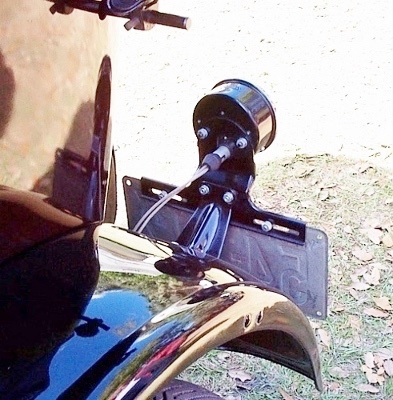

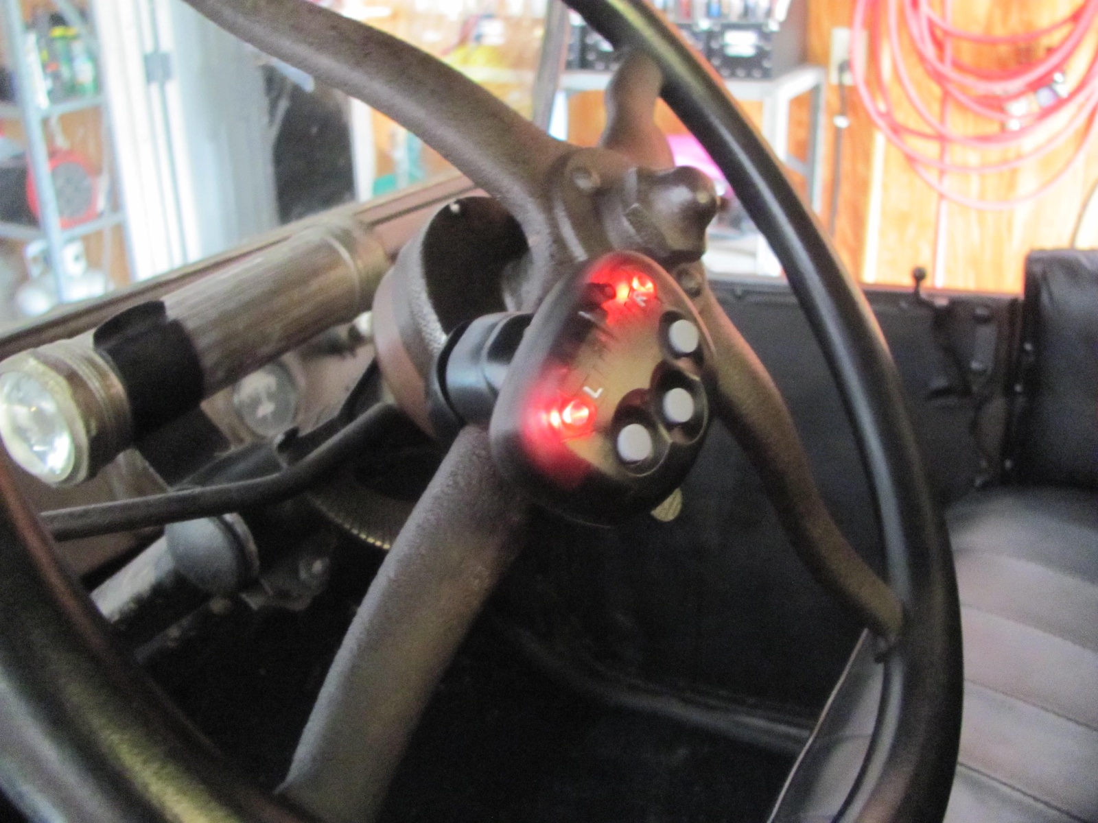

So adding at least rear turn indicators is a good idea. Have good success with the bicycle turn signals, wireless. Clamp the control module on your steering column, fab up a bracket for the rear, have mine on the license bracket.
Now for sure, these wireless ones are adjunct to your 'hand signaling' anyway, figure arm out and flasher on the rear MAY help stop someone from passing me on left turns! :)

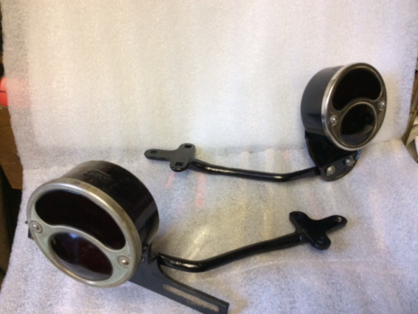

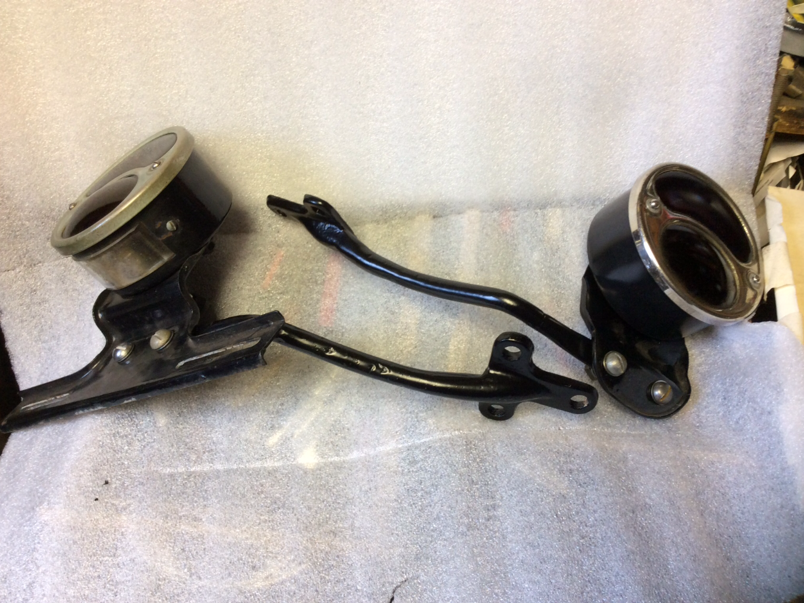

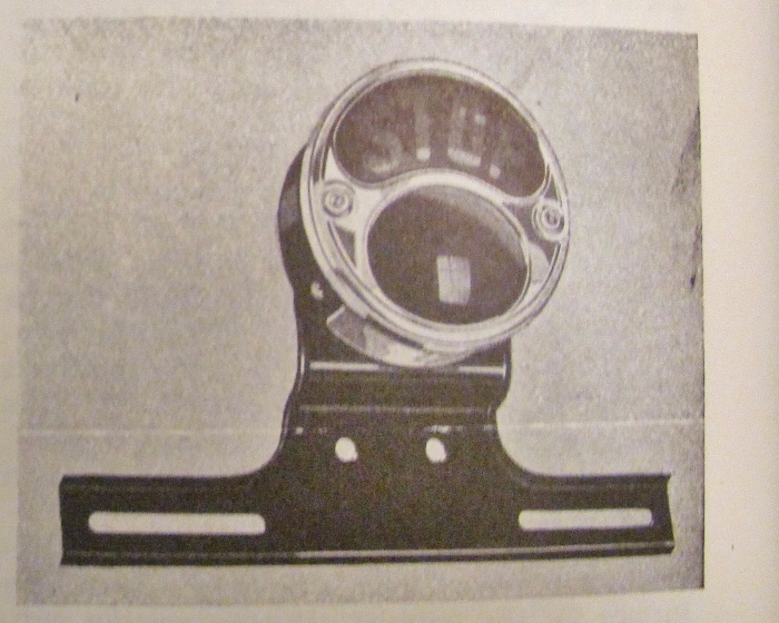

As for brake lamp, you are in luck with the '26, you can add the factory accessory Stop/Tail lamp. And have a nice brake light too. They can be found still today at swaps or eBay.

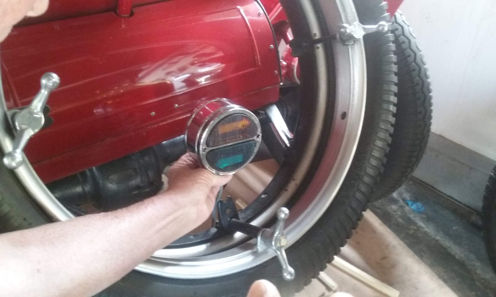

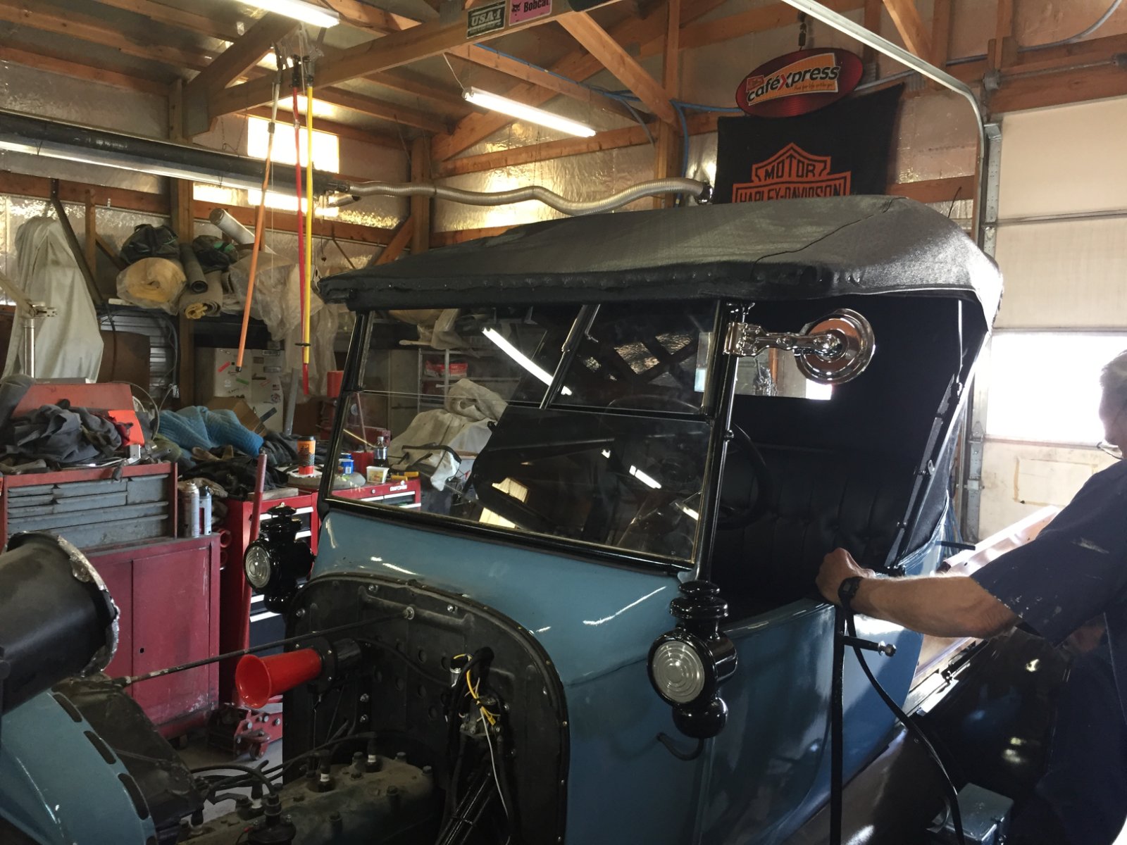

I just completed a restoration on my '25 using front/rear sidelights from an '18 0r '19 T converted to signal.stop lights. There are numerous sellers for these sidelights on Ebay. I got mine from a local old time car restorer that has a graveyard of T, A and other cars. Assuming you have a 12v conversion>

I kind of did what Dan has with the wireless bicycle turn signal system, using the double flasher when needing additional warning if in traffic.
I have the light itself setup so I can insert it into the automobile bracket that’s available for that light, on the tail gate so I can add or remove it easily. The base of the clip is black so it blends in easily.
For the main brake light I added a lightbulb into the rear kerosene lamp wired to a stop switch at the base of the brake pedal. You can get that switch from Langes or Macs I believe.
This keeps the vehicle stock looking when you need it to be.

If not pure, you can at least do it so it looks authentic. The venders sell a right hand tail lamp bracket for your year car. If you look closely , you can see I filled in the license plate lens hole. A little modification to the mounting bracket, and to me it looks like something Henry could have ( should have ) made. These are mounted on my station wagon, so I used fender irons reshaped. My rear M-P fenders were never drilled for lamp mounts. I also hide turn signals, and also use period stuff for this. It’s great fun to search out and restore turn signal sets from the era, and I use small glass lights hidden up in the chassis so less conspicuous, BUT these ford issued accessory tail lamps can be rewired easily for turn signals. Again, just my opinion, but I've scraped my share of victims off the asphalt, and it ain’t a pretty sight!

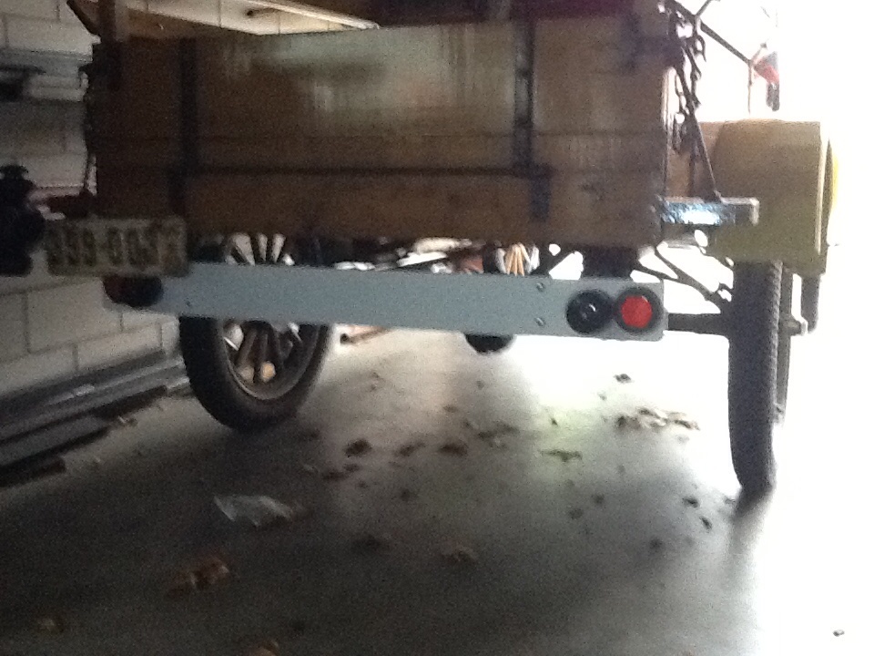

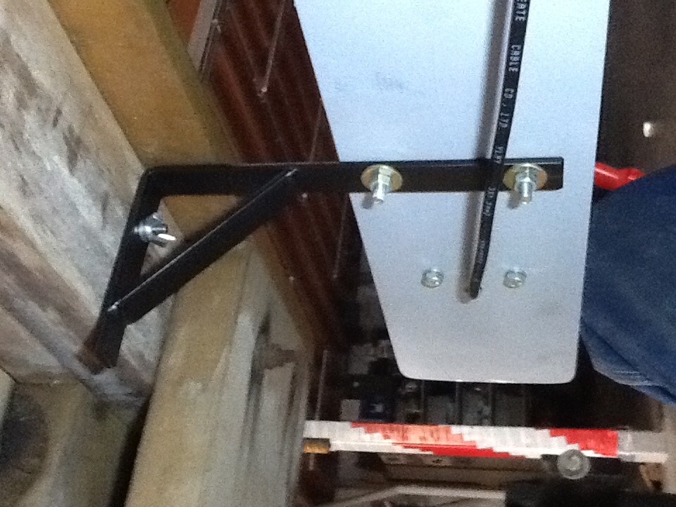

I had the same problem, how to have good visibility and at the same time keep things sort of period correct or at least not too disturbing.
I couldn't figure out how to combine the two issues so ended up making a removable board with additional lights and reflectors, the lights have LED bulbs in them so are very bright, the whole board is mounted with two wingnuts and the connection is with a hidden trailer connector, so in case you are on a show or need to be period correct i can take the board with wiring off in about two seconds flat.

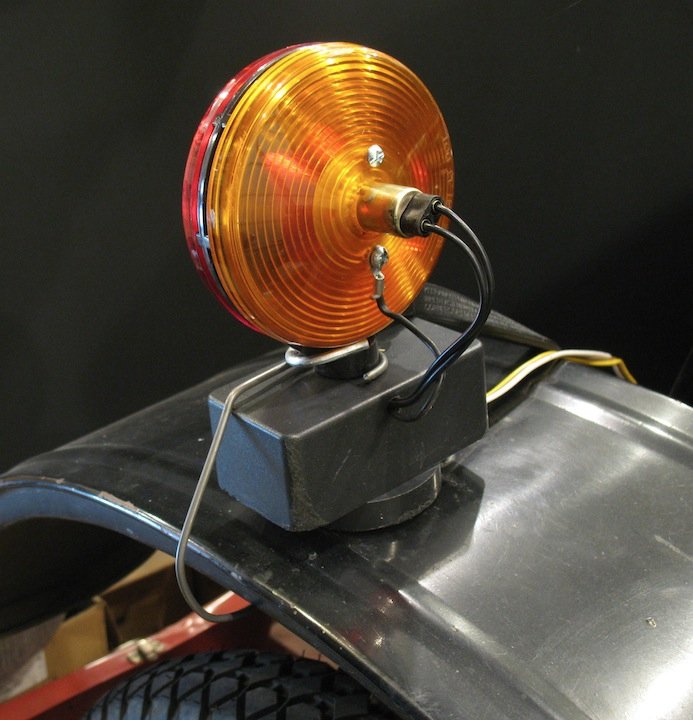

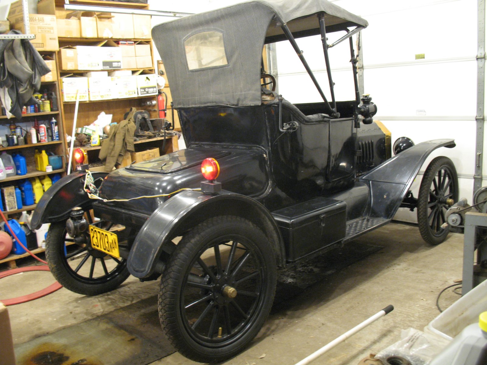

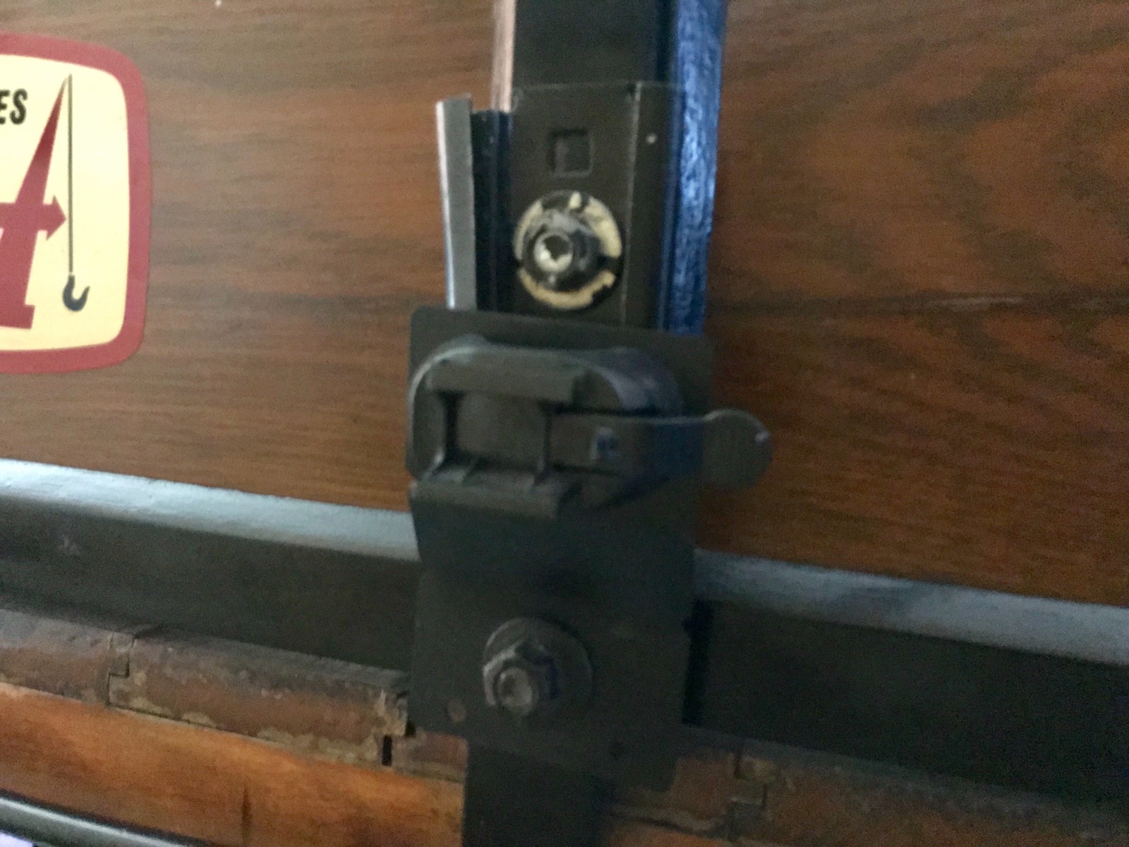

I carry a set of trailer tail lights in my trunk and put them on if I get caught out after sundown. I think they were about $20 from HF. I converted them to six volt LED.
A word of caution: Magnetic lights can bounce off. VOE. I keep them on with a ¹⁄₈" welding rod hook and a rubber bungee.
I also prefer widely spaced tail lights rather than bike lights. Bike lights are generally less visible (smaller) and being together in the center of the vehicle are easily taken as a single light from a distance.

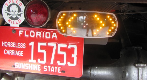

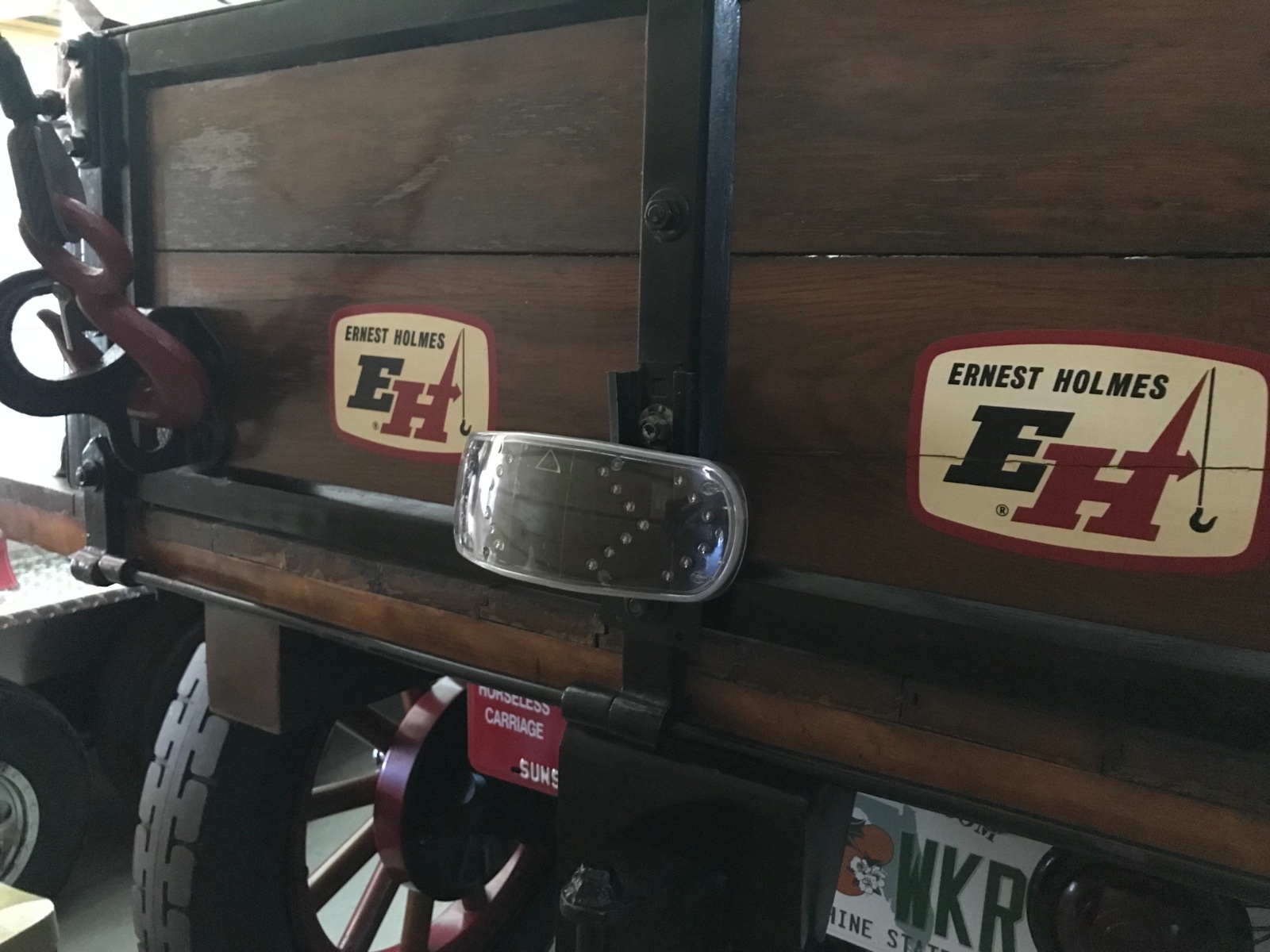

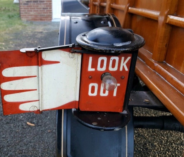

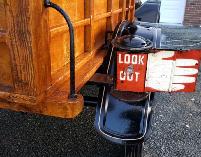

Then again there are these turn signals that fold out when the signals are activated :
Kind of hard to miss.
