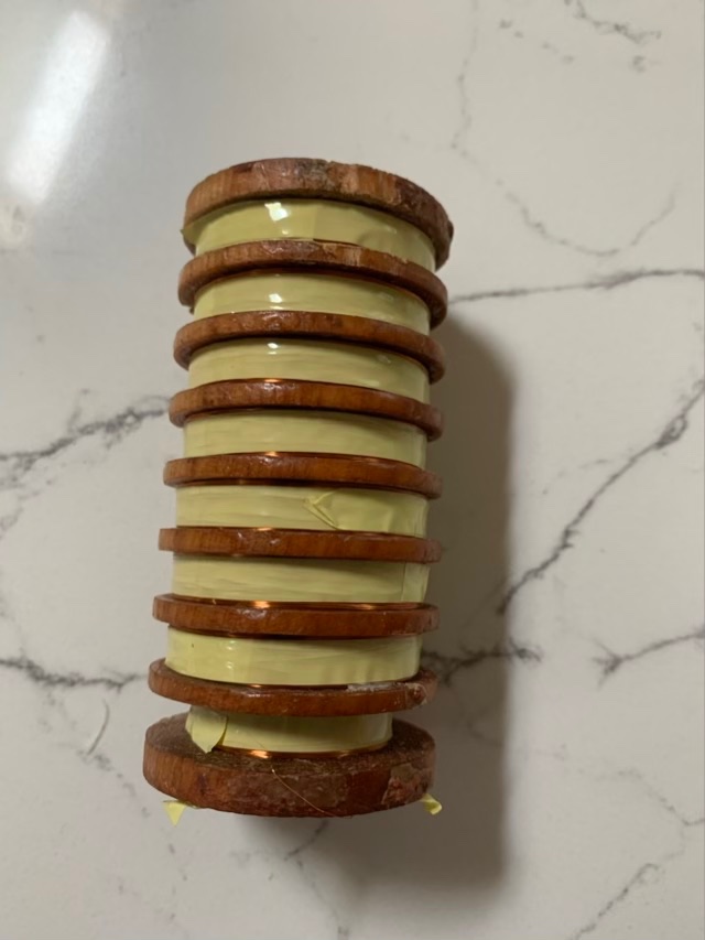

2-5/16” X 3-1/16” X 5”
Spool is 2” X 3-7/8” - 8 sections. 5/16” wide. With 7/8” hole down middle.
Wood is 1/4” thick on each side except where it goes down to
1/8” thick where the coil resides.

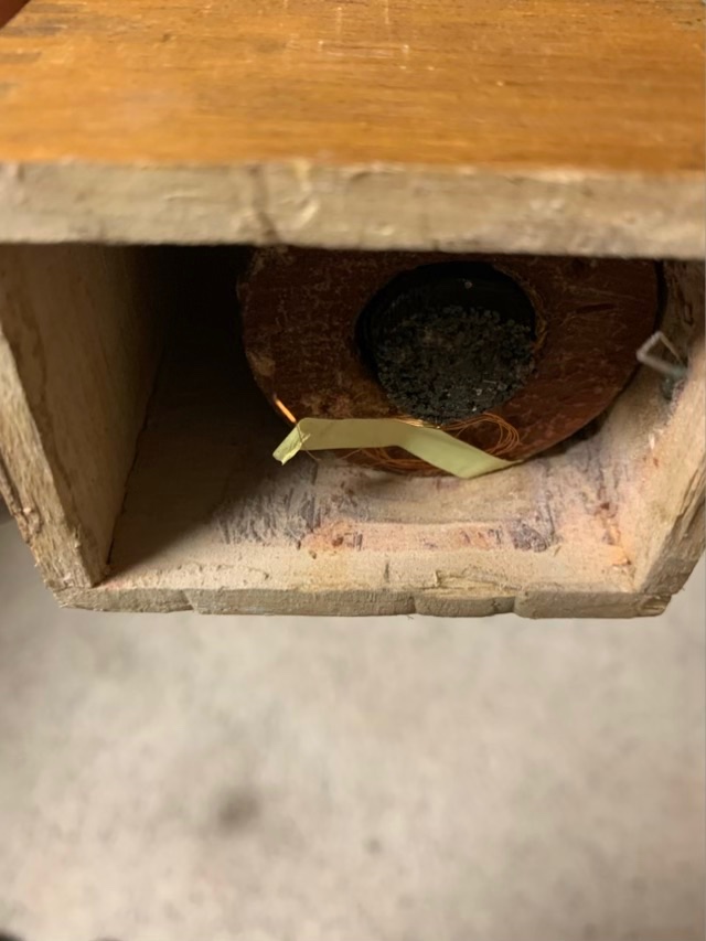

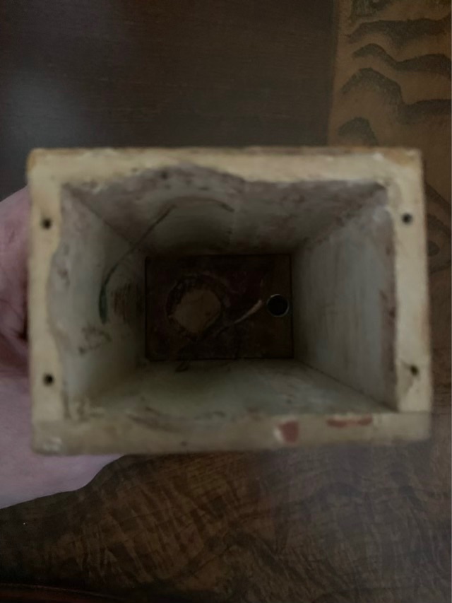

You’re Welcome! As you can see they drilled the column for the coil after the box was assembled. They didnt drill all the way through either! They stopped about 1/2” shy of the bottom!
Notice the lip!
