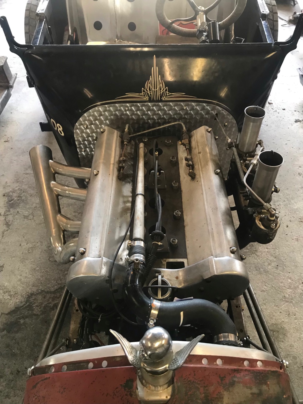

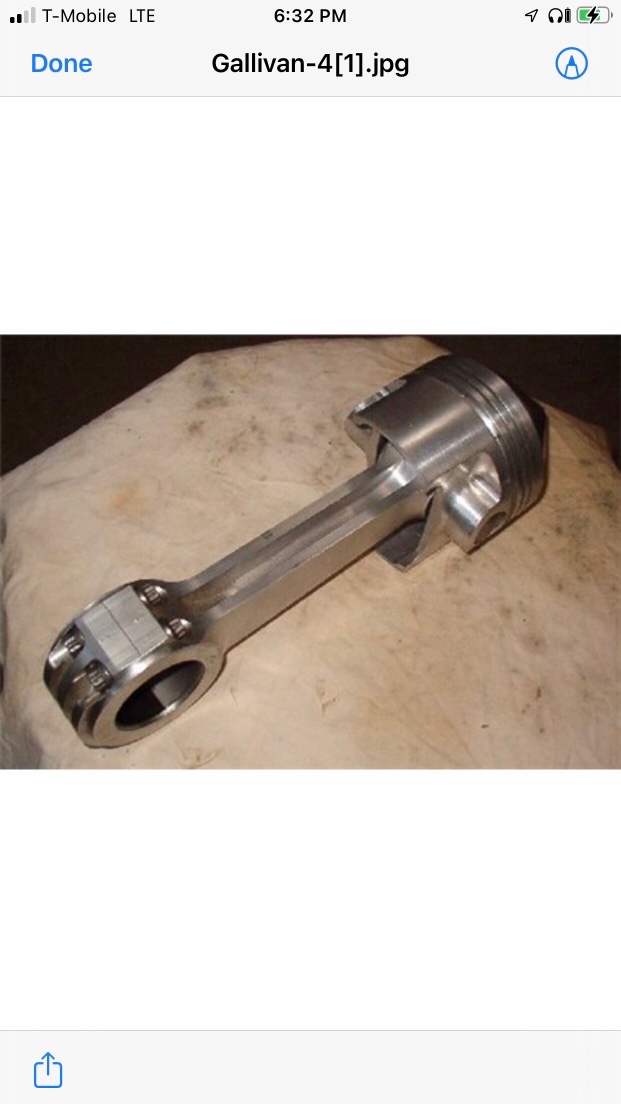

I have a Gallivan dual overhead with a model c counterbalanced crank in a 1915 roadster. It has a 4 dip pan with a fabricated sump. 4 pan inspection covers were used to fabricate the sump. Welding the inspection covers on edge then the 5th cover welded to the bottom of the sides. I have 4 gallons of oil capacity with an outlet from the transmission to the lower back end of the sump. The crank and mains are drilled and fed with pressure oil, as are the cylinder walls. This engine has been running since 1955 with no repairs, bearing issues what so ever.
No clearance issues since it was built in 1955. This particular car was clocked in 1955 at the Yakima Wa airport by the Washington State Patrol at 113 miles per hour(no I did not drive it that fast, the original restorer did). When I removed the sump for cleaning I took special notice to see if there had been any issues with clearance on the crankshaft throws or any other places there were none.
Now I think you can buy a sump spacer for 3 or 4 dip pans and a 3 or 4 dip aluminum sump.

Here are some pics of the Rajo DOHC. Use of the full size B crank was possible because the cams are overhead and the main bearing webs were machined out and replaced with larger ones. This engine performs very well up to 6500 rpm.

dick dock that Gallivan has been torn down twice since Bert built it that I know of, once by Bert for new pistons before it ran on the airstrip and after Ron purchased the car everything was torn down new bearings poured new Hisso valves made and at least two maybe three new front drive gears made as for your earlier question on head gasket it has a standard Rajo Fronty gasket. Don't know about your cylinder oiling . The new pistons that Kippling had made took at least 2 points off the comp. ratio I still have one of the original pistons that is 1/8 " bigger bore and 1/4' higher dome than what it has now. Took a little snap out of it. Very cool car though when did you get it from Jarvis?

Scott, I am not sure my DO Rajo is the same one you are talking about because I don’t recognize the names you mentioned, but what you said sounds like it is the same one. It was built with high compression pistons to compete at Long Beach. That event ended before the engine was ready and it always rebuilt with lower compression pistons to use a supercharger or some kind of exotic fuel. The net result is that it has only 75 psi compression. It goes like hell but could really use the high compression pistons back in. We know where they are and will have them back. We bought the engine from Brian Blaine of ragtime racers. We built the rest of the car around it.

I have the old pistons rods, valves and timing gears.. I was at Berts place, when Ron showed up screaming at Bert because of the damage to the motor. Ron had the motor in the back of his truck partially disassembled problem was the timing gears had given up and seized on the mounting shafts. After the smoke cleared Bert actually refunded a substantial amount of purchase price to offset what it was going to cost Ron. I have all the records that Ron kept during the repair process. There was no bearing work done according to these records. Pistons, rings, new timing gears and stub shafts were replaced the valves were replaced as were the springs, with a new head 'gasket, intake gaskets and exhaust gaskets.
