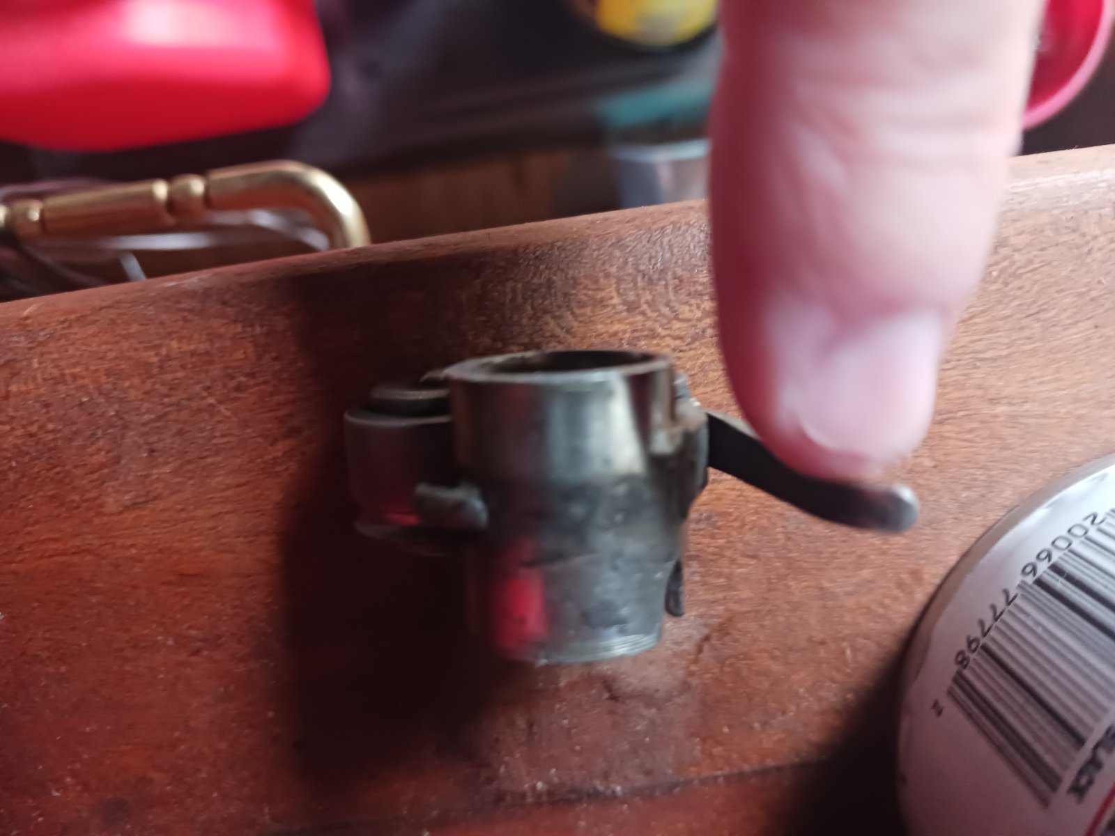

UPDATE - Electrical/Timer issues
First off, many thanks for the kind and helpful suggestions.
As I always say, if a question can't be answered on this forum, the question doesn't exist
Went through the coil box, spark plug wire, etc., trying this and trying that.
I was still in search of the answer to the elusive mystery of the non-firing #3 coil/commutator contact.
Worked my way down to the commutator and took it off for further examination.
It then became instantly apparent that the roller spring had come off!
The large "ear" of the new roller was not angled sharply enough to hold the spring.
Either a reproduction design flaw or something I should have known to correct when I bought the new commutator mechanism.
I bent the ear back a bit so that the spring from the old roller fit nicely on the new one.
Reinstalled the commutator and went through the firing cycle with the crank. 1,2,4 and 3 all fired as they are supposed to.
Sometimes it's the really stupid stuff that goes wrong...
Pictured is the old roller.
I know the spring was on the new one and working properly when I initially installed it several days ago.

Not sure what year you got, but reuse the spring contacts in Coilbox. If you bolts that hold them in are steel, replace them with some brass ones from an earlier car. Use electrical lead solder and solder the contacts to the heads of the brass screws.
Makes a big difference.
