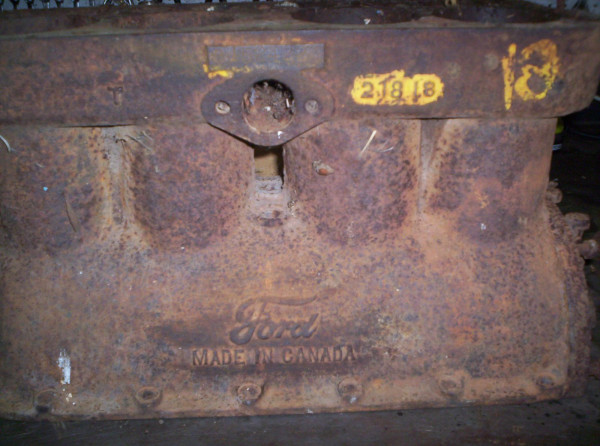

Canada starting to cast their own blocks in late 1919 was and is a bit of a myth, blocks do turn up for early 1918 with "Made in Canada" on them. I have seen one a few weeks older than this one.
