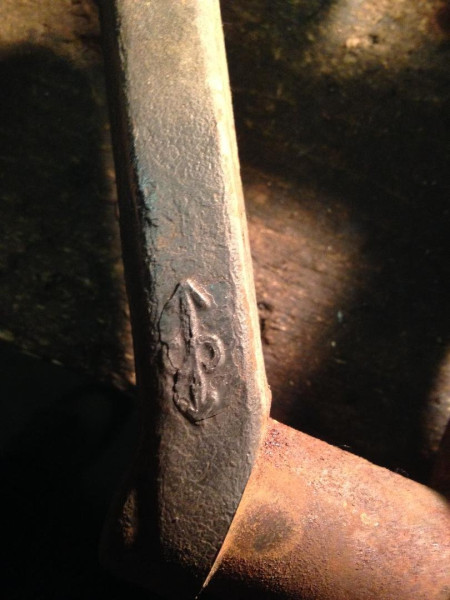

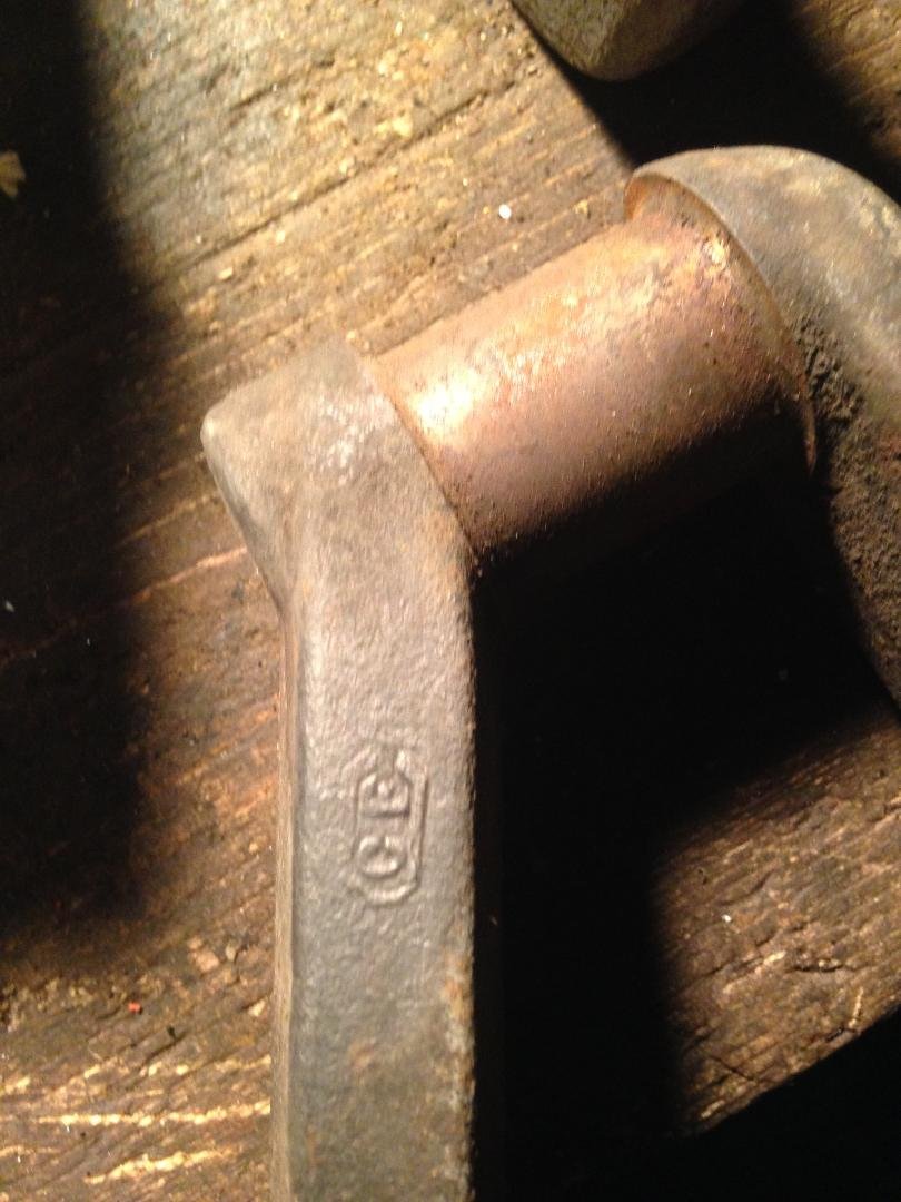

Hi,
Recently, dug this out of the shed.
Included are the markings on a counterbalance crankshaft. Does anyone have an idea who made this?
thanks
Kevin

Shermike. They made 3 versions. Not enough seen to determine which one.

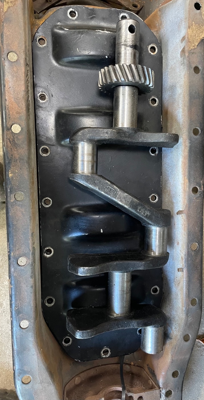

What about this dandy?

Looks a might short John !!!

Now that one looks pretty nice. it's got some scarring near the front seal and pulley but looks a little short on the back end??
I have a couple of cranks here in the shop with the same problem!
John, How can a person tell them apart? I have two, one in a running engine and a spare. I'd like to know if the spare is one of the better ones.

The difference is the size of the counter weights. I believe the "short" one shown is the best #3. #2 are a smaller dog bone shape. #1 has very little counter weight. This is from research basically looking @ aftermarket adds long ago.

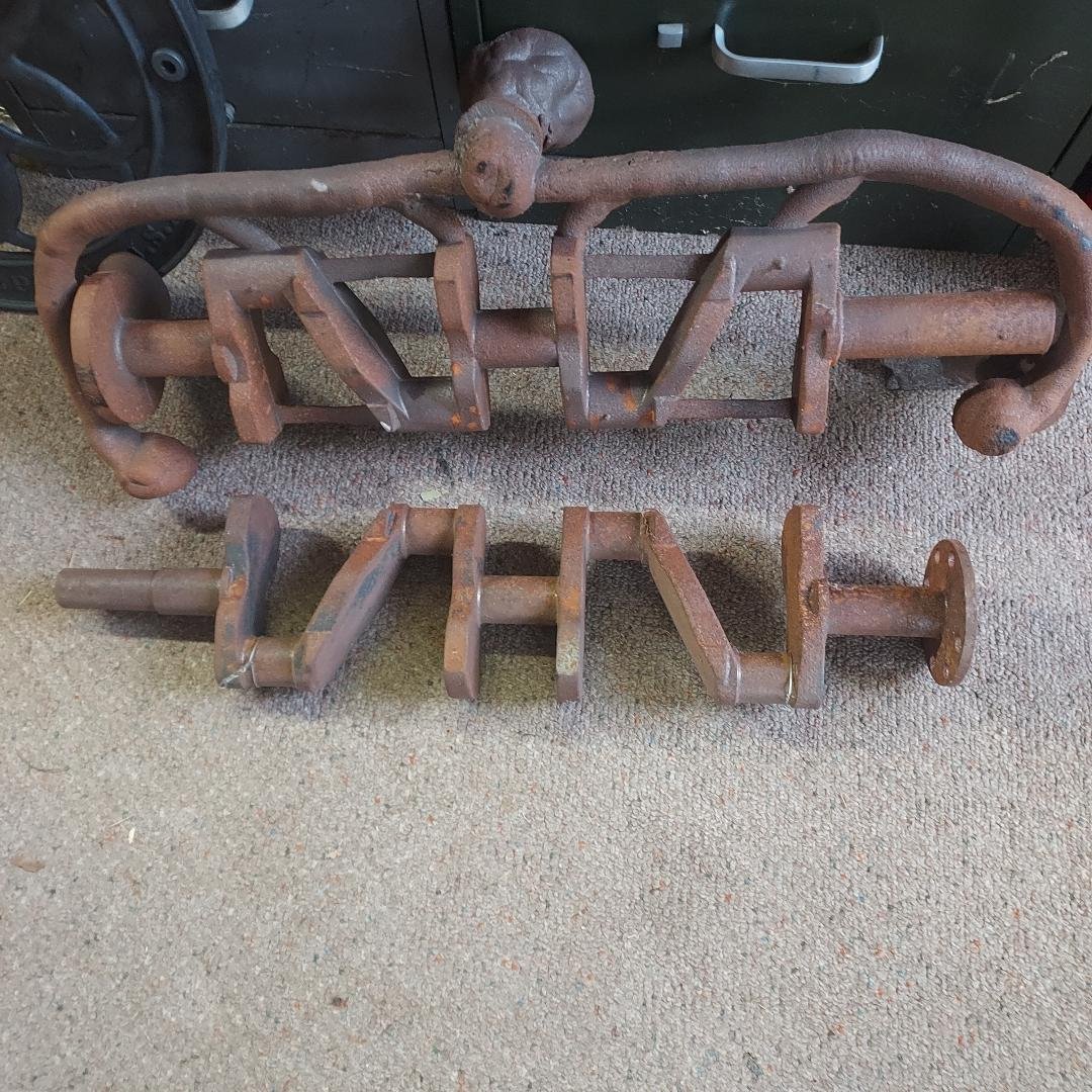

Any ideas on the make of these two? At this time they are wall hangers, so if anyone can shed light on whether or not they are worth the $$ and time to finish them I would appreciate the info.
