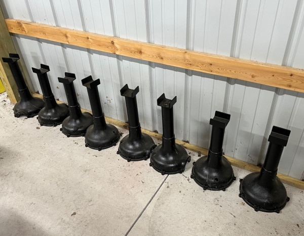

Ed Fuller
- Posts: 895
- First Name: Ed
- Last Name: Fuller
- Location: NJ
- Board Member Since: 2012
Re: Winter storage
I put my T’s on stands over the winter. These work well for me and it only takes a few minutes to jack up the car.
