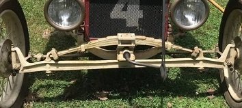

The front has the spring mount reversed I believe, but I may also try a dropped axle. Hoping with that and the brackets with a 2" drop crossmember on the back it will get what I want. But I need to know what the "too close" distance is for the oil plug to ground height.

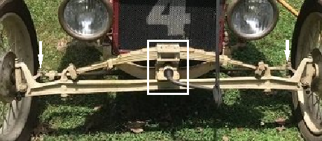

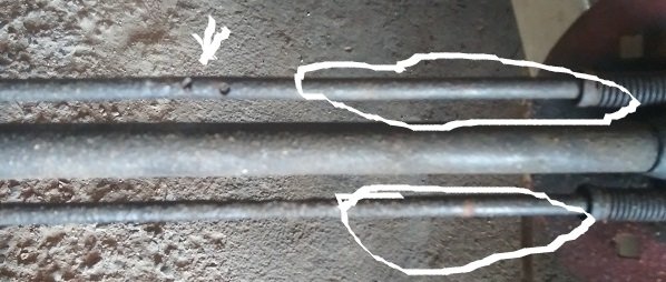

Sorry about the ham-fisted drawings. Are you talking about the 2 holes I pointed out here? (that is supposed to be an arrow)
The 2 rods I circled are a bit worn from past rust pitting and you can see it on the bottom one's edge. I was not sure if they need to be replaced. My car is a "mostly" 1916.
[/quote]
If you can draw circles and arrows, even badly, then you are doing better with computers than I am!
Your spark and throttle lever shafts are not looking too bad. I have seen, and personally run worse. Two small holes for the throttle rod arm also indicates a 1910s era steering column. Ford went to a single small hole in the throttle arm about the same time they switched that "anti-wiggle" piece from two holes to three holes.
I and I am sure others would love to see more photos of your car! Is it a brass radiator 1916, or a later black era 1916? Generally, model year 1916 were only brass radiator cars with the black shell radiator cars being considered 1917 model year cars. However, with speedsters and racing cars that doesn't always follow the factory rules.
That front lowering bracket looks nice. But how was it made? Bent steel? Reinforced? Welded? Where and how?
One of my speedsters, the only true racing car of the five speedsters I had restored and driven, had a similar front end drop. It was bent half inch steel plate and very strong. The front end was very stable and handled great!

"Max" lowering is such that your pan is above your wheel rim. Lower than this you risk tearing apart your motor if you get a flat tire. Your front spring is not inverted, inverting gives you about 3/4 inch. You have later spindles (about an inch), switching to Chevy gives you about another inch. It looks like you may have a later Front spring as well resulting in another inch. Front cross member removal gives you a few but requires engine setback/suicide front end. I'm estimating the drop currently on the car is about 5 looking at front and rear. Alternating removal of some rear springs gives you another inch but can change ride based on body. There is also a reverse eye rear available or bent spring.
