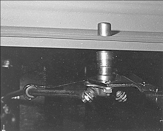

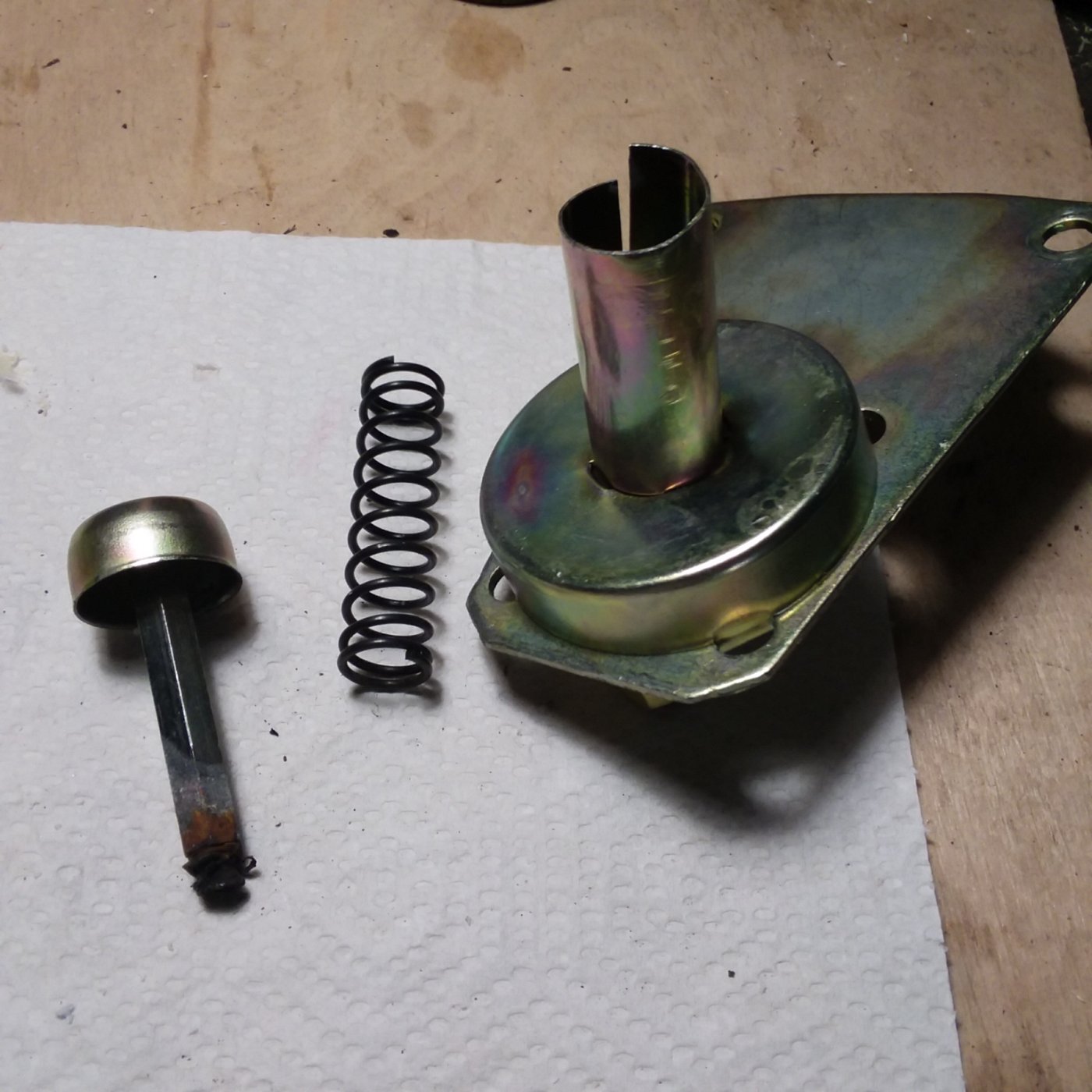

I had a switch fail structurally and short itself out. It actually welded itself on. Very poorly constructed repro crap. Part of why I'm moving on.

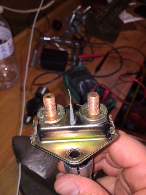

- Posts: 6575
Re: STARTER FOOT SWITCH

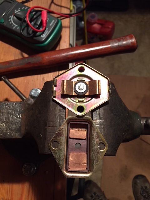

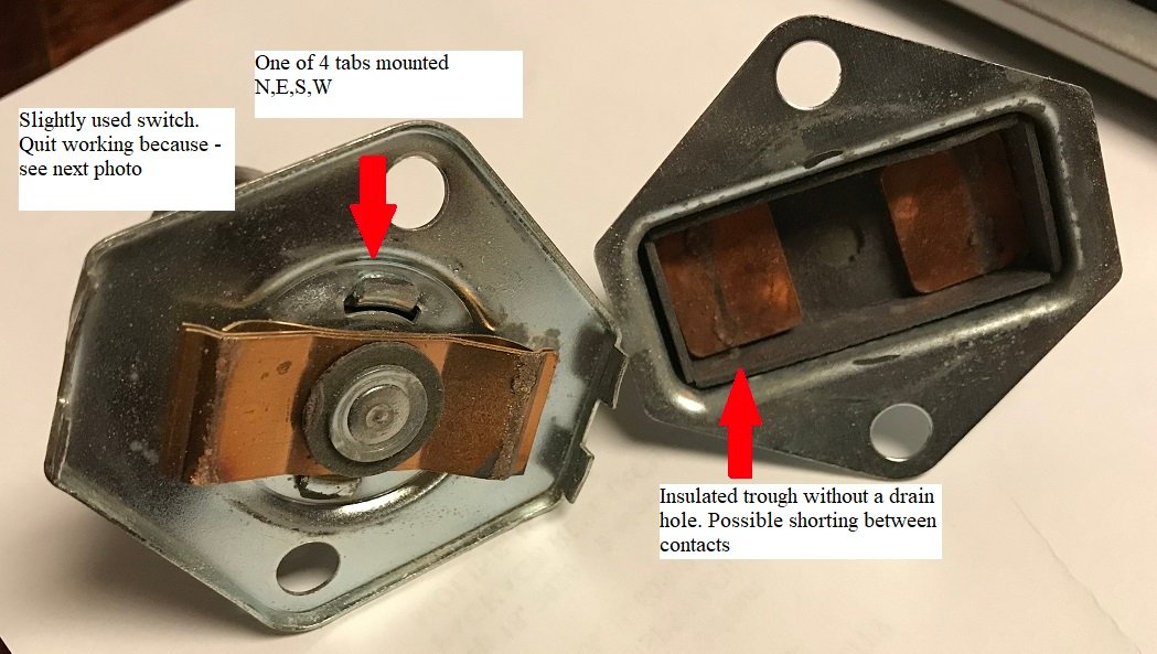

I reported on the construction of these repro switches in 2021 & several others have done so since.
viewtopic.php?f=2&t=18248&p=138840&hili ... ch#p138840
There are two causes for the switch to fail. One is the construction of the switch and the other is in its installation. The installation issue is when the head of the plunger is to high above the floor, note that it shouldn't be more tan the travel distance to make the internals contact. When its to high additional pressure on the plunger will cause the shroud around then plunder to bend around its base, this then puts it on an angle and only one contact is engaged. As a result the driver, out of frustration, applies even more pressure and at sooner or later a short follows
This plunger appears to be too high, given the travel distance needed for the switch contacts to meet.

The trick is, since the top side of the bolt used in the starter switch can't be accessed, you can take a thin cut-off wheel in a die grinder and grind a slot in the stud that keeps spinning. Take a blade screwdriver and insert it in the slot and hold the stud while you tighten the nut. Get it good and tight so it won't twist again. Now, place the battery lead on the stud, a star washer on top of that, and the second nut.
