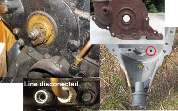

Couldn't find anything about a "Vsure outside oil system" but focused on the use of a hollow bolt. As you can see it does through the timing gear cover on then into the oil pane. Other oilers have attachments that go on the edge of the oil pan.
