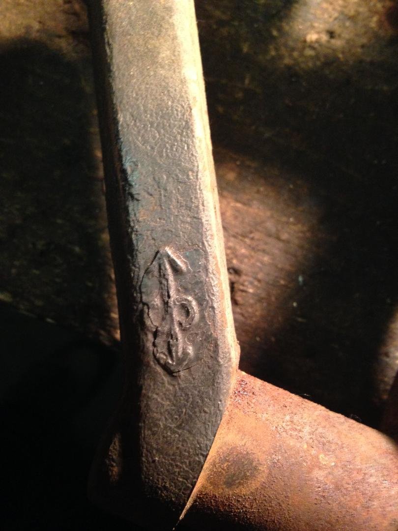

Hi,
Recently, dug this out of the shed.
Included are the markings on a counterbalance crankshaft. Does anyone have an idea who made this?
thanks
Kevin

Shermike. They made 3 versions. Not enough seen to determine which one.

Sure break crank. Hang it on the wall.

I'm sure there is another SureBreak crank that has been running for nearly a hundred years BUT unfortunately one of our club members recently rebuilt his engine not knowing the reputation with a SureBreak crankshaft that had been checked out.
It broke in a very short time of driving! Was a sad learning experience that he didn't know before so he could have made an informed choice.

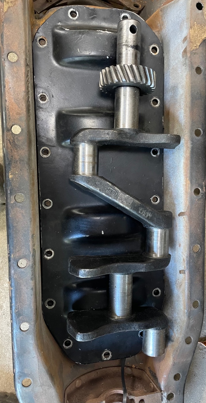

Looks a might short John !!!

Now that one looks pretty nice. it's got some scarring near the front seal and pulley but looks a little short on the back end??
I have a couple of cranks here in the shop with the same problem!

Yep that one left a mark. Approximately How much JB WELD will I need to repair it properly? Jim the 4 attributes should be:

John, How can a person tell them apart? I have two, one in a running engine and a spare. I'd like to know if the spare is one of the better ones.speedytinc wrote: ↑Mon Sep 25, 2023 12:39 pmShermike. They made 3 versions. Not enough seen to determine which one.

years back I checked the metallurgy of them and they where high Cromium in them like the Dodge Bros. cranks.

The difference is the size of the counter weights. I believe the "short" one shown is the best #3. #2 are a smaller dog bone shape. #1 has very little counter weight. This is from research basically looking @ aftermarket adds long ago.ModelTWoods wrote: ↑Wed Sep 27, 2023 11:35 pmJohn, How can a person tell them apart? I have two, one in a running engine and a spare. I'd like to know if the spare is one of the better ones.speedytinc wrote: ↑Mon Sep 25, 2023 12:39 pmShermike. They made 3 versions. Not enough seen to determine which one.
