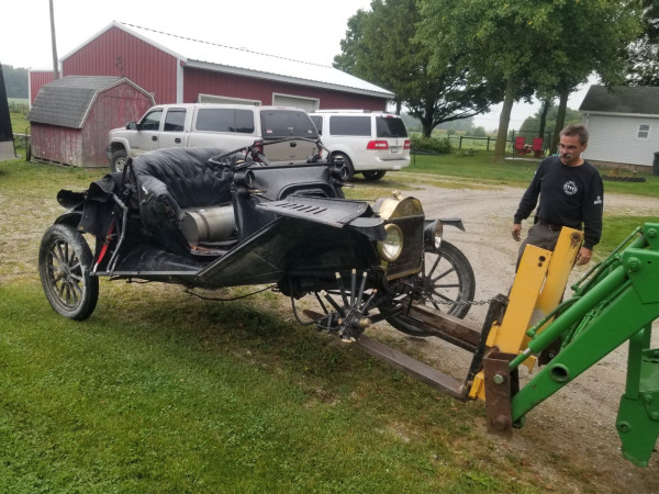

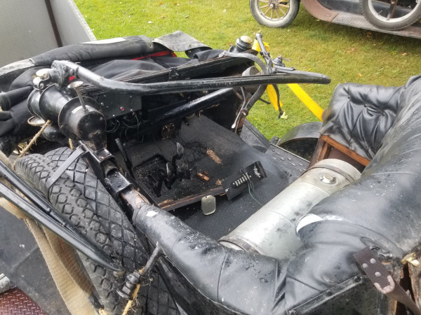

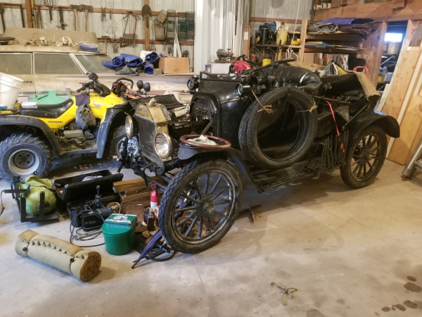

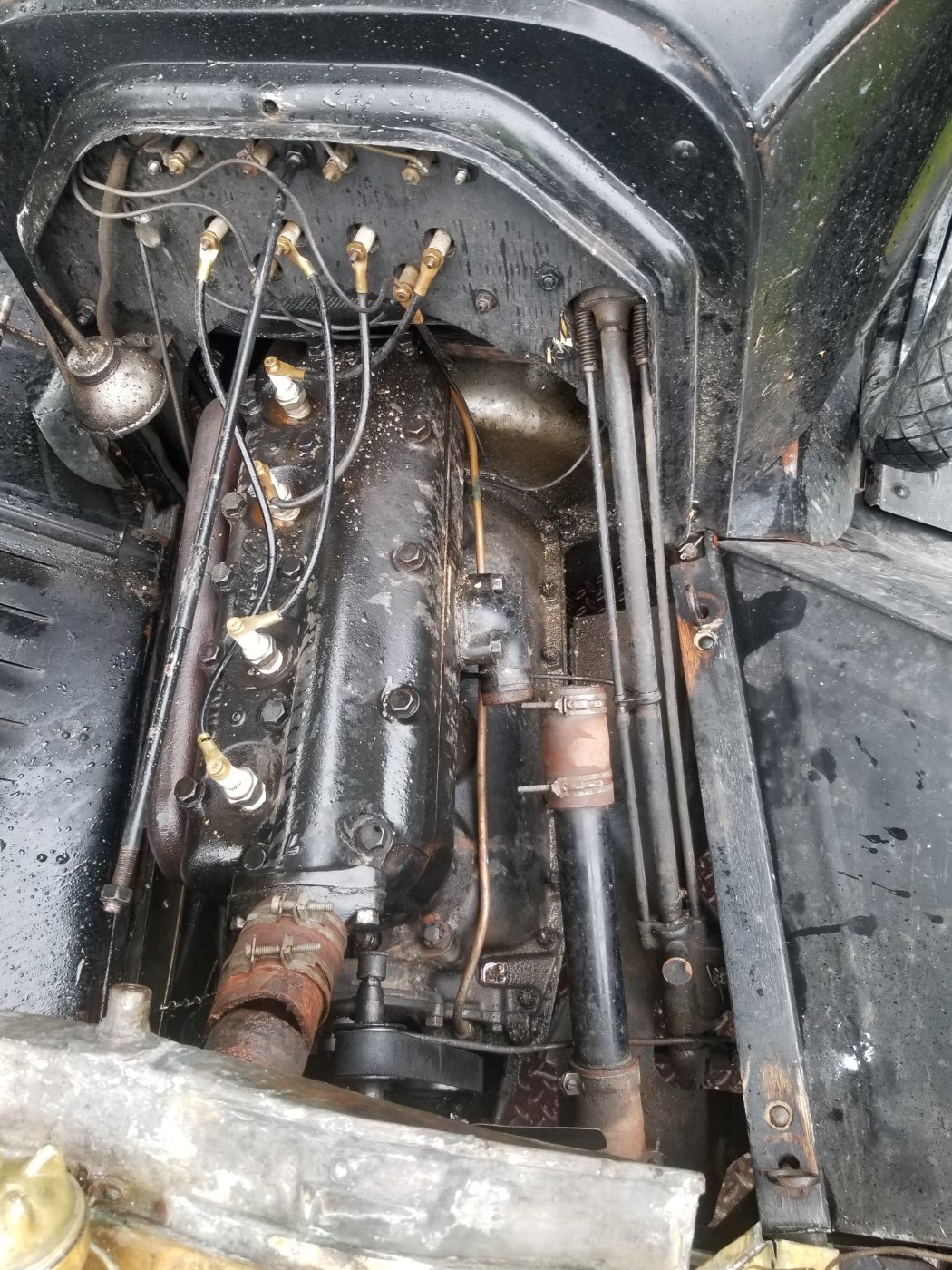

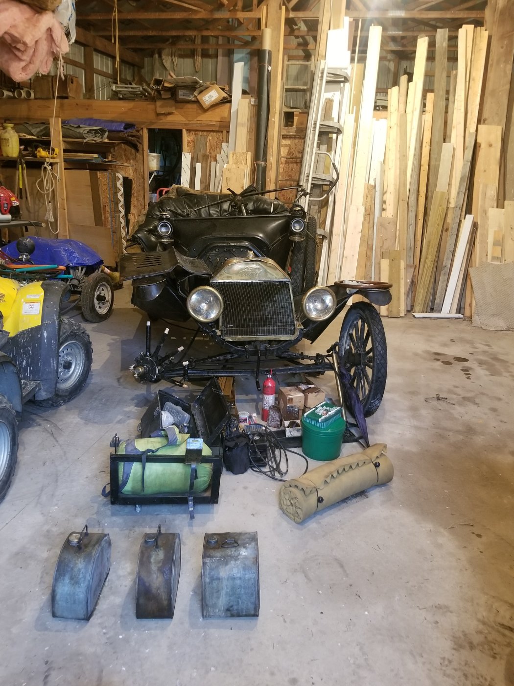

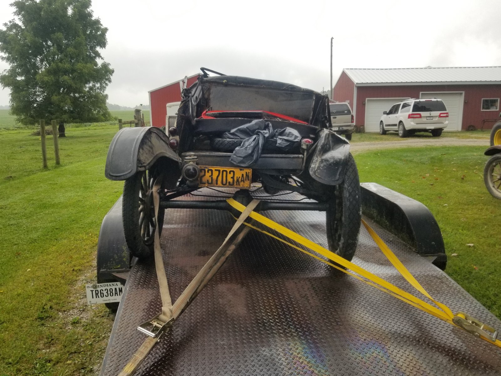

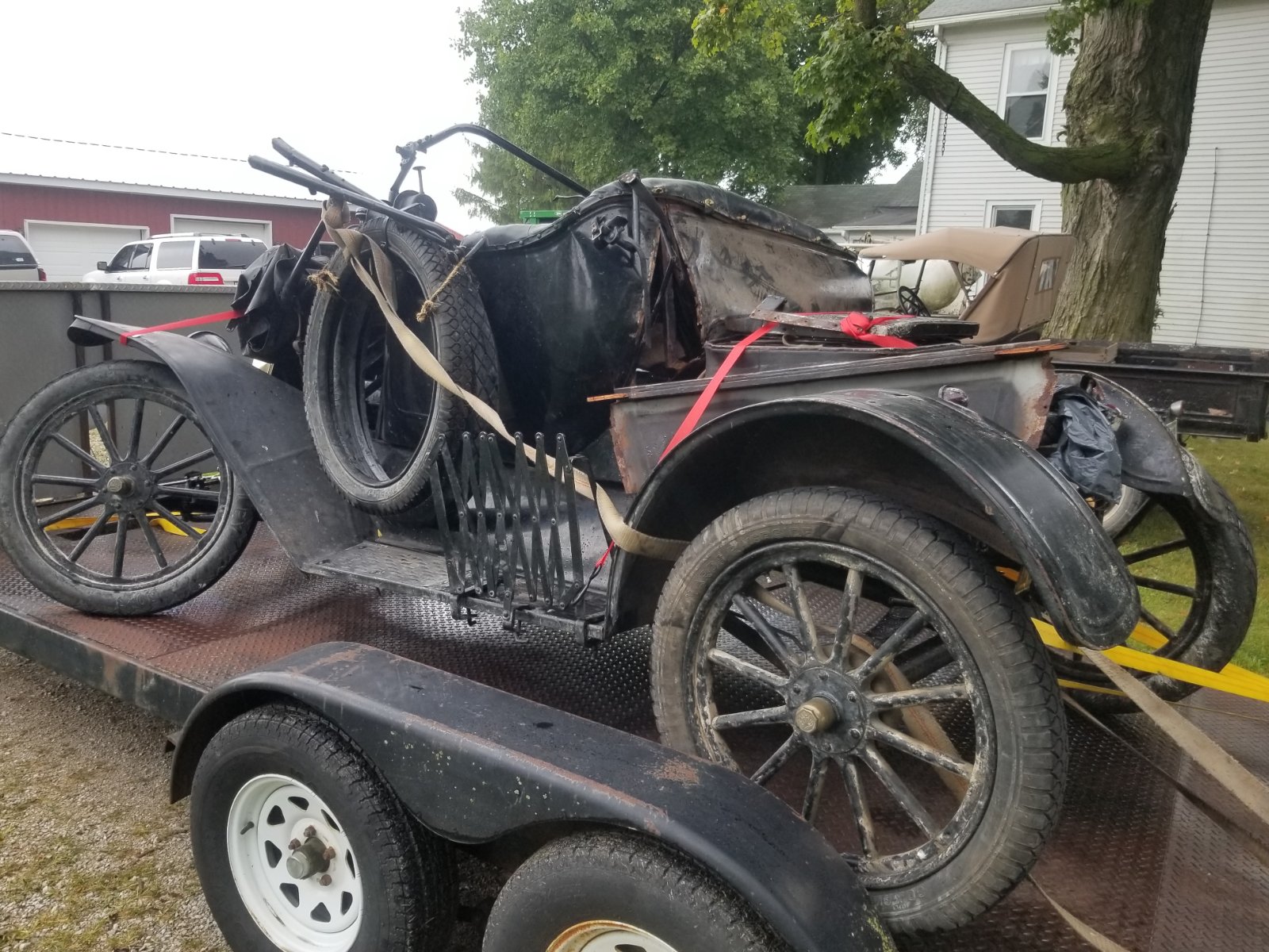

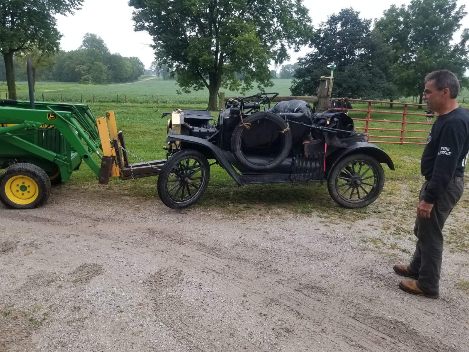

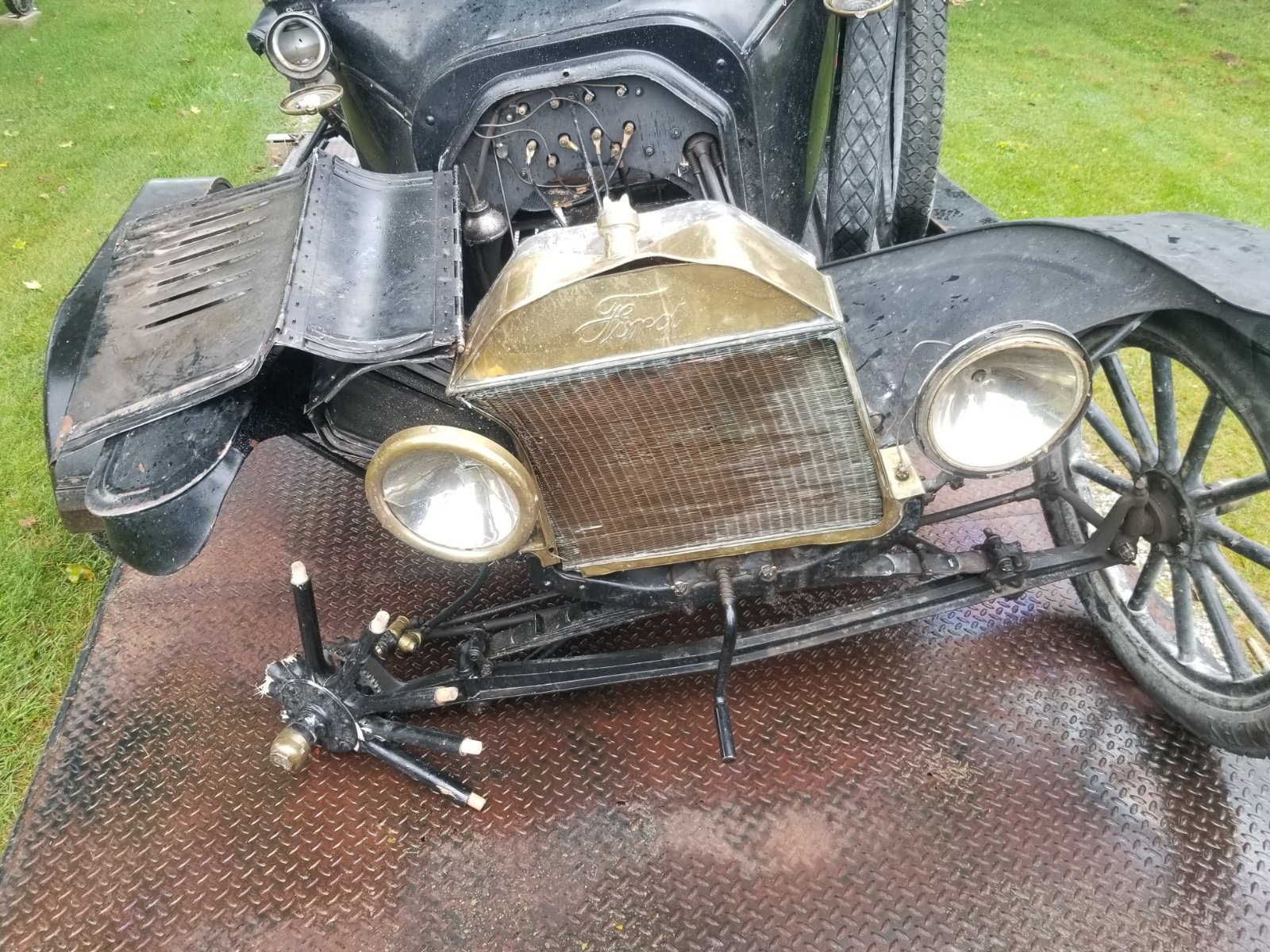

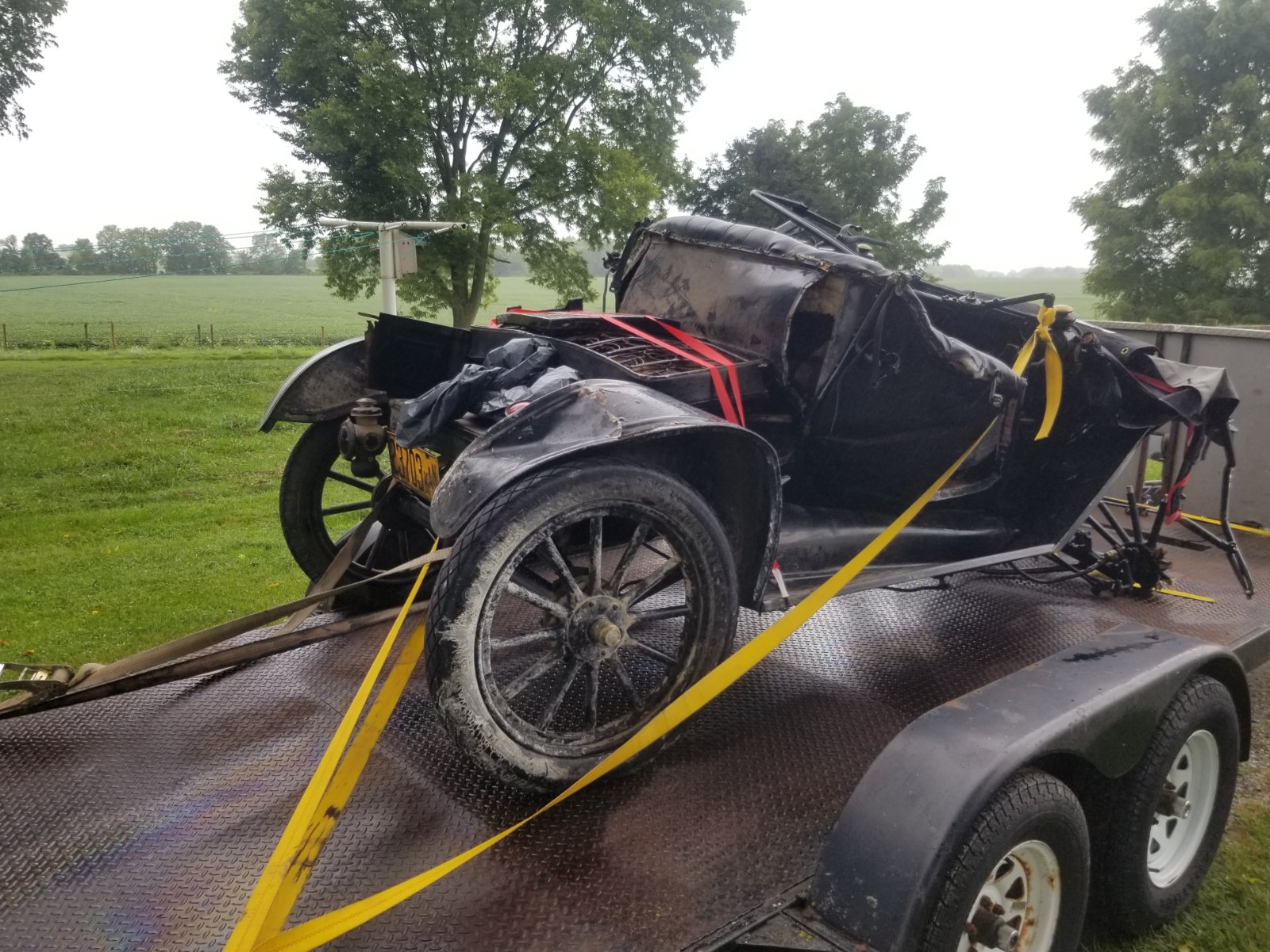

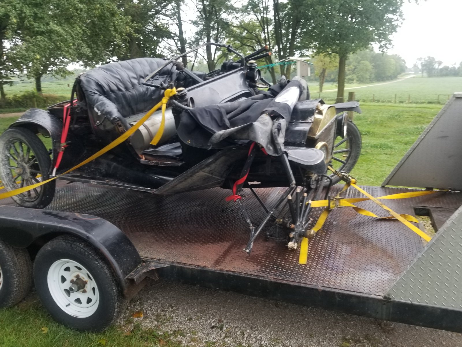

Steve wants to fix his T. I started this post to help find parts needed and show photos of the car at this point. I will take more photos as needed.

It's hard to tell just what needs to be repaired vs what needs to be replaced. If it were mine, I would start with the frame and if all the members are intact without cracks, and the rivets are still in and tight, I would check it for sag in the center and same length diagonally from corner to corner. When that is corrected, I would check the block and transmission for cracks and see if the engine will turn over with the crank. If OK, then I would likewise check the rear axle. I would replace the entire front axle and spring and steering parts, because they are very important to be just right. Then I would inspect very carefully the 3 wheels for cracked spokes or bends. If they are good, then I would either replace the entire front wheel or if all other components are OK, replace the spokes. I would also replace the radiator. Then I would carefully inspect all the sheet metal and top parts and windshield and either do necessary body work or replacement parts. The wood parts of the body should be carefully inspected and either replaced the entire wood frame or at least the broken parts. Then the upholstery and top.
Or the entire car could be replaced with one like it and any good parts left from this one would be saved for spares or sold to the highest bidder.
But it is not mine to choose, nor to even do the inspections or work.

It does take your breath away...Steve's lucky to be alive in my book.

Good comments Mack Jeffrey and Norm. I heartedly agree.I see the LF headlight rim was found and attached. How about the 2 cowl lamp brass rims ? The somewhat rare hood former looks good. How about the turtledeck ? Thanks again Dallas

I'd say find a similar car in unrestored, but restorable condition, and use this on for a parts car.

That is painful to look at. There have been cars found half buried that were resurrected, Steve has a number of options and a lot to work with here. The best part is he appears to be on the path to full recovery.

The door looks pretty whipped and wood work is well...that's a whole different animal. Definitely not in my wheelhouse!

To me that’s a parts car. Get a decent donor and start shifting parts.

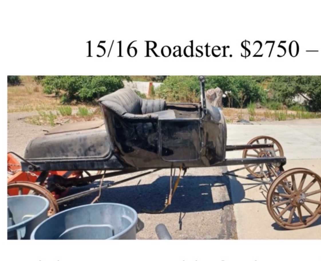

Just something I saw in the Central Coast T’s Sept news letter
The project is owned by Victor Ray Foster in CA.
15/16 Roadster. $2750
This is a project car! Missing parts includes, but are not limited to: top irons, bows. top, splash aprons, 3 fenders, minor engine parts, coil box lid, good rims and upholstery. Included is a rewound magneto coil, a usable brass radiator, a Kingston 15 carburetor needing rebuilding and assembling, and a 15 engine.
It has tapered rear leaf spring implying a 1915 car, but non tapered front springs implying a 1916 car. A trip to Bob's barn
might source usable fenders, splash aprons and other parts.

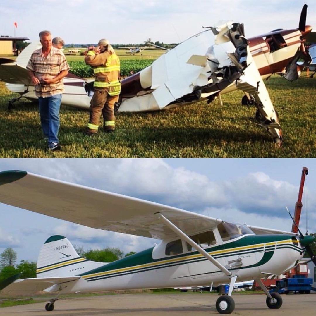

It wasn’t “practical” to repair my 1955 Cessna 170B nine years ago, but I had it done anyway. It was parked at the time, and I wasn’t even there, so my thinking wasn’t clouded by injury. It cost about half again what it would have cost to replace it, but the emotional satisfaction when I flew it away 2-1/2 years later and the 500+ hours I’ve flown it since then has been worth it. My late Dad had found it for me and spent quite a few hours enjoying with me, and I raised my two daughters in it, so any other one just wouldn’t have been the same. Sometimes sentimentality just trumps practicality.
