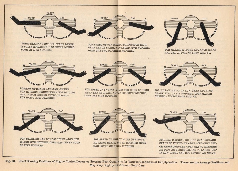

John. Since Bill is new to Model T’s, what lever settings would you recommend to achieve “well above idle”, in order to attain 20 volts for the magneto test? Jim Patrick
