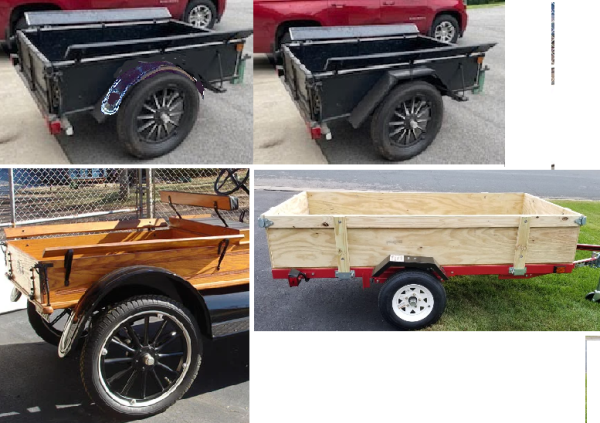

Think it would more "period style" with rounded fenders & Model T Taillights.

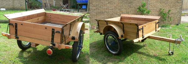

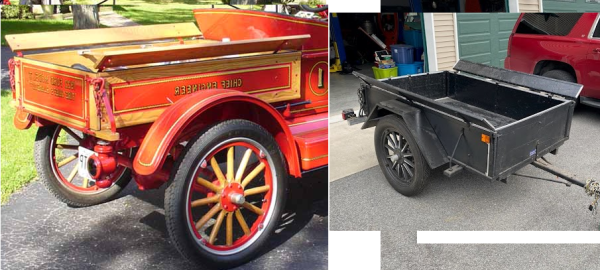

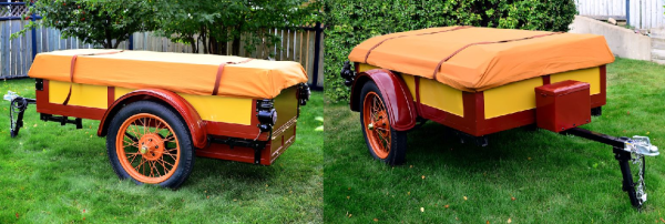

I think rounded fenders make a difference for a vintage look

I agree about the rounded fenders. Also, painting the split rims silver would make it look a lot better. The tires would not look so thick and would look thinner like a Model T’s tires, plus, Model T split rims were almost always painted silver. I use “Silver Brite” from Sherwin Williams. Since it was developed as a steel shingle roof paint and was developed to withstand the extreme elements. It goes on great with a brush and gives me the brightest, most durable, most reflective silver color of all the silver paints I have ever used. If you get it, be sure to stir it. Do not shake it to mix because it is packed full of aluminum pigment that can cause pressure to build up and the top to pop off, if shaken. Also, at first, it goes on splotchy but levels out to a beautiful uniform silver bright silver color. Jim Patrick
