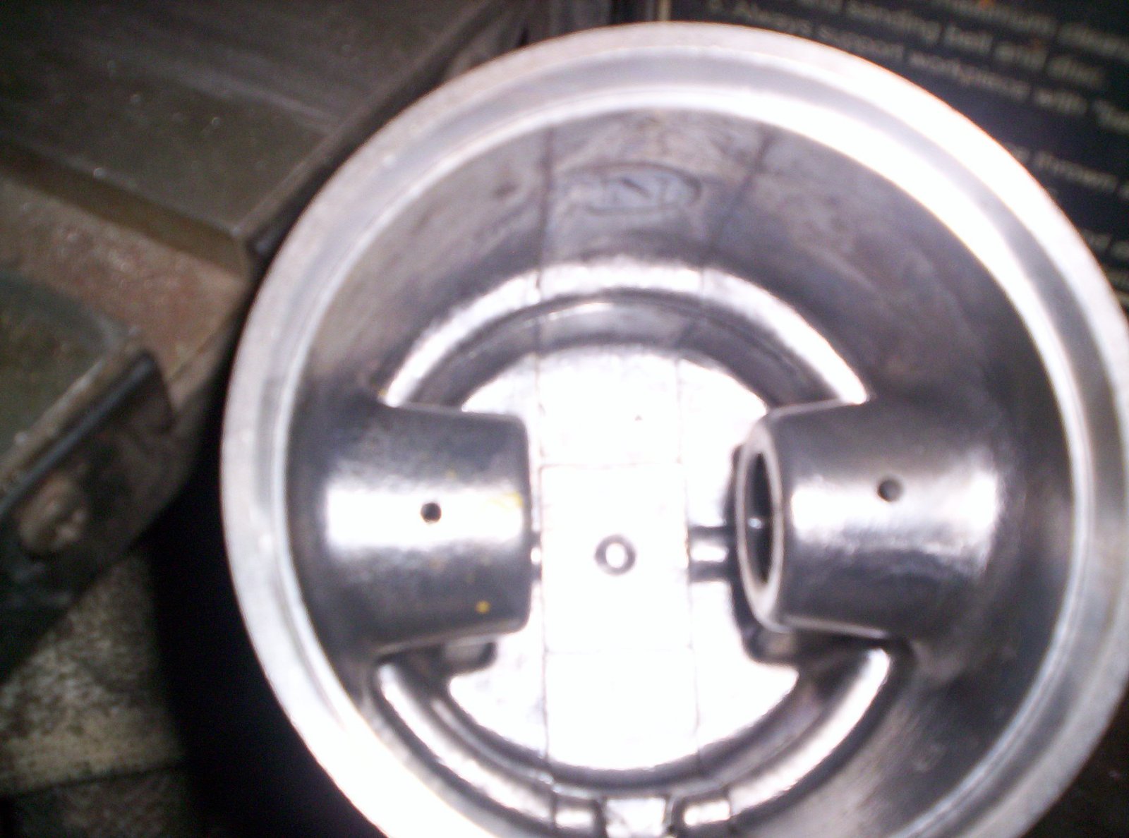

Hello,
i have aluminium pistons which didn't have oil holes drilled for the wrist pin in my 26 Roadster.
Can someone please post a picture with the aluminium piston with the oil holes drilled?
I am interested in the location of the hole, the number of holes and the diameter.
My intention is to drill the holes for the oil.

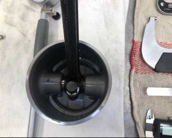

Drill size is 1/8" and go through the bottom and top.
