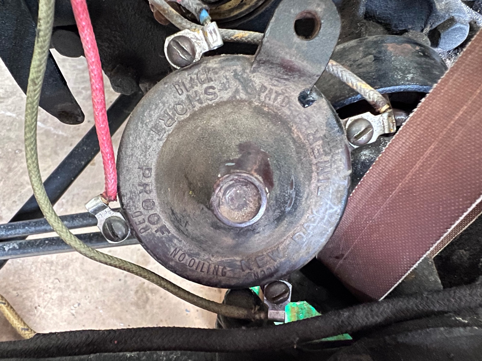

Post by SteveK » Mon Oct 02, 2023 6:48 pm
I’ve been having a blast tinkering with my T. Even have it running well enough to take it around the farm while I work out the bugs. (mostly me figuring out how to safely drive it!). But I have a commutator question; everything I’ve read says oil your commutator but my New Day cover says no oiling🤔. How should I deal with this dilemma?
Thanks in advance!
Steve

The New Day timer was and still is an accessory timer that’s one of the best timers for a T. They have been around for many many years.
The reason for no oiling on the case is because you don’t. Some do and if you want to use a very small amount of thin lubricant. What I do is to use a rag with WD40 and wipe it out clean occasionally. Other than that that’s all you do. And some use none at all and just clean it out .
Originally Ford used a roller timer and lots of people still do. It’s your choice but the New Day is very popular to say the least!
The roller timers need to be oiled fairly often but again some use different types of lube for it
My Father liked New Days and just used a thin coat of Vaseline. I use a thin light coat of STP myself in my 2 T’s with New Day timers. The Ford manuals say to maintain the timer with light oil because Ford used roller timers in the Model T from the factory.

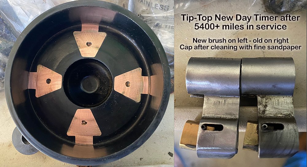

I use a New Day and have never oiled it. Occasional cleaning is all. The Montana 500 racers often cut a circular block of wood to fit in the cap, mount it to a drill and scuff the contacts with very fine sandpaper.
This is what my cap and brush looked like after 5400+ miles.

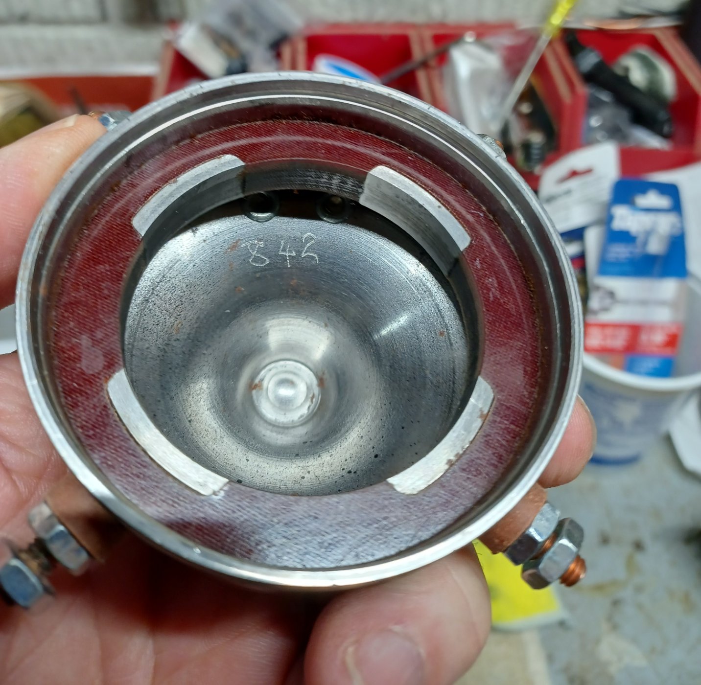

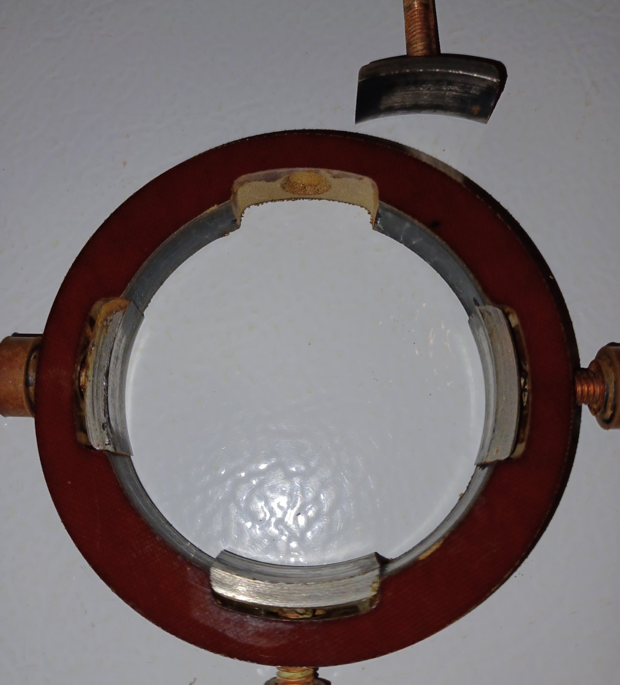

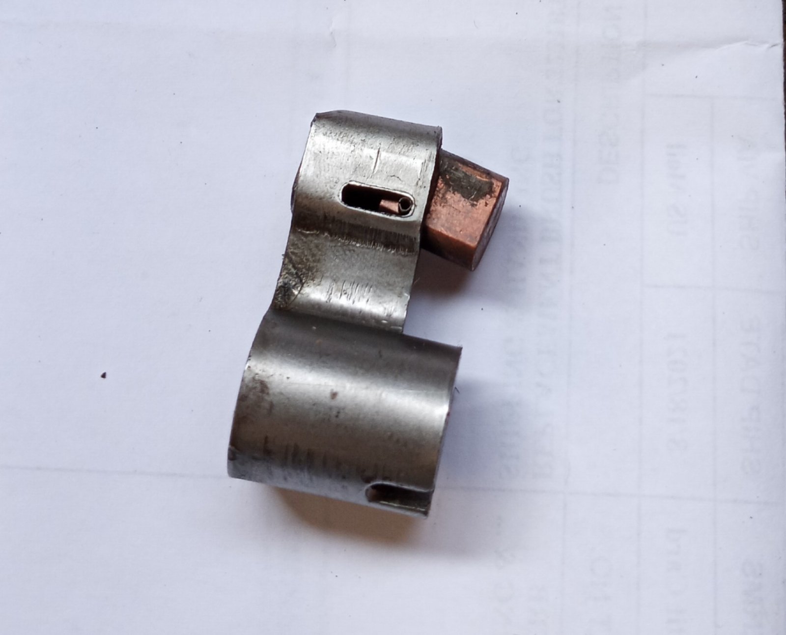

Well I tried the latest and greatest version of the N.D. on my Fordor and after 250 miles I tossed it out it was so bad. I found another TW timer even after Tony Wiltshires unfortunate passing. RIP Tony. IT is by far the best running timer hands down. Needs NO oiling, I just clean it every oil change. A brush usually lasts me around 4,000+ miles. Far better than any roller timer.

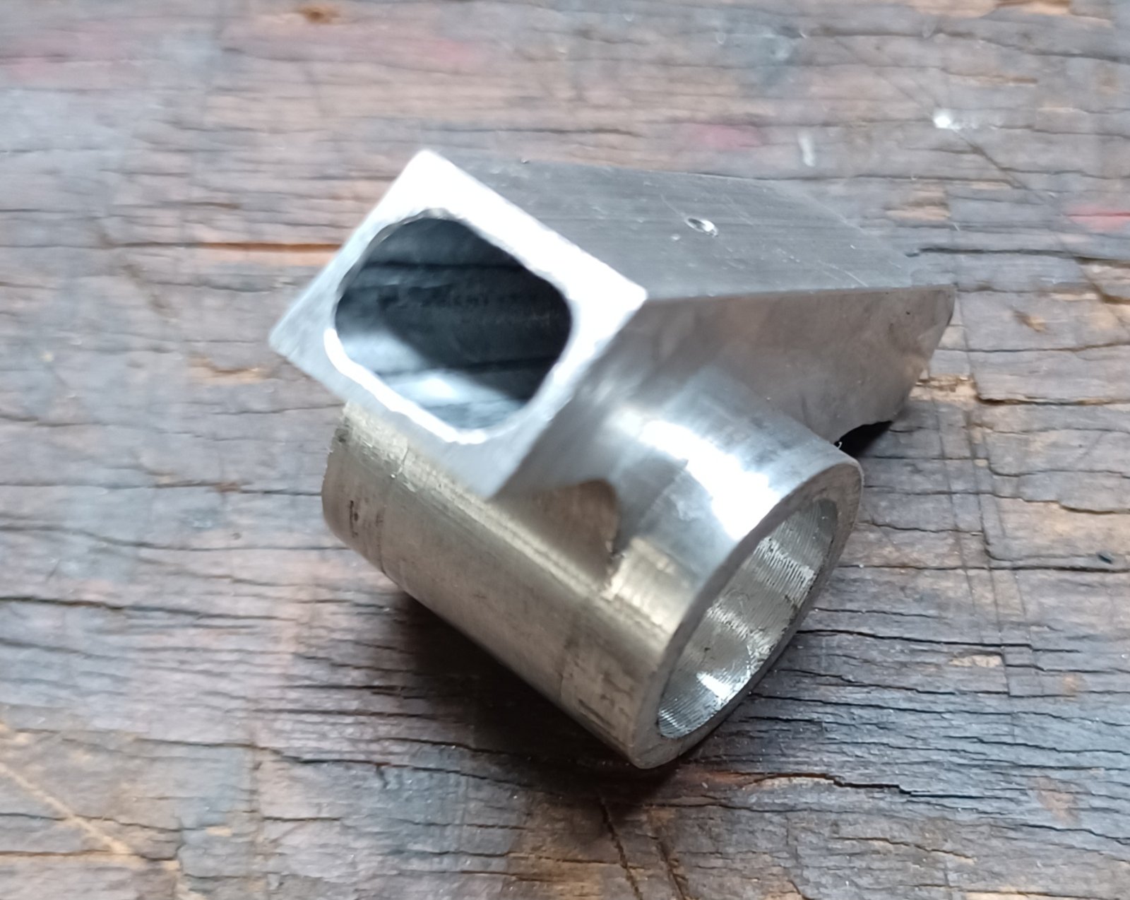

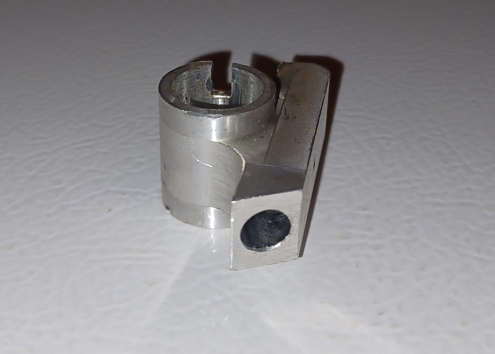

This is why I've been "resurrecting" this fantastic timer piece by piece. Currently ready to have a run of 12+ of the old style rectangular brush and do have a few round brush rotors but no more brushes until I get enough interest for another run of the minimum 12.
I'm even working on getting replacement "contact rings" in the event someone needs one. They do seem to last forever.
As they say just my two cents, I understand the faithful followers of the New Day and to each his own! But I had lots of problems with a seemingly "floppy brush".

Glad yours looked like that Tim, Lord knows mine didn't make it much past 250 miles, yes, not a typo...250, not 2500! Wish I had a pic of it, I think the piece of junk is somewhere around here, if I find it I'll try to shoot one out.

Tim,
I bought my Timer cap and brush from Tip-Top in Spokane Valley, WA. At around 5400 miles I had to have my transmission rebuilt so on a whim I replaced the timer too....wish I'd left it on to see how far I could run it. As it is, I have 3700 miles on it's replacement.
I've had others report experiences similar to yours and am trying to get my hands on some "bad" New Days to see if I can figure out what's going on. I know there are still some bad Caps floating around that are made of soft plastic with an "S" stamped on them but that can't be the whole problem. I'm told Snyder's makes their own brushes which are probably the ones available from them and Lang's. I'm not sure if there is more than one entity making caps. Last time I bought a spare timer from Tip-Top I paid $60 before shipping.
I am open-minded and accept that others have not had my experience with New Day timers. However, from my scientific background I also believe the statement "Nothing happens without a reason." If the timers are failing there must be an explanation and I'm curious to know.
Meanwhile, it looks like you're involved in a worthy project and I wish you luck. Keep us posted on your progress.

The New Day brush I bought separately from Lang’s to replace my worn out original wasn’t as floppy as the one that’s pictured. It’s working OK. Maybe another supplier is making just the brush?
