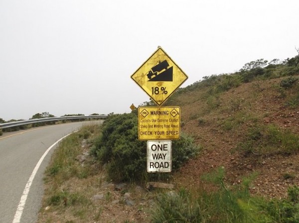

Is this 18% grade too steep for a Model T to descend down?
Topic author - Posts: 614
- Joined: Tue Apr 16, 2019 9:18 pm
- Last Name: California
- * REQUIRED* Type and Year of Model Ts owned: 1911 Touring, 1926 Pick Up, 1924 PACO Bodied Speedster
- Location: West Coast
Hello fellow Model T-ers,
As many of you know, I am hosting the Golden Gate and Alexander Valley Tours June 3rd thru June 10th.
I would like to include a one mile loop segment out over the Golden Gate and Pacific Ocean but am uncertain as to whether or not an 18% grade is too steep for a Model T to descend down. This thin stretch of asphalt road has been recently repaved and is in perfect condition. Only parts of it have an 18% grade. However, it is only one car wide (a one-way single lane) with zero shoulder on either side. Our tour would be the only traffic here on this Monday afternoon. You can view this beautifully spectacular, yet ominous, stretch on Youtube. Here's the link. https://www.youtube.com/watch?v=SjRCHcmmfos
What do you guys think? Should I include it on my 'day one' Marin Headlands tour or avoid it altogether and choose a flatter way?
I would appreciate your advice.
By the way; We still have 2 spots available on these tours.

Re: Is this 18% grade too steep for a Model T to descend down?
Steven
Have you driven your T down it? How did you like driving your T down it? How much T touring have you done?
I consider these important questions.
On the video the hill doesn’t look like 18%,but that can be deceptive

It’s no hill for a climber. Right Larry?? I have been down 18%+ dirt roads in Cajon Pass a couple of times in my 16 touring. It felt like I was standing on the floorboards. Lo gear and low gear KC Warford. Enough to pucker a$$ h...e but it was fun at the time. Don

Going down the hill is one thing if your the only one on the road. It’s a whole different story when there is other people on the road with bikes or anything else. I’m for one having fun in old cars but not at the risk of getting killed in one.

I would not go down it. You may Have an all restored t with lots of new repo parts but you also have parts that are 100 years old and any one of them could let go at any time especially under a strain and that could put you over the guard rail or barreling down the hill like a rocket. I have never been on a tour but I believe they are meant to enjoy , not to stress you out about an overly steep downgrade with curves or put you in danger.

We had a pretty decent downgrade on this years endurance run. I believe it was about 2300 foot drop in 3 miles single lane dirt with no guard rail. To my knowledge all the speedsters went down just fine. I drove as I often have, engine off ruckstel low alternating between bands/rock to bring to a near stop and then coast again allowing the engine to do most of the braking.

That run represents an average 14% grade if I did the math right. Good on ya, Chad !!
