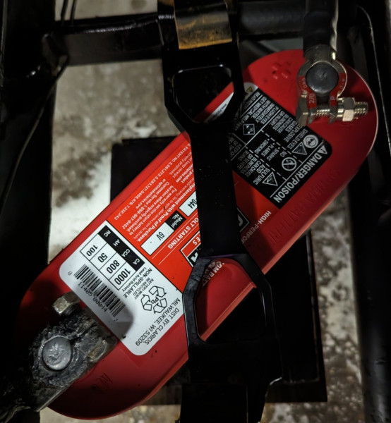

Replace with 6v Optima, will out perform an 8v and last longer than any other 6v battery.

For the 6 volt Optima battery , I used two battery boards underneath to support and lift battery in the carrier, 2/0 battery cables ( picture shows old braided negative) , split sections of gas hose , covered battery holding frame, to protect positive cable from grounding out, and got cast metal battery hold down from e-bay to fit and more importantly be retained by original Ford battery clamps. Later modifications to hold down were made to have hold down straight between front and rear clamps, and negative cable was replaced with a 2/0 negative cable.

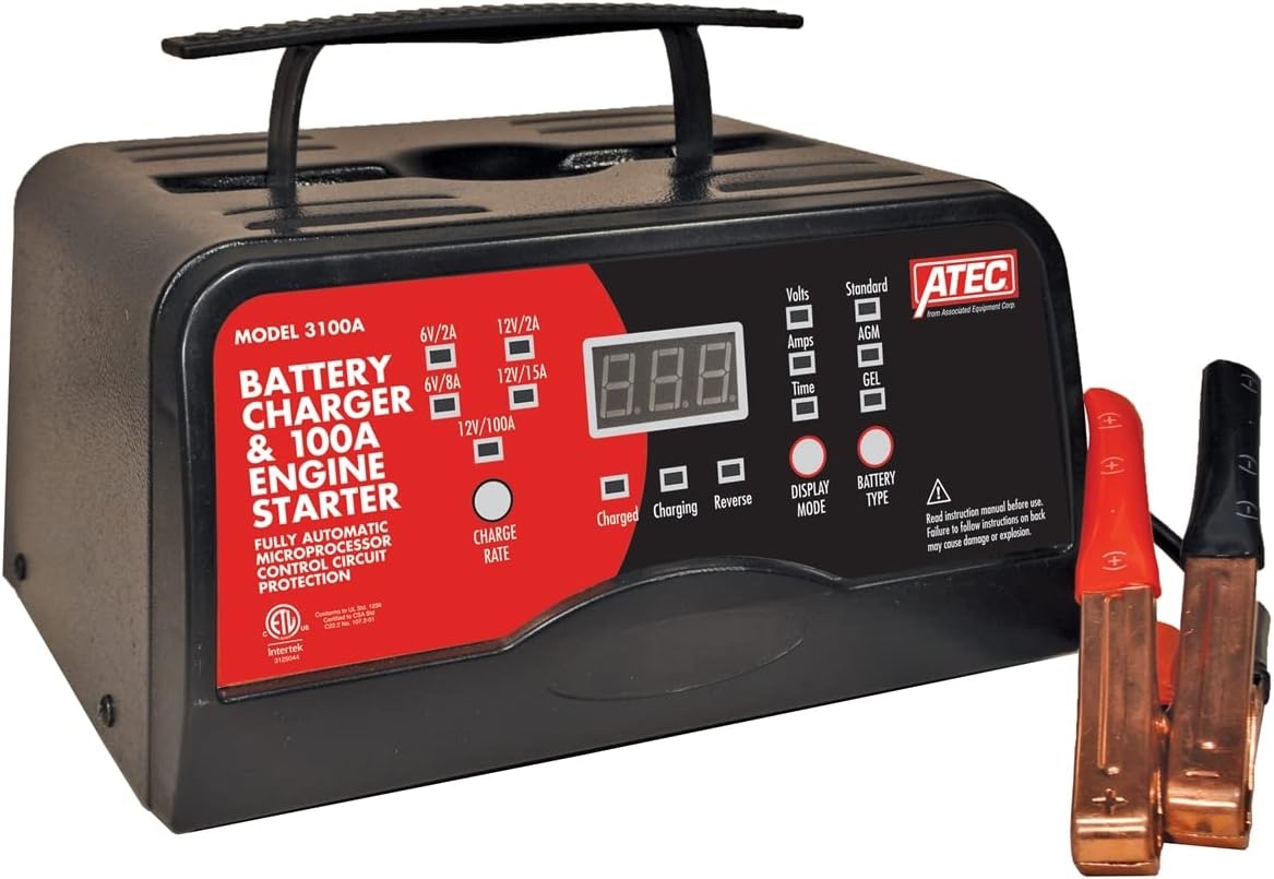

I recently purchased a really nice computerized battery charger that automatically discerns whether you are charging a 6 volt or a 12 volt battery. You don’t need to flick any switches or anything. Just plug it in and connect the clamps to the proper posts and let it do its’ work. Do you think it can discern that it is charging an 8 volt battery and make the necessary adjustments? Jim Patrick
- Posts: 5277
Re: 8 volt battery
No it cant.jiminbartow wrote: ↑Wed Oct 04, 2023 9:46 amI recently purchased a really nice computerized battery charger that automatically discerns whether you are charging a 6 volt or a 12 volt battery. You don’t need to flick any switches or anything. Just plug it in and connect the clamps to the proper posts and let it do its’ work. Do you think it can discern that it is charging an 8 volt battery and make the necessary adjustments? Jim Patrick
There are 8V battery tenders. I finally broke down & got one.
Charging with a 6/12 V charger is a bit tricky. if the battery goes dead, I use the 40 amp 6v charge. It will get to 6.5-7V.
Then use the low amp setting @ 12V for 20-30 minutes, then check.

There is a difference between flooded lead acid (regular)& glass mat (Optima) batteries when it comes to charging them. A glass mat battery
has a greater resitance to charging the lower the charge is. Case in point your conventional battery charger will not charge a dead or very low
Optima it will continualy trip the breaker because of that resistance. If you try to run a low Optima in your T it will work your generator like
a rented mule and may burn it up. That is why there are special chargers for Optimas. The common method of charging a Optima that has a
low charge is to hook it in parallel with flooded lead acid battery and charge both to keep the breaker in the charger from tripping. Don't get
me wrong I like Optima batteries I used two of them for years in my speedster with no generator. Untill the price went up & the quality went

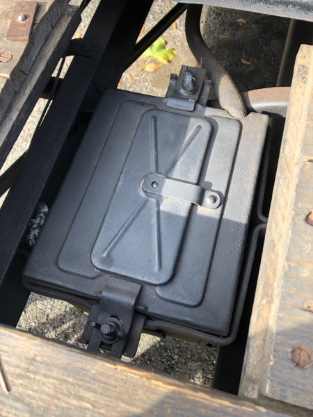

The 801 8 volt battery is the same size as the 6 volt that fits the T battery box.
