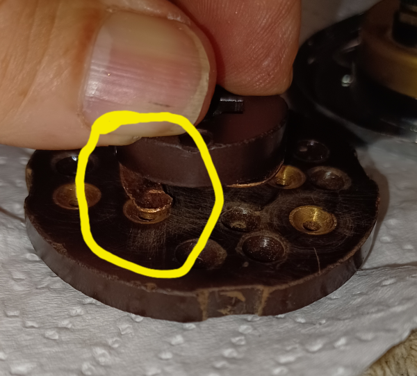

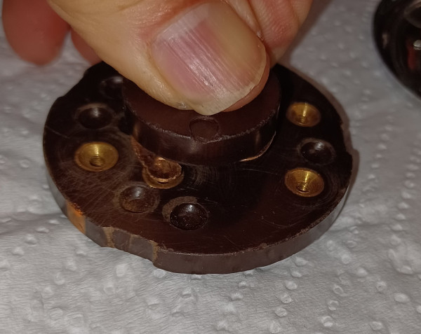

Bill I bet it's your switch. I'm attaching 2 pics..my Fordor runs great on batt, and only on mag for about 2 trips after I open it up and tinker with it. It's a repop. I went back to the original after Cleaning up the contacts and making sure they are "firm". The repop, with the yellow circle, shows how poorly the contact is from the male portion into the little female depression contact. I am sure that's what the problem has been.
Repop switch showing poor contact of mag point..circled in yellow

Original switch showing much better contact of the mag point.

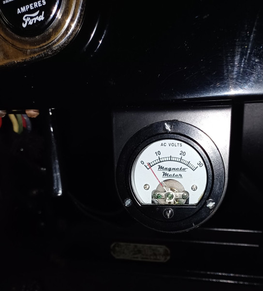

Orrrr...you could put one of these on your car and then you'll always know what your mag is doing! :lol:
