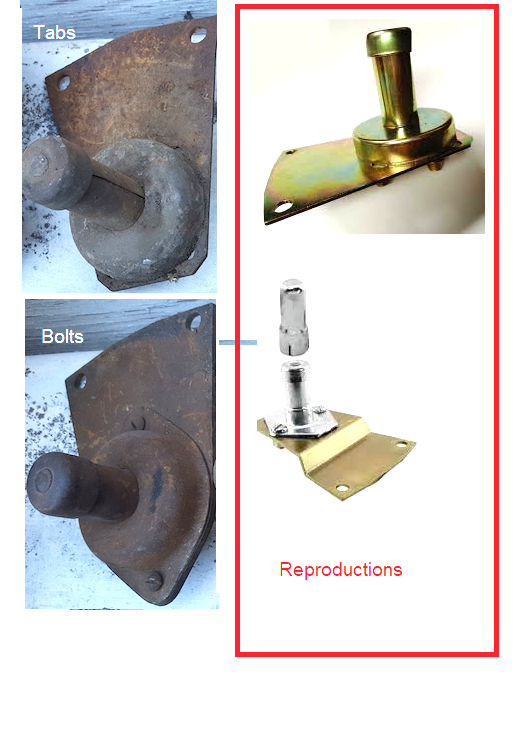

It always helps to include a picture of you problem part. Model T's often have a variety of original parts with slight differences as well as reproduction parts from different time periods.
Examples

Later style starter switch

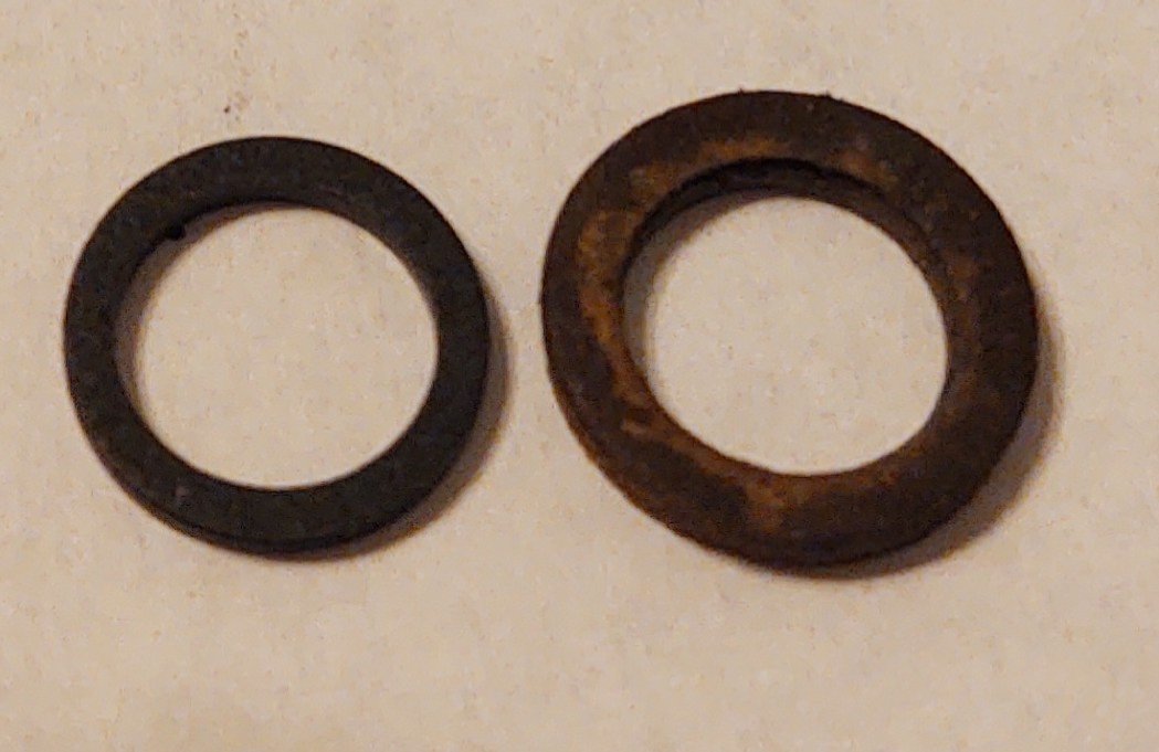

Two different sizes ( outer diameter, same inner diameter ) of fiber insulator that fits into the mounting plate and holds the position of the terminal stud.
