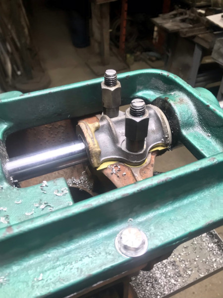

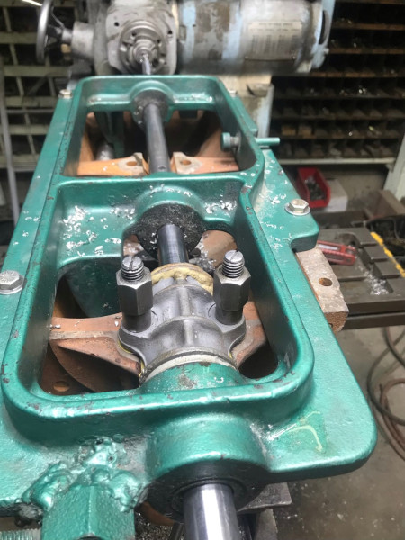

Here’s a job I do sometimes on model T’s and A’s. Both can have issues with the rear cap. Making just one bearing cap takes almost as much time as all three. You have to pour the cap and a dummy block and bore to the size needed. On this job I am making a cap with a bronze thrust on the front end to keep the end play tight. This car had magneto trouble and I am rebuilding the transmission with a ring gear for a starter.

Erik, can you elaborate on how you attached a bronze washer? Was it a half washer that was tinned to attach to babbitt? I seem to recall reading an article somewhere about a brass or bronze thrust attached to the rear bearing. Details are foggy since that was several years ago.

I assume that after the brass is installed new babbitt needs to be pored & bored? would it be easyer to just machine a brass bearing to insert into
the cap & line bore? If the babbitt is good I add babbitt to the thrust surface & machine on the lathe & install. There is many articals on doing
that. So far I have had good luck with that method.

The cap is milled about .100” shorter. The bronze thrust washer is silver brazed to the cap. The melting point of that process is over 1000 degrees. After that the cap is babbitted and line bored.

I make the bronze washers out of cored bronze stock from industrial suppliers. Machine them to size and then slice them off and cut them in half.
