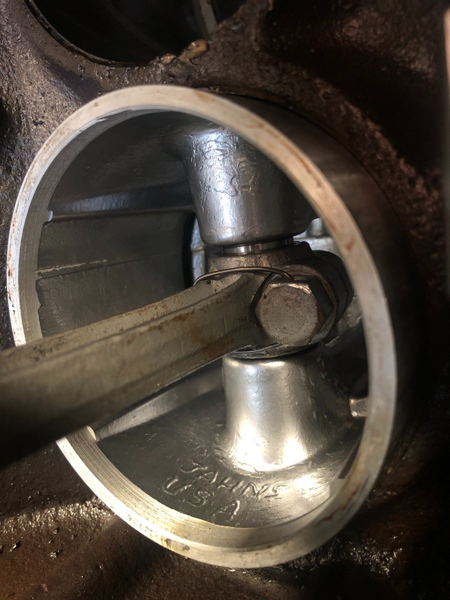

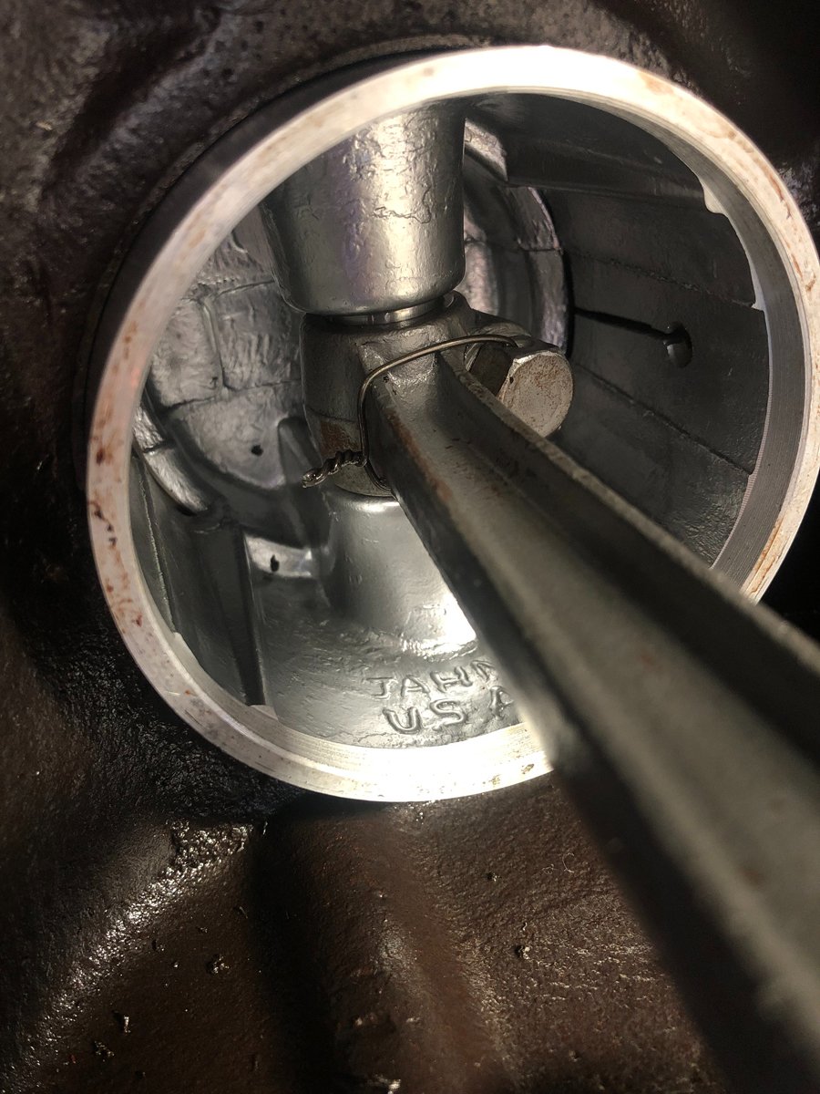

I am going through my 1912 engine that was put together by the previous owner. He appears to have done a good job, but let's just say I am changing some things to suit my "preferences." Looking at the wrist pin setup in these Jahns pistons, I don't see a lubrication hole to catch oil from the splash system to lubricate the wrist pin. (Of course, I am hoping someone will tell me that there is a lubrication hole on the top sides of the wrist pin bosses.) Anyone familiar with Jahns pistons? I am not entirely sure of the age of this rebuild.
I need to get a smaller dental mirror to try and see the top of those bosses. If there is something that looks like a lubrication port, then I will be happy. If no lubrication port, I think there needs to be some. If it comes to that, I will take the pistons to my machine shop so they can do the holes and carefully do any deburring that needs doing. I suppose if worse comes to worse, I can fit new pistons but am hoping not to go that route.
Oh...and the wire through the bolt head, yeah, that will be changed to the proper cotter pin installation. There is already enough wire inside a Model T engine.

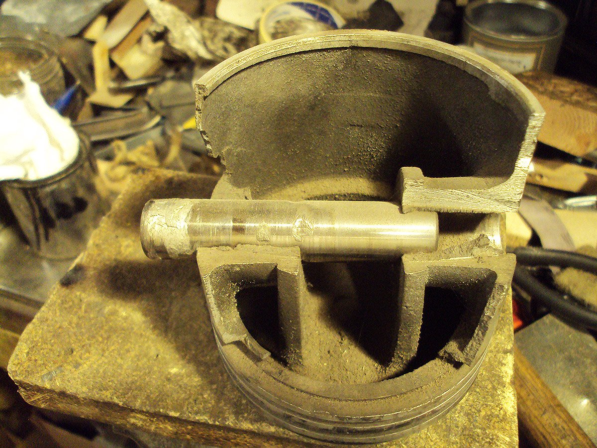

This is the only piston whose pin froze solid enough to seize the engine. I had to saw a chunk out of it to get the pin to move and remove from the rod. It had no oil hole. You can see how the pin bonded to the aluminum.
I don't know if it is a version of the Jahns or not. I have used Jahns for years with no other problem.

Scary stuff, drill the holes, do away with the wire and turn either the rods or the pistons as one or the other is in backwards, ie, the wrist pin lock bolt faces the camshaft and the split skirt faces away from the cam.
