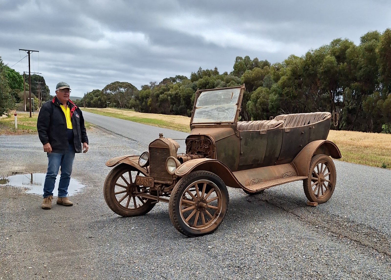

I brought this one home a few days ago.[attachment=0]20231005_105641.jpg[/attachment.
It is a 1922 Adelade built Duncan and Fraser tourer, standard except for full leather upholstery.
I have the job of assessing whether it is worth preserving as is, but making it safe to use. It will depend on how well the motor and trans perform, so the first task is to get it running . It is a fourth generation car to the family, so they would like to preserve it.

I'd be willing to go to some expense to preserve the car as-is, or with some selective refurbishment, given the family history and the fact that so few original builds survive.

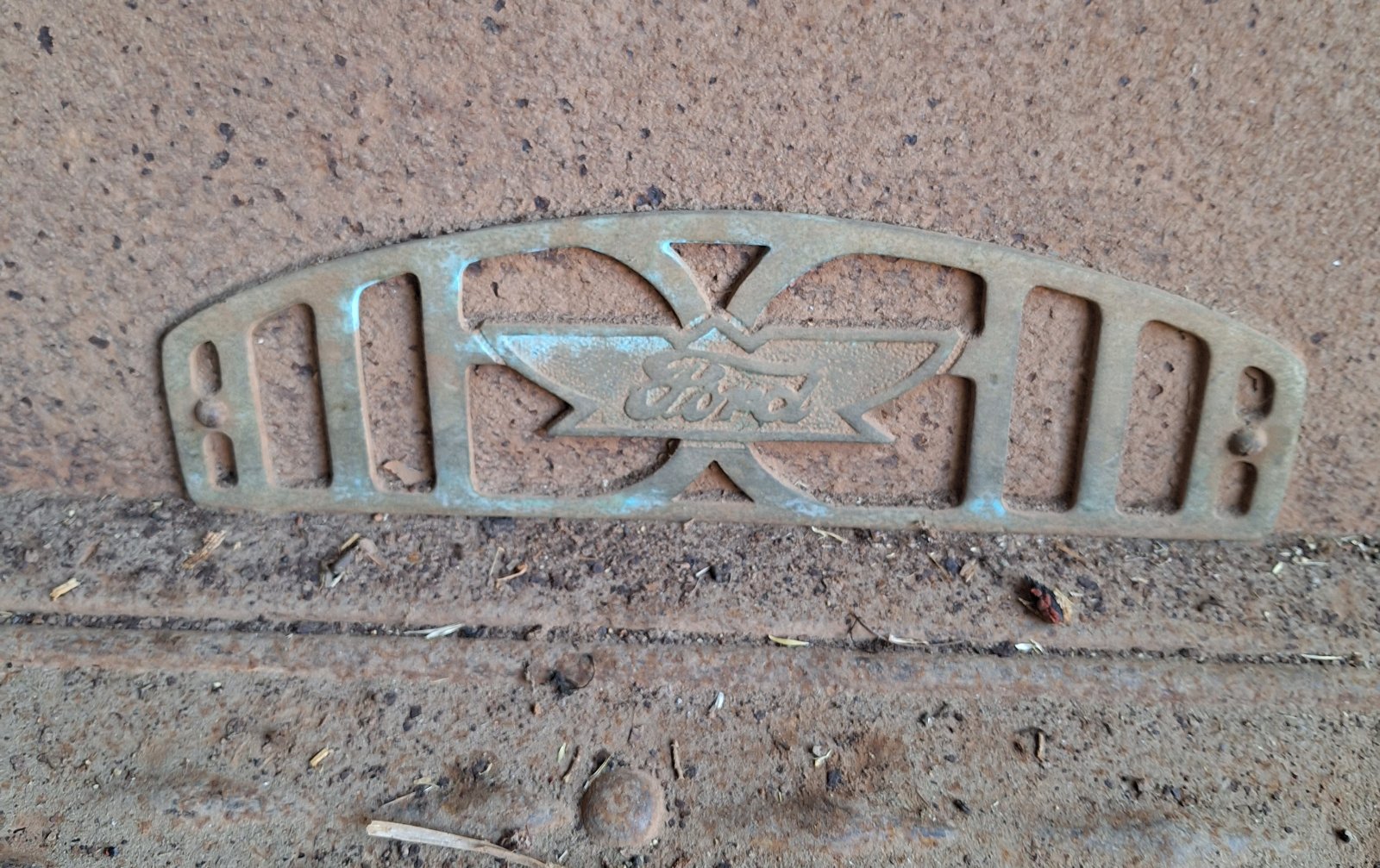

Very interesting barn find Allan. Yes, I’d attempt to preserve it too. Reinvigorate the dried out spokes. Lightly sand the rusty sheet metal and apply a satin preservative. Tell us more about those 2 interesting ‘scuff plates’ on the splash apron.

Looks like a good survivor. Get it to running, check out the transmission bands and try to get it to run. It looks like the wood structure might still be solid enough and stable but you’ll determine that as you get into it. Then there is the radiator and we hope it will still cool.
It’s good to see it’s pretty much kept inside and not left outside and that’s great.

It's gorgeous just the way it is.

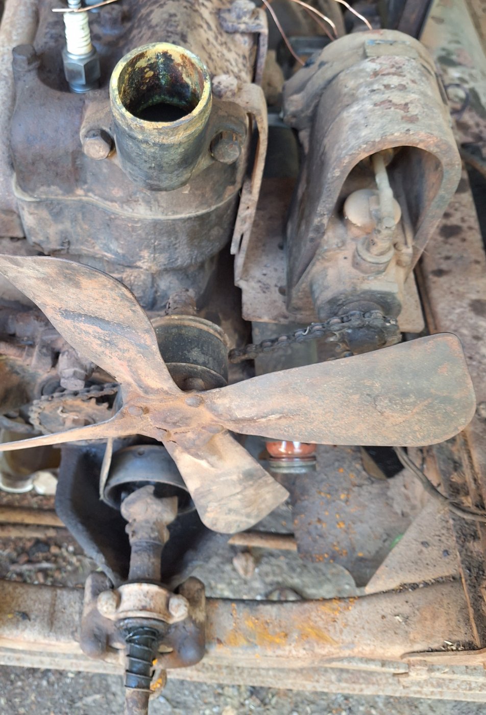

Auxiliary belt driven magneto addition. ?

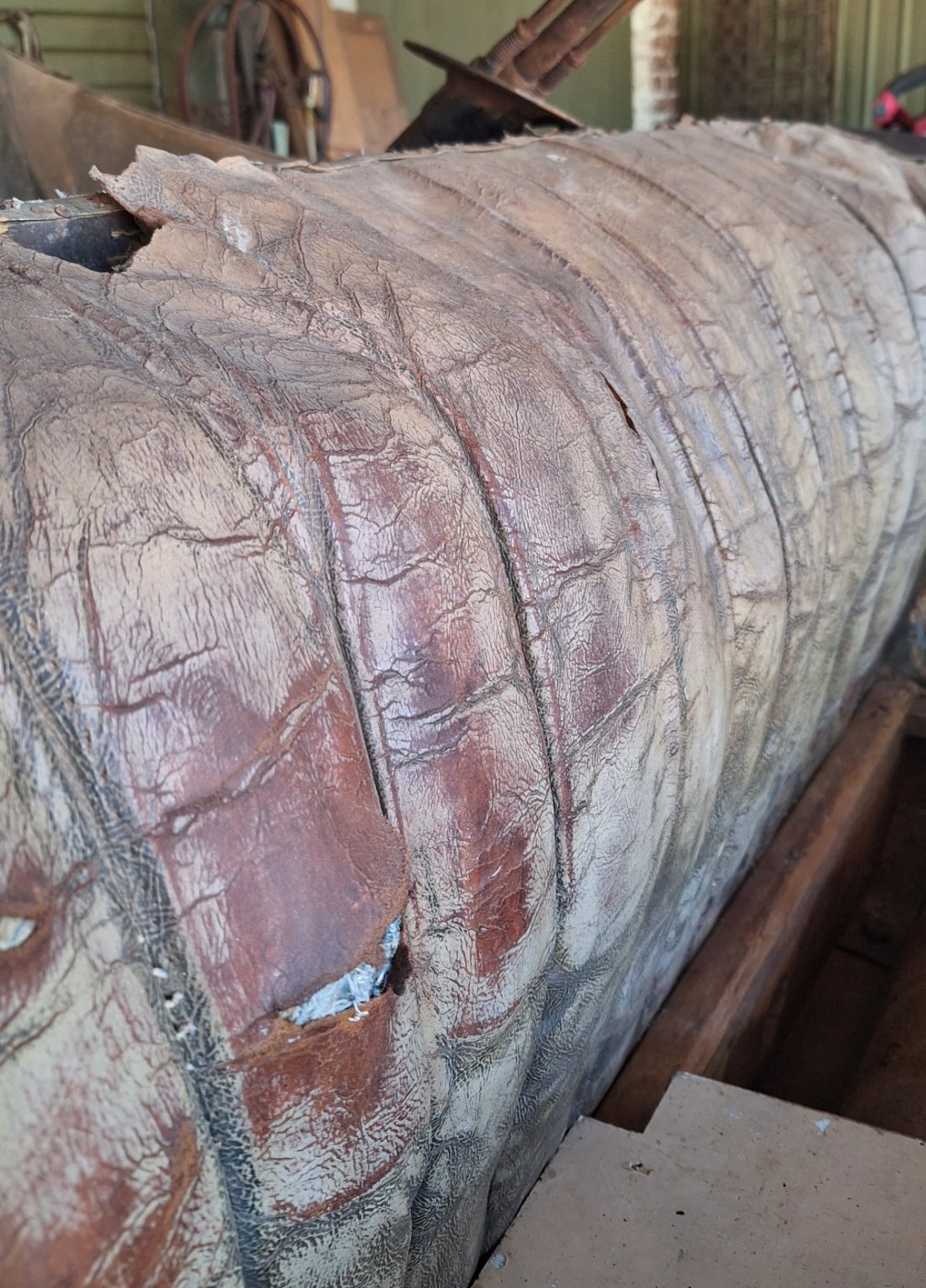

George, the scuff plates are D&F made brass cast accessory. Duncan's had Line of accessories on offer. This car also came with a nickel plated radiator shell, headlight rims and windscreen pillars. It had a Corbin speedo. It has a steering column mounted pair of controls for an extra air intake on the intake manifold and a knob to adjust the mixture. This car was painted dark green, including the fenders and running boards.
It has the original leather upholstery. I have never seen this before in a standard bodied car. The magneto is a farm fit job. It is chain driven. There is no facility to adjust the timing, so it looks like they hand cranked it with the hood up, and reset the timing before driving off. My son fitted a set of temporary plug wires to the magneto, we put fuel in the tank, made good the connections at the carburettor, and he cranked away. It sounded like it wanted to fire up. With a timing adjustment of the magneto, it went on the second pull. We had a mad scramble to shut it down again, as we had forgotten I had removed the starter motor!
Tomorrow night is the due start-up and run check. If all goes well, she will have new Kevlar bands while the firewall is off, and we can start on the refurbishment.

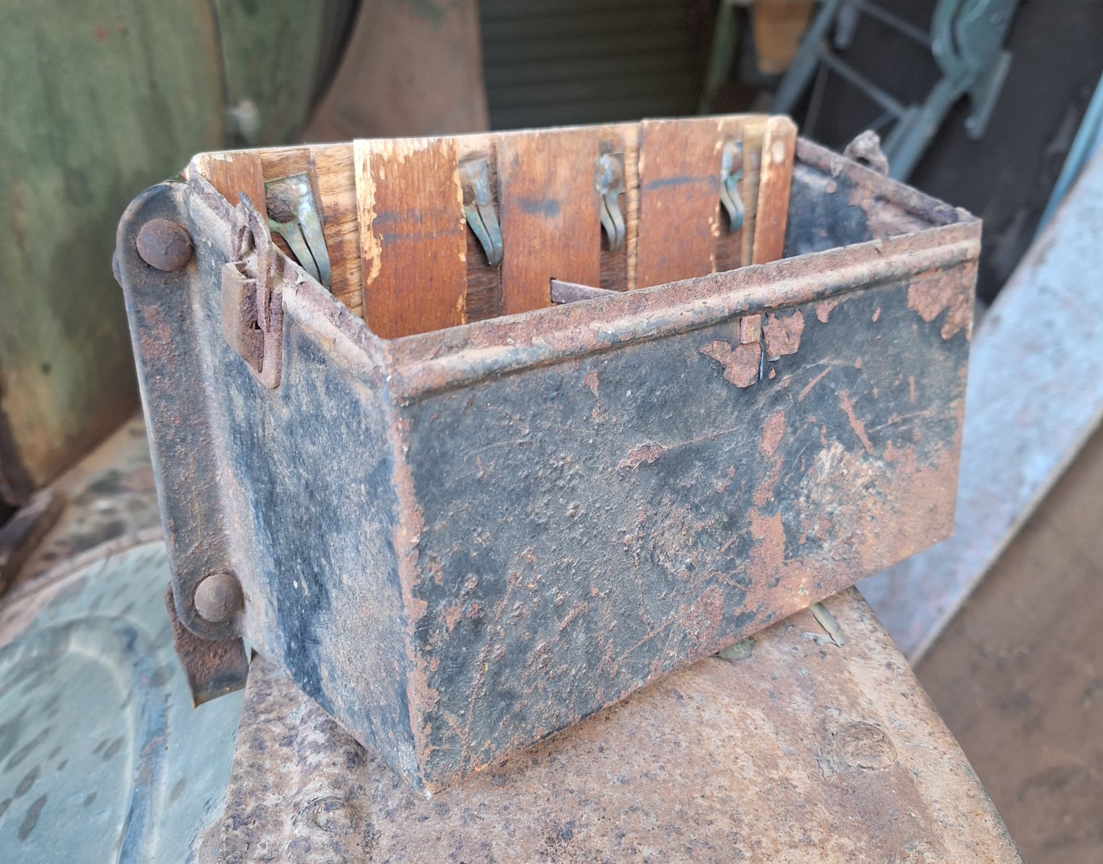

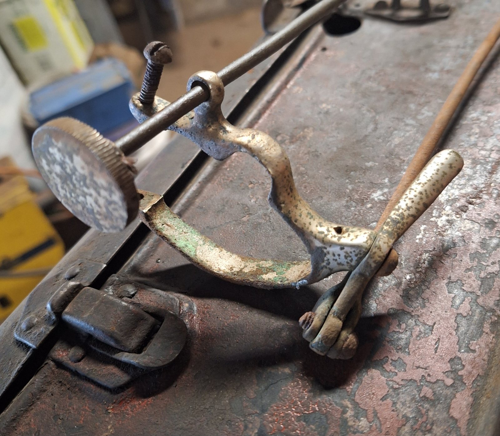

We need a few bits to replace some missing items. I have posted here, rather than the classifieds so you have a better idea of the condition of the bits required.
A couple of no 53 ignition keys.

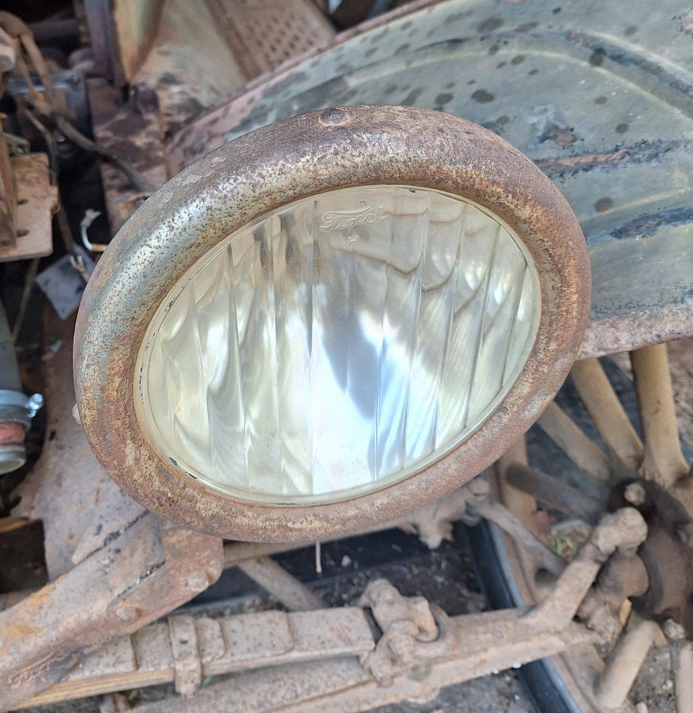

A coilbox lid I similar condition to this coilbox. A headlight rim that was once nickel plated like this. I have a volunteer in Texas who will gather the bits and make up one parcel for me, so local postage applies for any items you may be able to help with.
Please email me if you can help.
I forgot one item. New headlight lenses are out of stock. An original one may be abetted option anyway, if anyone has a spare.
