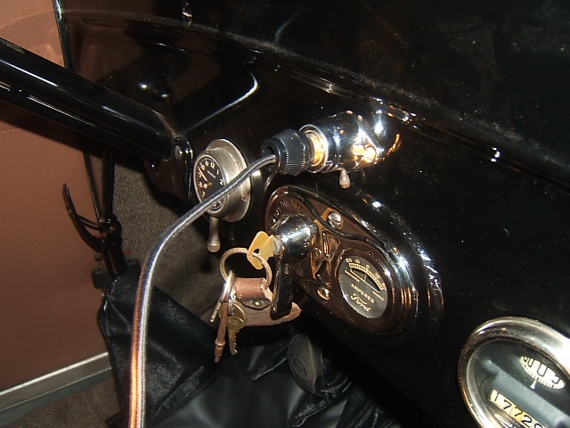

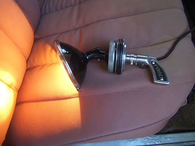

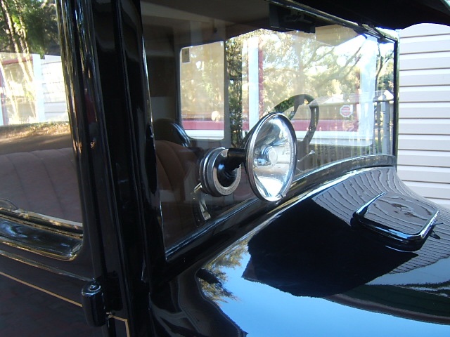

Can you post a picture of your accessory? My Fyrac, through the windshield spotlight, came with a bayonet plug that plugs into the dash light of my ‘26 coupe and could be turned on and off with the dash light switch. Might be a simple way to consider. Just like with my spotlight, you won’t be using your spotlight all the time so it can be unplugged until needed allowing the dash light to be used for its’ intended purpose. Jim Patrick.

Thank you for the suggestions to attach to the dash light, it is a great way to attach and disconnect as the light is needed. Our light does not move off of the mounting and will tilt or swivel only. Your light is more versatile than ours.
