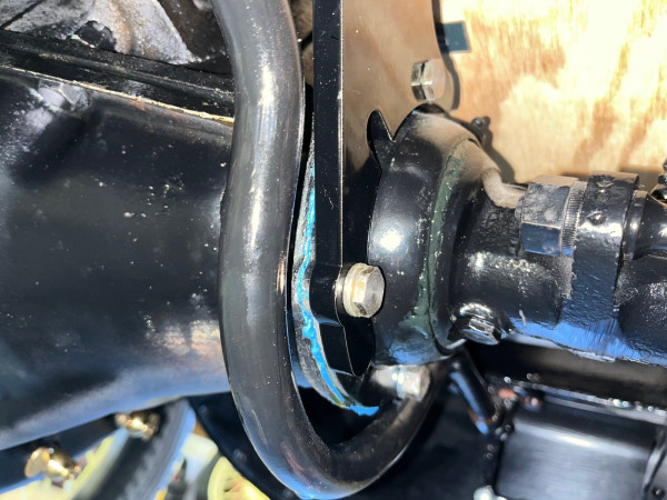

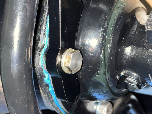

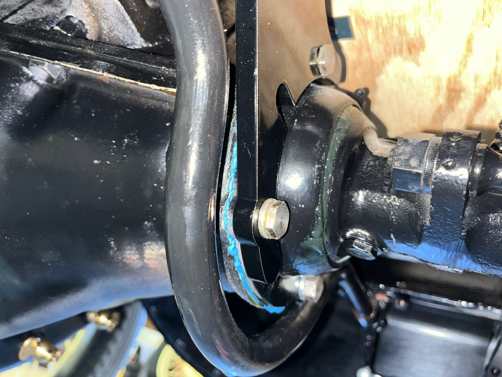

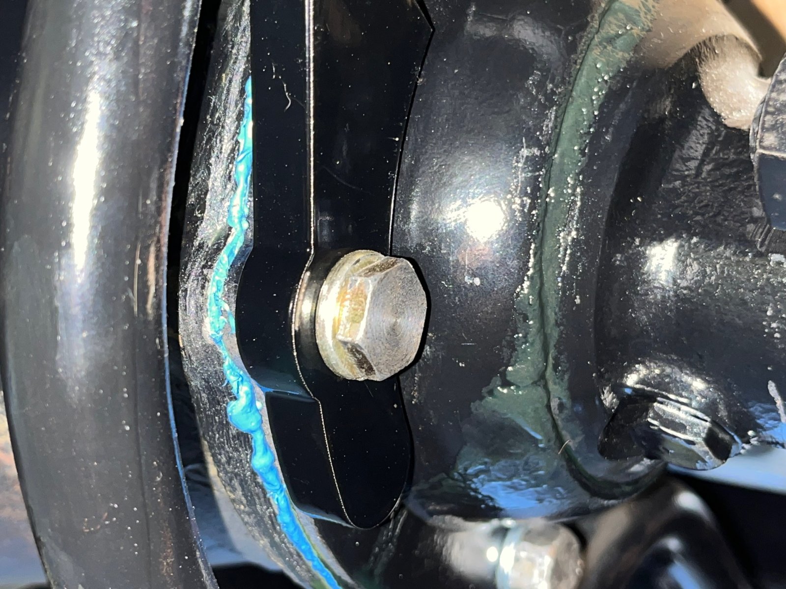

After driving my 1927 coupe 10 miles for the first time since restoration, I noticed grease leaking from the ball joint. This is shown in the attached three photos. How common is this?
The first two photos show the left side of the ball joint, and the last shows the right side.

I see blue stuff. Thats the wrong sealant unless its ultra blue. Ultra or right stuff has a body that is petroleum resistant.
Sealant on that flange is an act of futility. Grease is going to ooze out @ the ball & coat it all.
Cant tell if you used a gasket between the 4th main & D/S flange. Thats a big no no, adding a bunch of unwanted slop in a BALL joint.
That will greatly add to the grease thrown. You need to use a heavy grease. regular stay lube molly melts out easy. A loose fitting 4th main or a missing output shaft plug will thin & wash out the grease sooner.
All the above will minimize the grease dropping.
All that said, its pretty normal.
P.S. IF you DO NOT have a gasket under the D/S flange & your ball joint is still loose from wear, the parts vendors sell a "D/S ball shim" to take up the wear. That will also limit grease drainage.

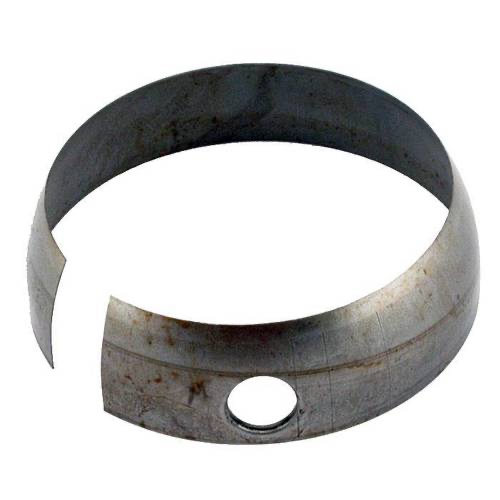

I have always had a ball joint shim T-2581-SH, on mine that works well to stem the flow of grease from my drive shaft ball joint. I’m surprised this has not been mentioned until now. I got mine from Snyder’s. Jim Patrick
