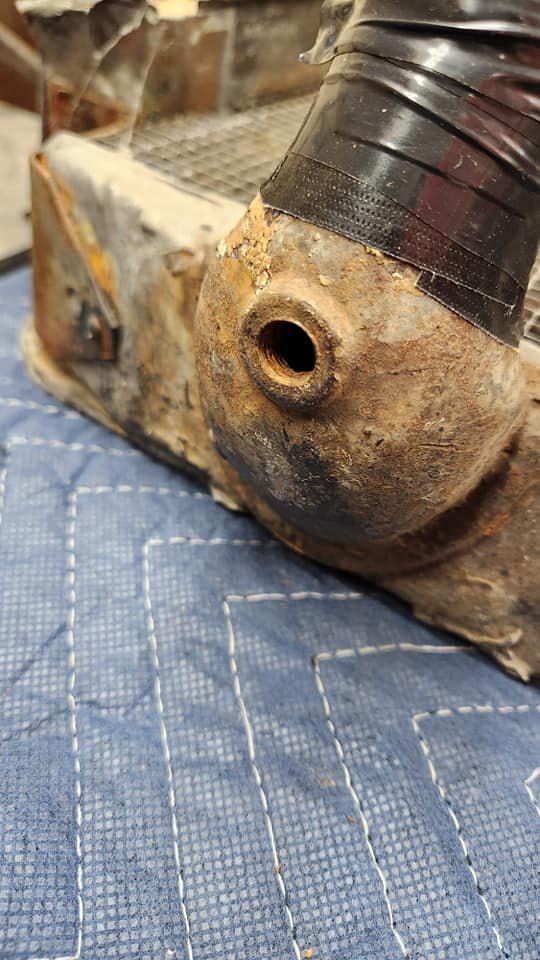

I picked up a decent 1911 Brass radiator just before Hershey. I would like to test it out, but do not know ow the correct thread count and 'bolt' size which would fit in the drain hole where the petcock would go. Is anyone aware of what the size of those petcock threads might be? Thank you in advance. ** Updated with photos **

It is not a bolt, it is pipe thread. Should be 1/8" NPT.

What Mark G said!
FYI. It is however close to a standard bolt thread, a 3/8 - 24 if I recall correctly. Sometimes, if the tapered pipe thread has been overtightened a bit much, the bolt thread can be started in the hole. Do not do that except in an emergency (like in the middle of nowhere and the petcock fell out back there somewhere), as forcing the bolt into the tapered pipe thread will quickly destroy it.

Use a wood dowel, sharpen the end slightly. Then screw it in place. Won't damage the threads.

Excellent idea, I appreciate the assistance. I just want to seal it up to check for leaks.

Of course. I was searching for the right term, but you understood what I was looking for anyways. Thank you.Mark Gregush wrote: ↑Wed Oct 11, 2023 7:16 pmIt is not a bolt, it is pipe thread. Should be 1/8" NPT.

Just screw a petcock in!

Sorry Andrew. Over 50 years of me collecting T parts means I have ample spares. If it is of any use, you could temporarily screw in the top oil petcock from any T to do your leak test.

We all know Henry liked to save dollars and cents whenever he could, seems it took a while on the Pet cocks, the radiator one was part No 3940 with the parts book changing to order and use the fuel tank one 2908 then finally using the oil pan 3079 Pet cock for tank and radiator as well.
