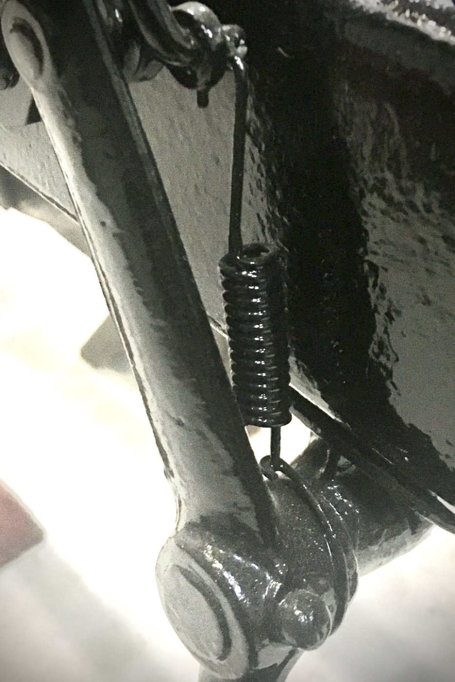

I have installed this Safety Spring on all of my T’s
It’s available at Langs
- Attachments
- IMG_0117.jpeg (8.86 KiB) Viewed 4199 times

Rod, I'm interested in the safety spring you mentioned from Langs. I looked it up in the catalog but I don't know where it goes? Could someone post a picture please? Thanks

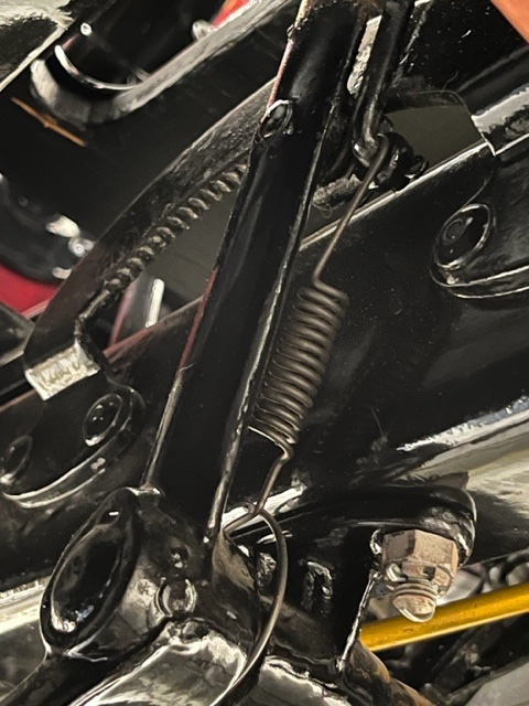

Langs Item Number: 3463R
Hook the upper part and with the help of vise grips, pull the spring down, unhook the large ring, place around the lower shaft and re-clip.
This will insure your brake lever will never jump out of position.
Rod
Rod

Thanks for the pictures, this is something I've been curious about. I bought that spring but wasn't sure how to install it. Going on today.
