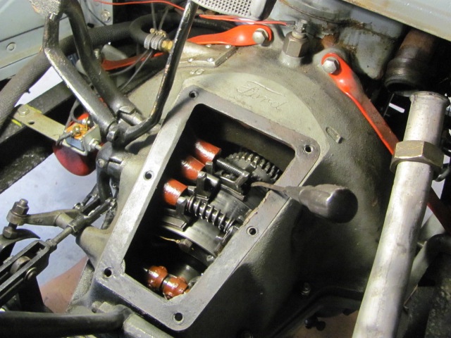

Can someone please post some pix of how they (cleanly/neatly) installed a Brake Light Switch for use on a non-starter hogshead that does have a Rocky Mtn Brake Pedal? If they also know the part number of the switch they used, that would also be helpful.
Thanks in advance!!

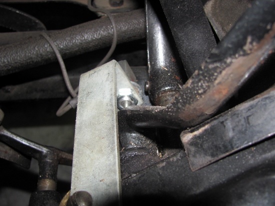

This type is very easy to install. A modern reproduction is made too.
Lang's # 3158RS

RM type brake pedal, this style will fit.

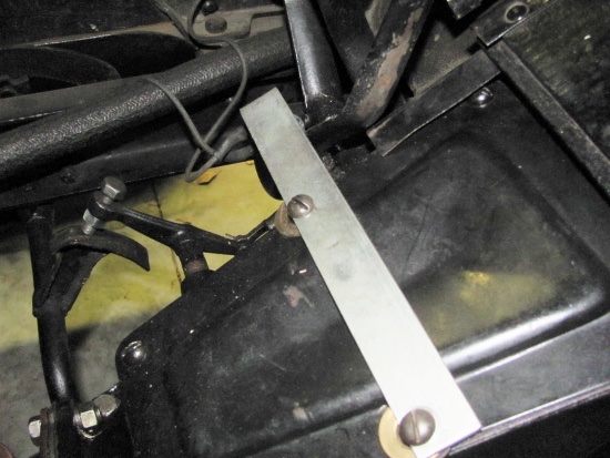

My mistake, forgot about this style that clamps to the frame rail. Had a Fun Projects type on Dixie before, but caused sometimes to not work, so I put on the Lang's # 3158FM. Fit is good, have RM brake pedal and all is well. Likely fit to any brake pedal that someone welded on a tab in any place.

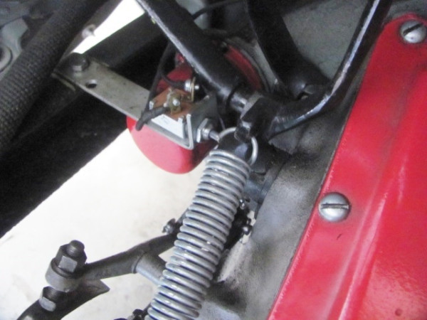

I don't have a picture right now (I'll try to get one and remember to post tomorrow) but I use a normally-on generic brake light switch (like this one: https://www.amazon.com/Universal-Mechan ... 1WMPKJVUMQ). Similar setup to Mark above. I mounted it to the underside of the car a few inches behind the brake pedal (I have a speedster, you might need to fabricate an arm or something for a regular T). I drilled a tiny hole into the arm and slipped a chain through it, which then goes to the brake pedal. Even a light press on the brake pedal causes the tension on the drain to drop, which then turns the brake lights on. Not the most elegant solution and requires a precise adjustment for the chain length to be exact, but its reliable and it works (and was cheap).

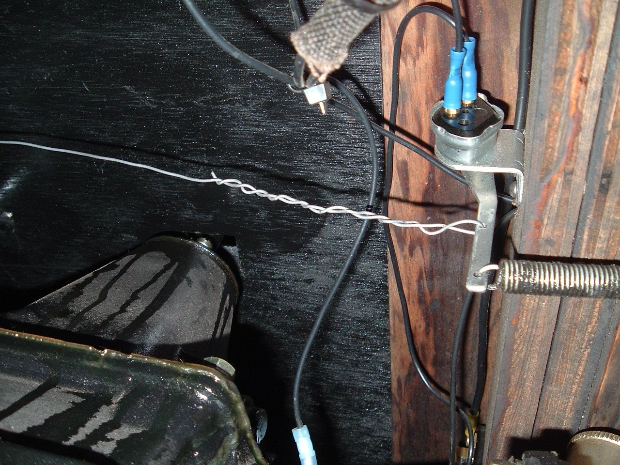

Brent, I use 32-4 v8 brake switches on my Ts. They have a spring loaded rod with a hole in it. I make a bracket to hold the switch and use a short piece of wire and another spring to connect it to the RM brake pedal. I drill a small hole in the base of that pedal to run the connecting wire thru. With a spring in the linkage, you cannot hurt the switch by over pulling. The difference in the V8 and A switches is the V8 switch rod pulls instead of pushes like the A.

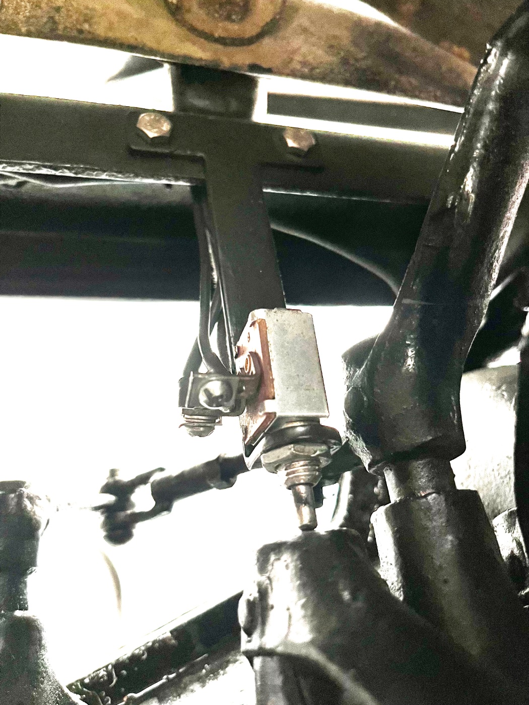

When I first got my T, it had a switch mounter to a piece of flat bar mounter over the hogshead inspection cover, like the photos in the second post of this thread. It had to be removed every time the inspection cover was removed, and the switch had to be readjusted when reinstalled.
I don’t know the brand of the switch.
I made my own bracket by welding two pieces of flat bar into a “T” shape, with two slotted holes for adjustment. I did have to drill two holes in the frame, and i reused the switch. One nice thing about this arrangement is that the wires to the switch run under the bracket, out of the way.

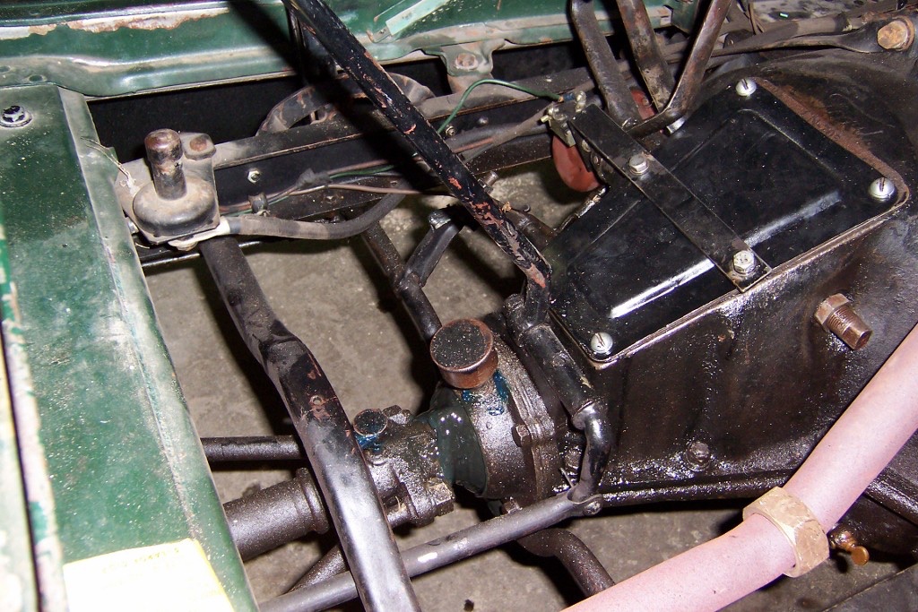

I use an earlier flat inspection cover. A piece of flat stock bent with a hole for a momentary off switch (opposite of a horn button) available at most any parts store. Simply mount such that the pedal presses it closed when at rest. As soon as the pedal is moved on comes the light. No springs, bailing wire ect. A very clean install.

Thanks again everyone. I needed this switch to be 3 things, ...quick, easy, & sanitary. Like many of you, I just don't seem to have time to 'source' stuff like I did in my younger days. If I can order something someone else has R&D-ed, then that is the fastest (a/k/a: quick) way for me. If something is available that will work with little to no effort effort, then that is HUGE with me. The switch that Dan initially showed is very sanitary & appeared to be designed simplistic enough to function well. That was my first choice. My issue was, that I knew I had a RM Brake Pedal however after reading what John said about the cam in the pedal, I inspected my RM pedal and it does have a cam, so the 'quickest, easiest, & most sanitary' way for me was to order a switch from one of my vendors. Thanks again everyone!!
