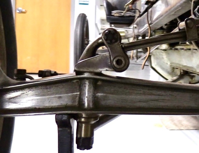

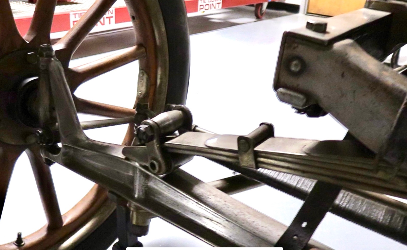

This addition is on the Ford Special racer at THF. It’s only on the right spring, and appears to limit possibly the upward flex of the spring? Anyone familiar with anything similar on other T’s? My guess is this is to help hold curves on tracks, since it’s on the right side only. This is the 410 c.i. racer that beat the Blitzen Benz in a one mile match race at Detroit (fairgrounds 1 mile dirt track) in 1911:

Looks like a good way to break a spring leaf, shackle or the perch, no movement in the suspension by locking up the spring shackles.

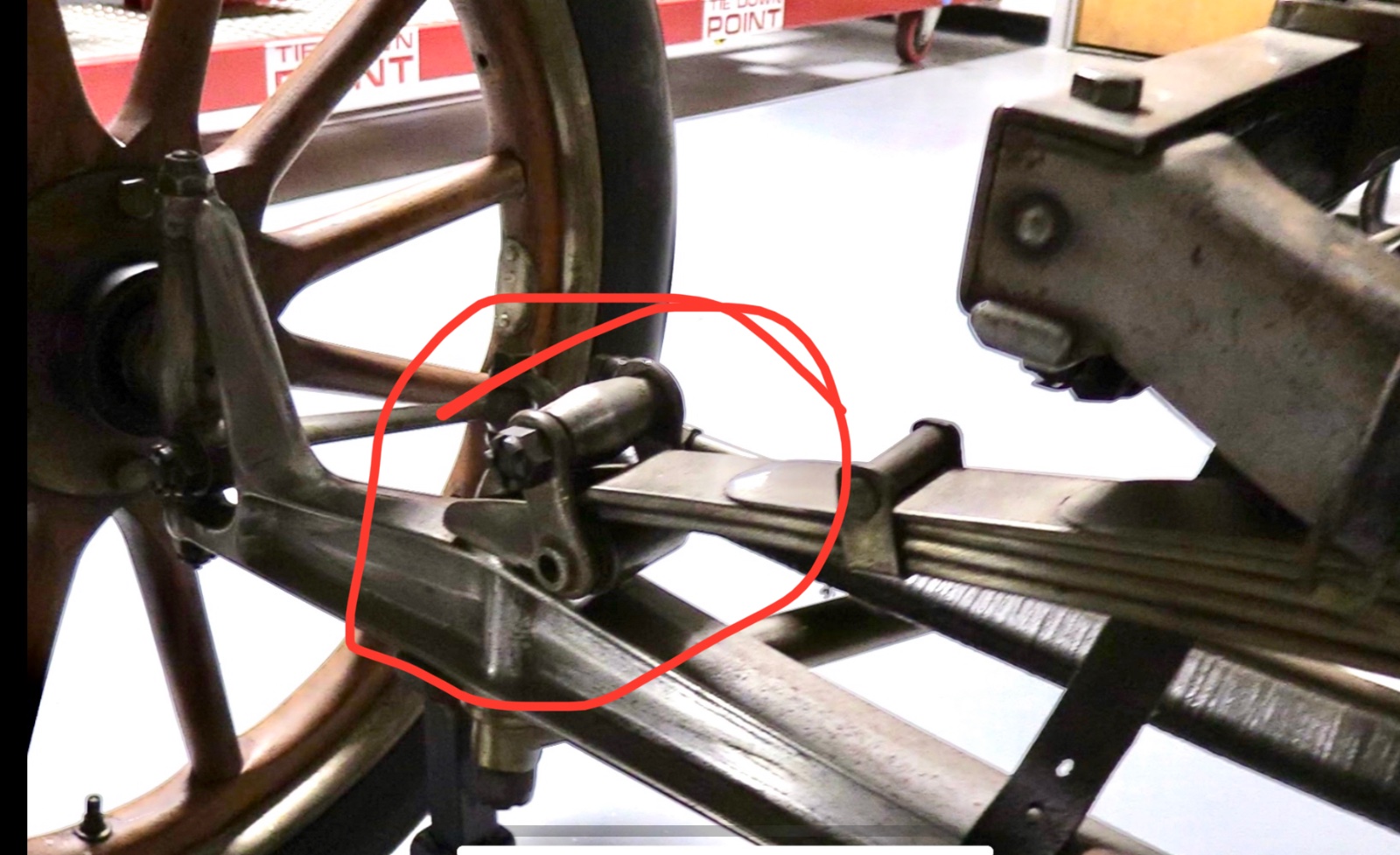

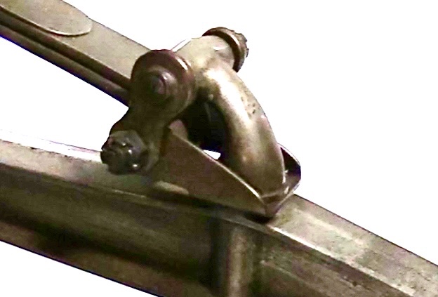

This device looks like it let the spring depress, but not rise at speed. I wish I had taken more detailed photos. It is oval, so not a lock, but allows shackle movement in one direction (downward spring action).

Seems like it would prevent body roll while cornering, only letting the shackle go so far, but not limiting on compression, I like the idea,
