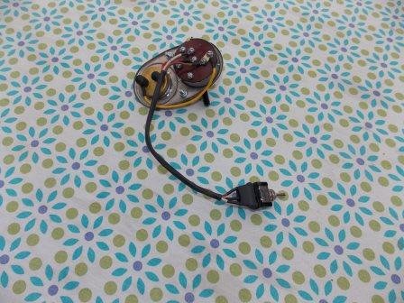

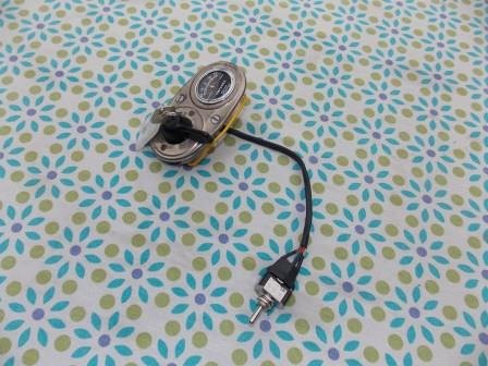

I think you have a short in the horn loop.
But the problem with the contact switch make me think.
Sometime I blow my magneto out on my 1926 touring with a short in the contact switch. The short connected the battery directly on the magneto.
The problem with the magneto started when the switch was hard to change from battery to magneto.
Here is what I did.
I bridged the contact switch with a three way switch.
Last week I had about the same problem with a 1914 touring. There the problem was a screw in the contact switch.
In both cars I had to recharge the magnets with the in the car recharge way.
Maybe this helps
