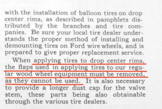

ModelTWoods wrote: ↑Sat Oct 14, 2023 6:51 pmWould I be wise to use a tube flap similar to the ones used on split rims, or would it be counter-productive?
Don't do it! Once had to remove a balloon tire from the wire wheel, that someone placed a flap, and what a struggle! The heavy flap takes a set after time in the curved section, and prevents the bead of the tire from dropping into the drop center on removal....ugh!
Ford Manual for Car Owners, 1926-27 says not too!

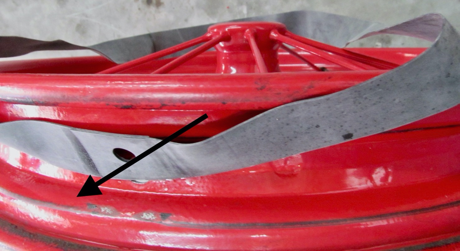

DAN, If I used flaps (and I have decided after posting this that I won't), I was NOT going to use the thick split rim flaps. I was going to cut some flaps out of old unusable inner tubes that have thinner, softer rubber.DanTreace wrote: ↑Sun Oct 15, 2023 9:35 amModelTWoods wrote: ↑Sat Oct 14, 2023 6:51 pmWould I be wise to use a tube flap similar to the ones used on split rims, or would it be counter-productive?

Re: Rust Pitted 26-27 Wire Wheels
Terry
You have the best answer, since you won't be adding any wider flap than a rim strip. The narrow rim strip just lays within the channel of the drop rim, so it cannot affect the fitting of the tire beads into that drop center.
That wire wheel narrow rim flap is used to protect the tube that can contact the channel from the welded spoke weld spots, the rest of the tube is protected by the tire carcass.
