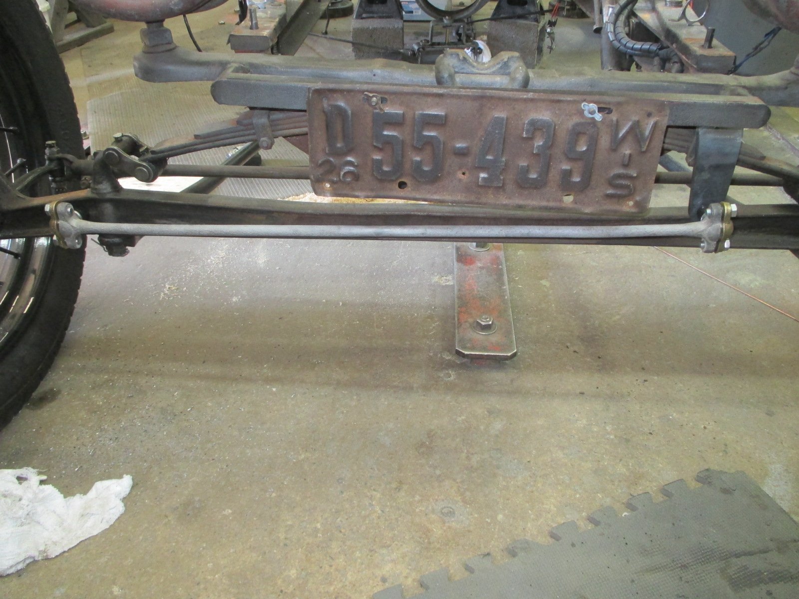

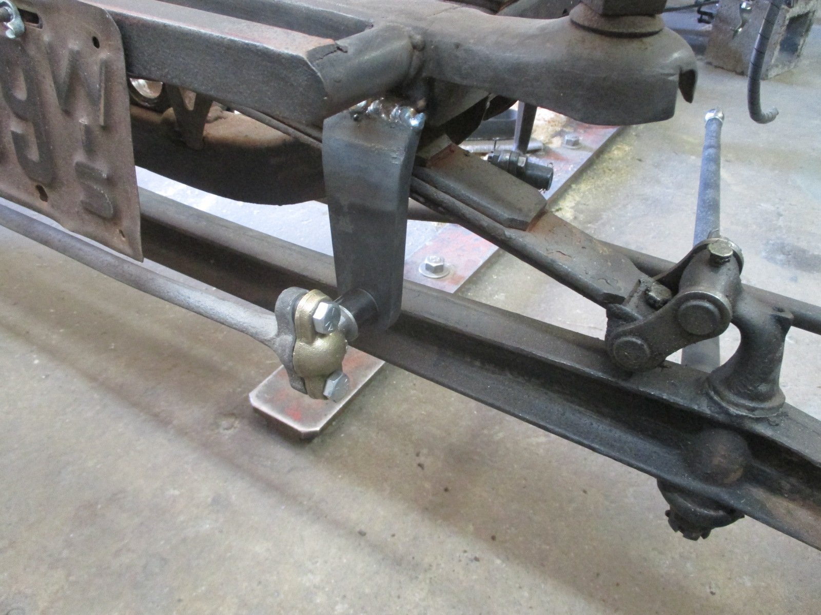

I'm in the process of building a speedster and about to finish the chassis modifications. I would like to see examples of Panhard bars that have been used on Model T's. How were they mounted on both the front front and rear? Those of you that have them, did you see any difference in handling or stability?

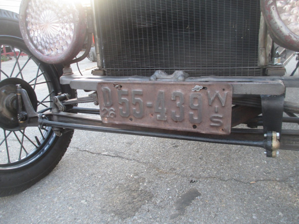

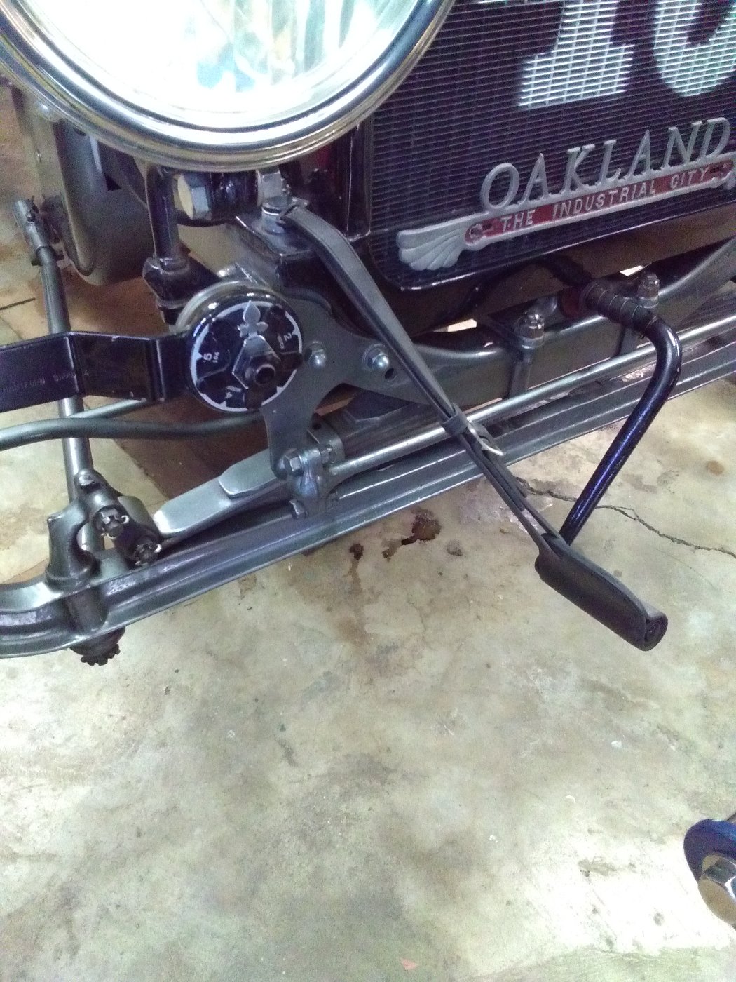

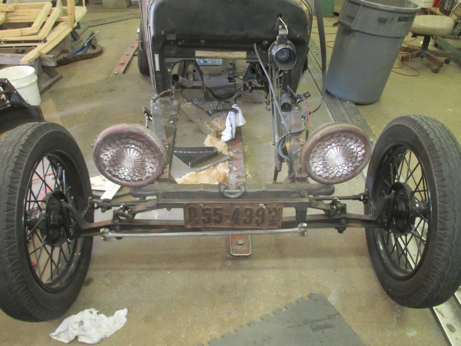

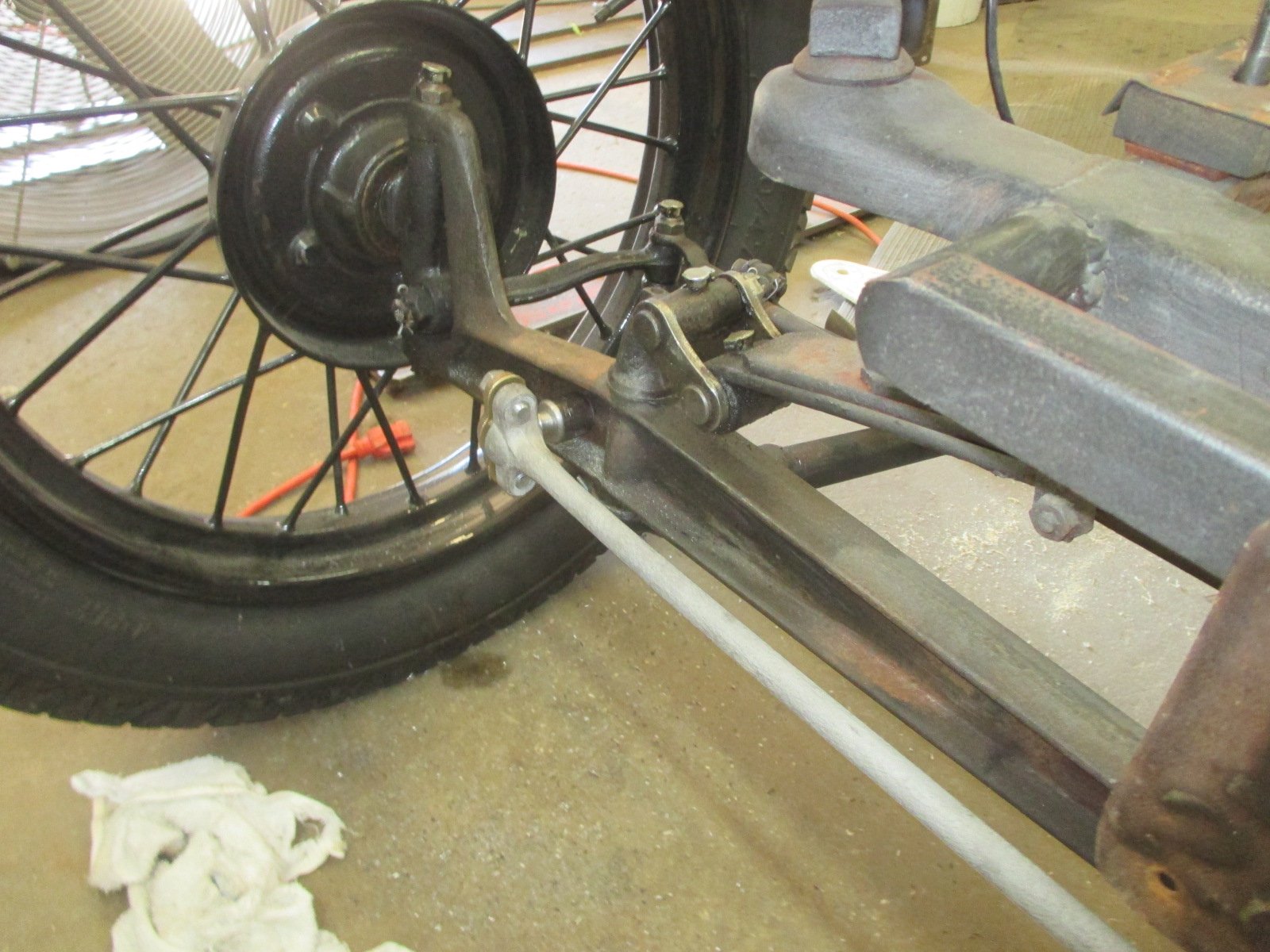

I don't have a pictures at present to show all that I have made but these pix are how I have made one for a 'gow job' T roadster with stock axle. I just used a T drag link to make the Panhard Bar and used new threaded steering balls for the ends. On a T with cross-steer, they make a HUGE difference especially when cornering. I personally don't feel it was worth the effort for the rear.

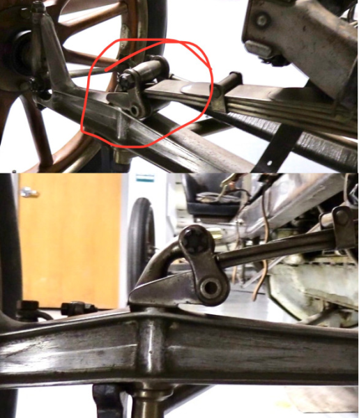

Best to read various articles related to the purpose of panhard bar, sway bars, steering stabilizers etc
Some older discussion https://www.mtfca.com/discus/messages/1 ... 1312792242

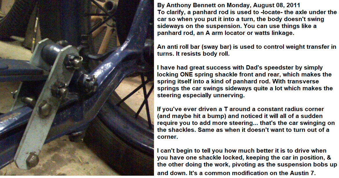

In some recent related discussion about this left the question of its purpose. Sounds like it functions as Anthony described abov
viewtopic.php?f=2&t=39345&p=302989&hili ... ck#p302989

I really appreciate the use of a T drag link & right out front, keeping it more period correct.

Thanks fellas for all the input and photos. If I build one for my car, while still trying to retain the "vintage" look, I will definitely attach some type of absorption device at the mounting points. I figured there needed to be something there like the composite bushings used on modern suspensions. I also appreciate the comments and examples posted by Henry K Lee . . . he is a true engineer and craftsman! I was glad when he came back to the forum so he can share his knowledge with the rest of us!

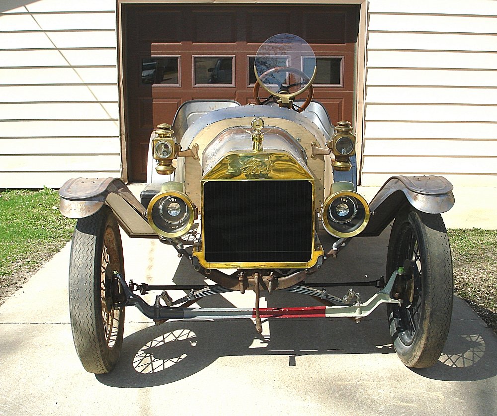

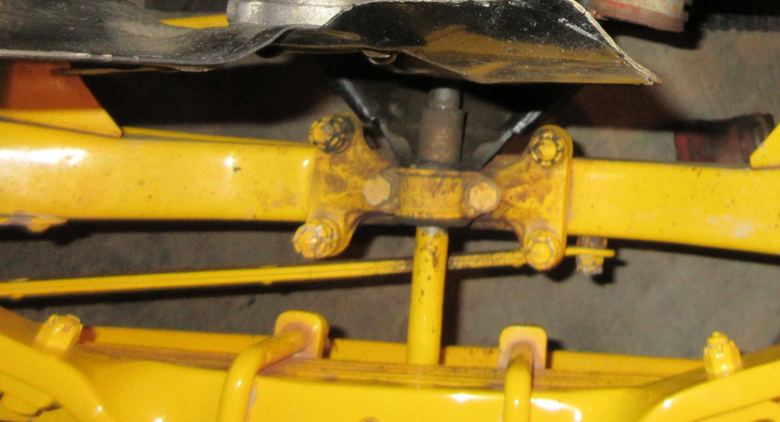

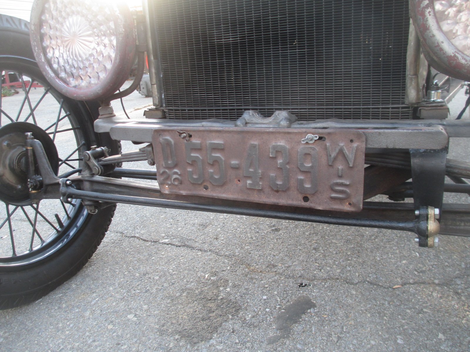

Thank you guys for forcing me to sort through some old photographs/memories, to find a decent shot of the Panhard bar on old #4. Simple but functionable. I know no one needs another shot of old #4 but take a look of the Panhard bar/steady steering device. Bolted to the left of center, on the front cross member and stretching across to the right and attached to the upper bolt of the spring shackle/perch. It's made of approx.1/8"x 1" flat iron with a second layer riveted to it. The second layer stretches almost all the way to the bolts on each end. So simple and I've never had a car that handles as good. The first picture was a gift to me from professional race photographer Ned Lawler, taken at Laguna Seca Raceway in Monterey during a race, as I was exiting a sharp left, turn 11, at speed. The other picture looks down at at the bar with the radiator removed and shows it bolted to that front cross member. There may be better ones out the but this simple set up sure works great and I doubt if many of you are going to stress your car much more than I do.
