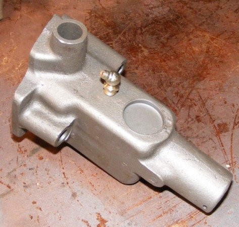

Where does the grease fitting go?
- Posts: 2550
- Last Name: Strange
- Location: Hillsboro, MO
- Board Member Since: 2013
Re: Ruckstell Shifting Problem
Here, according to Stan Howe.
- Attachments
- shift_lock_zerk.jpg (53.57 KiB) Viewed 823 times

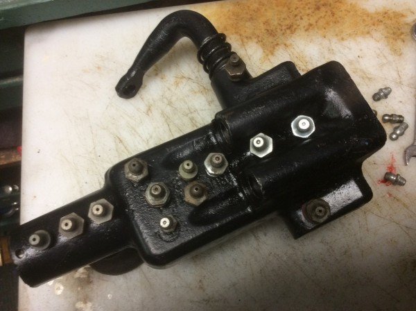

- Posts: 5267
Cant have enough grease??????
Image ripped off from an earlier post.
