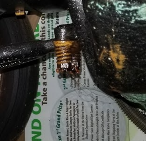

- Posts: 4478
Re: Getting closer to picking up my T
Be sure to wire the studs together at the wishbone socket. They currently have cotter pins.
I don't like that corrosion on the wishbone or the tie rod. I'm sure you'll check that out.
- Posts: 2331
- Last Name: Juhl
- Location: Thumb of Michigan
Listen to Jerry - there is nothing holding the studs in place that secure the wishbone ball to the pan. Wire the studs together so they can't turn.
If corrosion has thinned the wall of the wishbone tubes too much they might bend at an inopportune time. When in doubt, replace!
Not sure where these Cotter pins are that need to be replaced with wire and I'm sure I'll learn. Is there a pic anyone can share, cool.
- Posts: 4478
The cotter pins on these studs. They need to be removed and replaced with a wire that ties the 2 studs togther, preventing either one from threading out, (which cotter pins will not do).
vping
Topic author - Posts: 251
- Joined: Tue Sep 29, 2020 8:01 pm
- First Name: Vincent
- Last Name: Pina
- * REQUIRED* Type and Year of Model Ts owned: 1925 Tudor Sedan
- Location: Farmingdale
I see where that is now. Thank you and I'll add it to the list.
