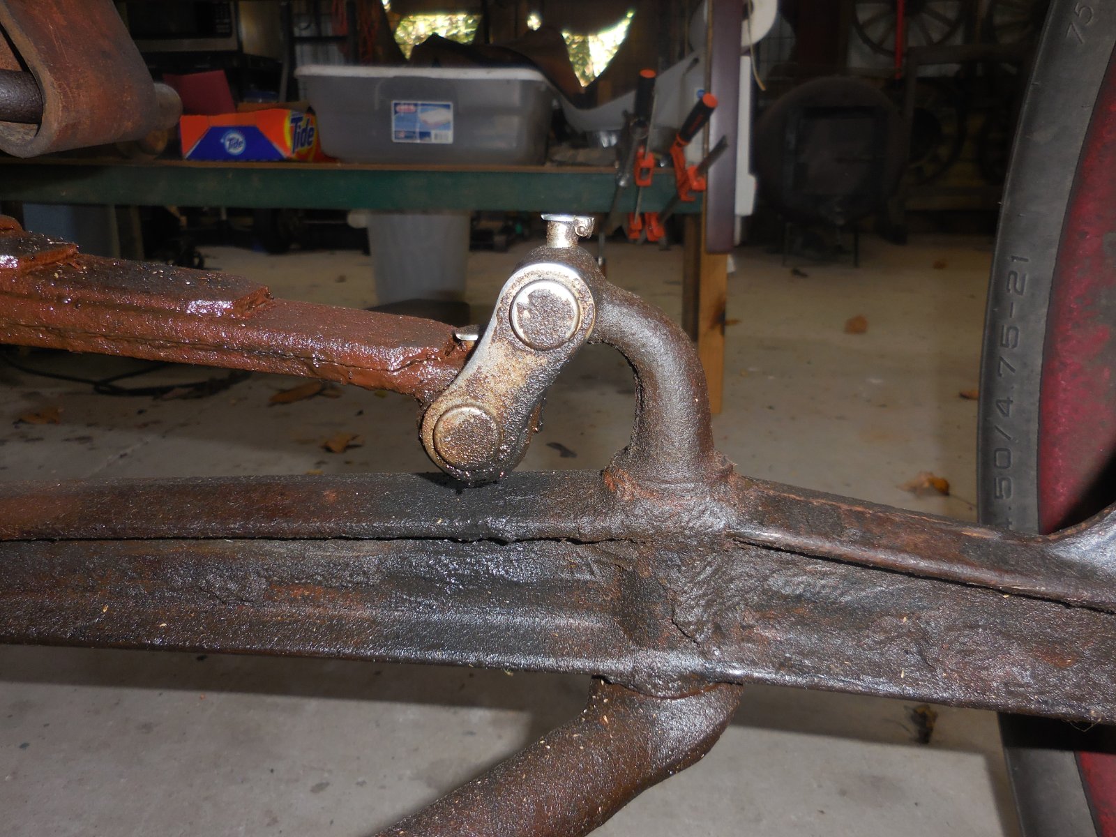

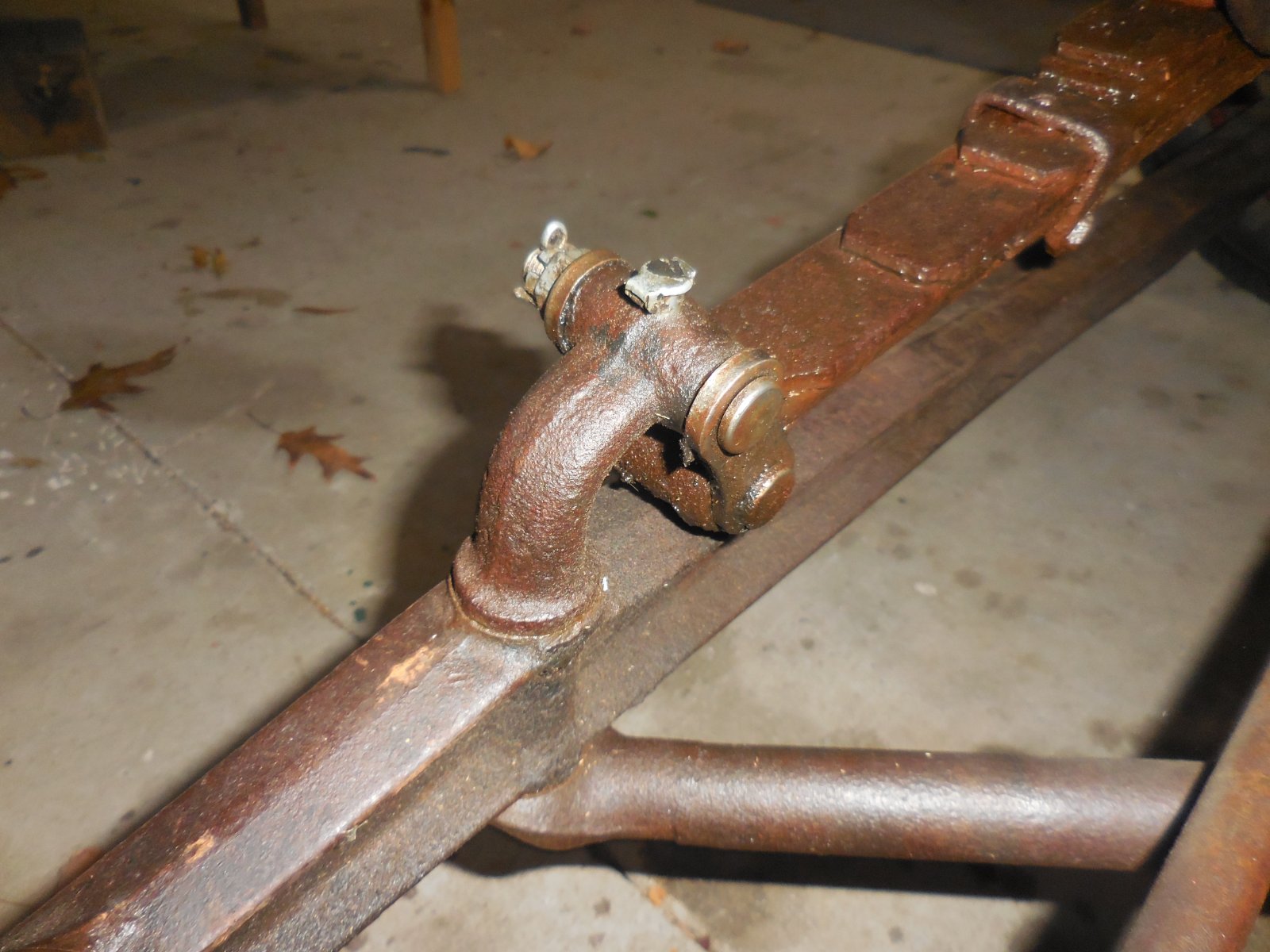

Can anyone tell about these perches on a 1927 roadster pickup. No marks to indicate left or right.
- Posts: 4414
Re: Perch without mark
The shape looks odd also. Any sign of a "Ford "script" anywhere on it? I suspect it may be a not-a-Ford replacement.
There were some perches made by and/or for Ford around 1919 that did not have the centering boss just as the earlier over-axle perches didn't. I believe those were made for just a short time, and they had the proper shape and look to them as this one does not.
Some speculation on my part.
- Posts: 4414
It might also be a part from an after-market shock absorber? It looks a bit tall, there were a few shock absorbers made for model Ts that used slightly taller perches for clearance.

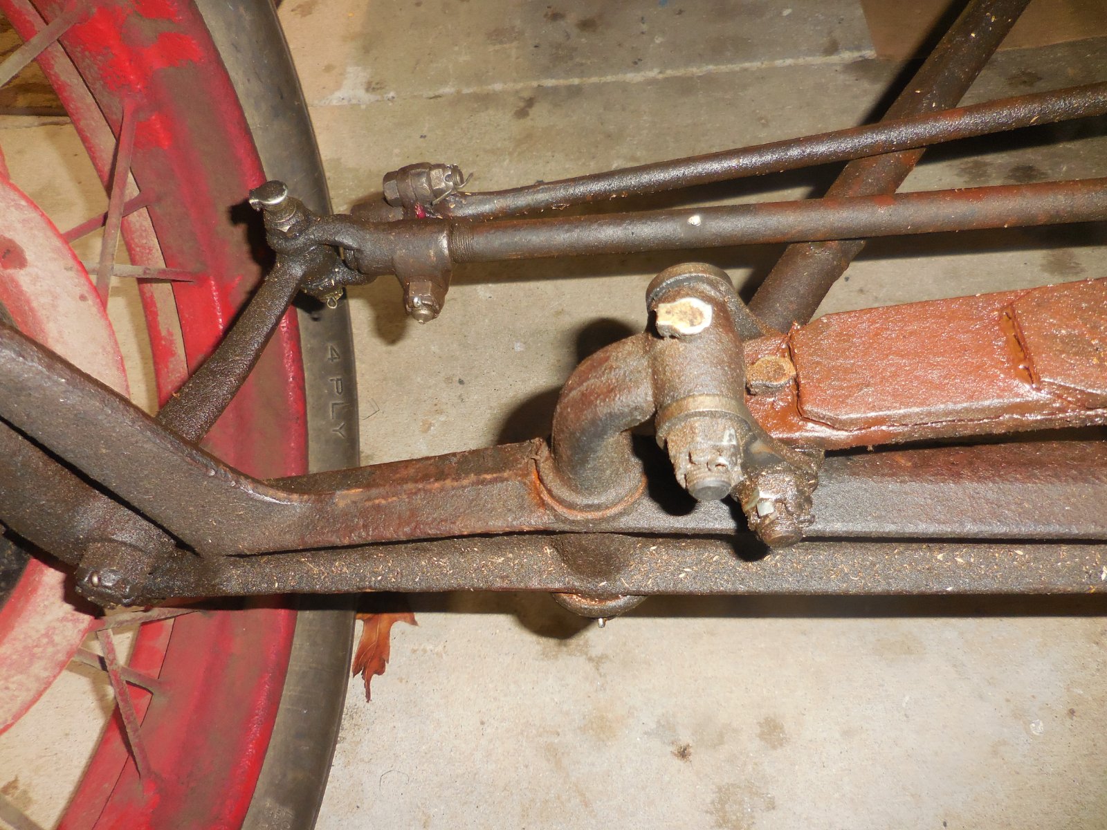

The one on the driver side looks the same. Thought I had a picture of it too.

Per what Steve Tomaso said, only problem is good luck getting those things off! Looks like they're rusted on there for good!
- Posts: 4698
Well you know the old saying! If it ain’t broke don’t fix it! Looking at the perch and how it’s made is a little different than the majority most of us have seen. Maybe an aftermarket?

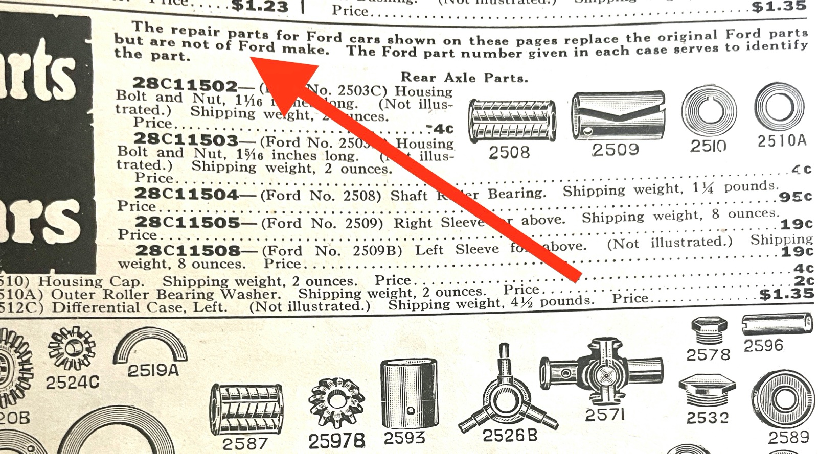

Indeed those perches seem to be non-Ford parts, Ford called them 'spurious' parts
That is why in 1919 Ford began to really mark most all parts with the Ford script to keep these aftermarket companies out of the Ford part business, but competition is the name of the game, and lots of parts were made by outside parties for the Ford!
- Posts: 4698
That’s a good point Dan and reminder from the parts book you’ve got. I have a feeling that we have non-Ford look alike parts on our cars and don’t realize it. I would think the disclaimer at the top of the page was put there for a reason.

I may be wrong but is it normal for the spring bsuhing oiler to be installed in a hole in the spring eye? looks fishy to me?

If the aliment is correct, then they are on correctly. Does it matter if its an after market part after all the years that its been used?
If they are on backwards flip the axle and swap the spindles. The expense & effort to be Ford part correct: new axle, perches, and likely spindles updated to fit the new axle. I'd be more concerned with the spline shackles

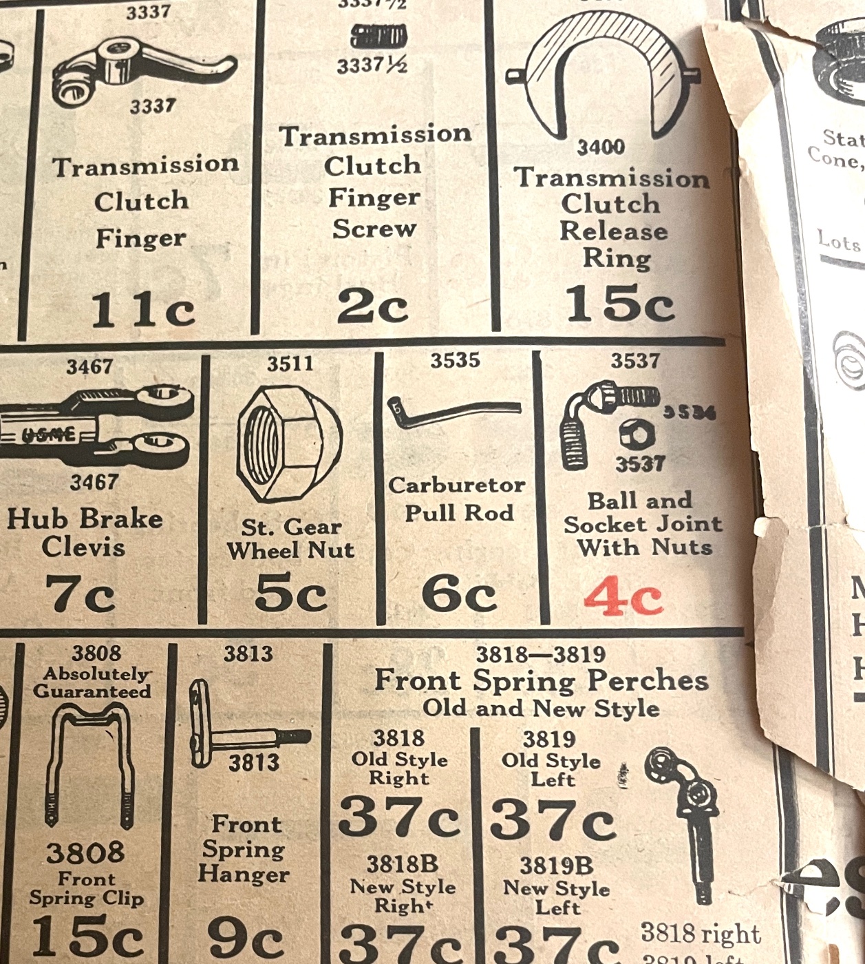

What hobbyist have always taken tongue in cheek or never wanted to admit...
Western Auto also had a catalog in the era where you could pretty much almost build a whole Ford chassis with ZERO Ford marked parts. I bought an old copy on line years ago and was amazed at what they sold 'mail order' or 'over the counter'.
Just a comment, I have no idea what these perches may be.
