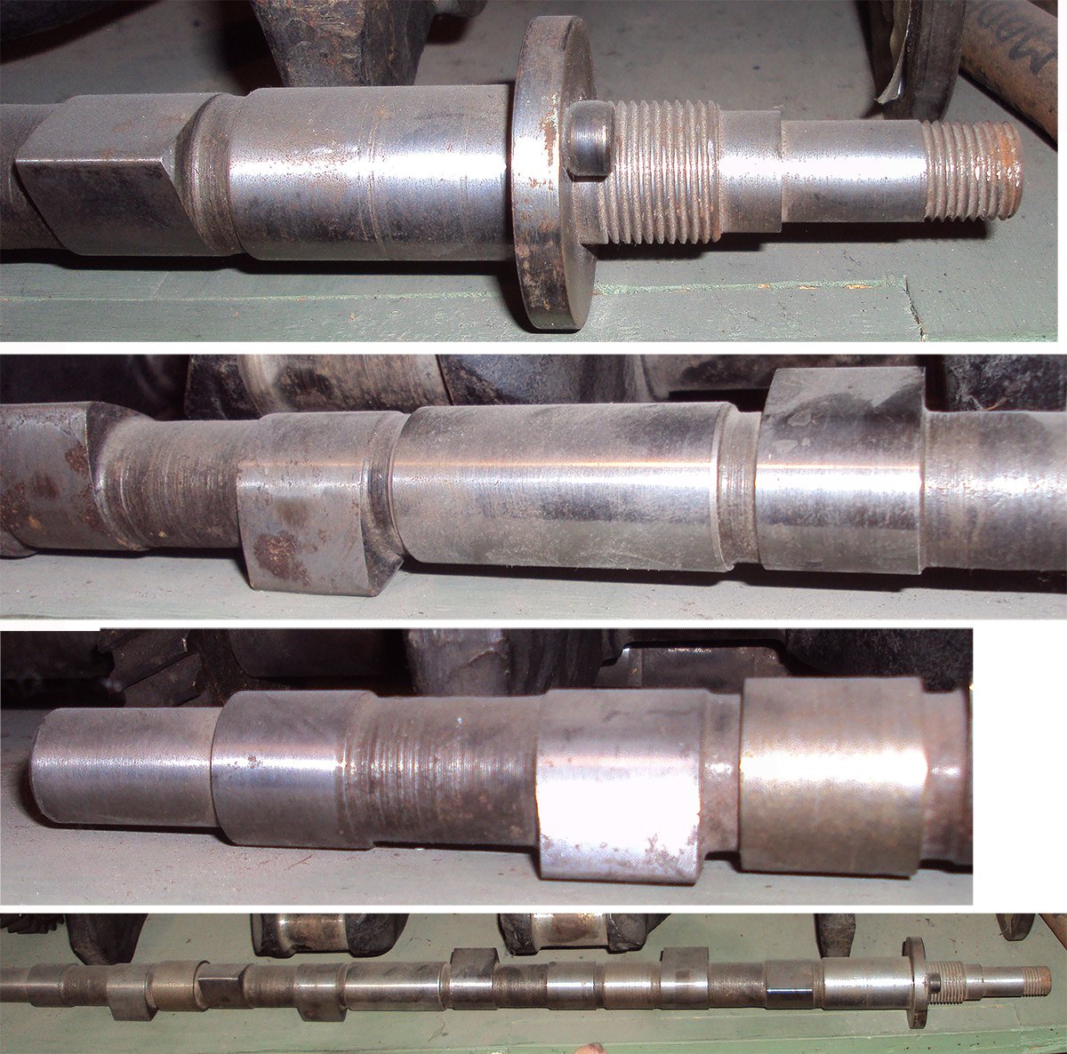

I machined an A camshaft to fit a T block. I simply machined the cam bearing journals (correction) to about 1" diameter and machined the front for a T cam gear. It took some wiggling and turning to get the cams to go through the bearing holes in the block, but it worked.

Post by Rich Eagle » Mon Oct 23, 2023 11:42 am
Here are photos of it. I had planned to make bronze cam bushings to slide in place.

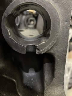

My approach is different. I machine the center and front bearing to run directly in the block (just like on the model A). Then I filed slots for the lobes to slide through. I will try to post some pictures

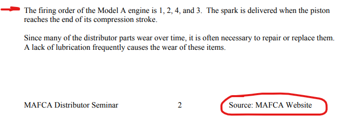

Joe, the Model A fires 1,3,4,2 The Model T fires 1,2,4,3. However the top centers would be the same except that the exhaust stroke and intake stroke would be different. same position of the piston however. If I were looking for performance I would rather buy a new cam designed for higher performance but is made to fit a Model T block. I do not like to do anything which changes the Model T block except to bore out cylinders or re grind valves or insert valve seats.

The Model A is 1243 same as the T, not 1342.

Ran the cam directly in the block cam bores just like the model A. To control the end float i brazed up some spots on the front cover and carefully fitted them to run on the cam gear nut. Installed a VW oil pump on the back of the camshaft and went full pressure. Ultimately a Sherman head and a Stromberg V8 carburetor. In a speedster capable of 100 mph. And a Vega distributor which provides automatic ignition advance. The car is still being driven by a new owner.

Dave, I didn't ever use the A cam. The machining of it was a great challenge, but I moved on to other projects. It would have been fun to try it in my Roof 8 engine. Perhaps a future task.

Block modification
Block modification

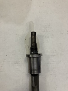

Re: Fitting a Model A camshaft to a Model T
Post by Les Schubert » Wed Oct 25, 2023 3:02 pm

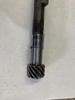

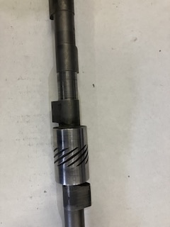

Post by Les Schubert » Wed Oct 25, 2023 3:04 pm
The last picture shows my latest version and the gear drives a flathead V8 oil pump
