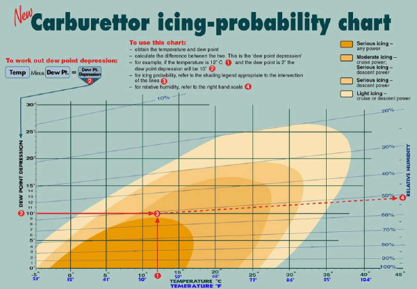

Re: **CARB ICE**
You have to understand the Venturi Effect to understand the icing problem.

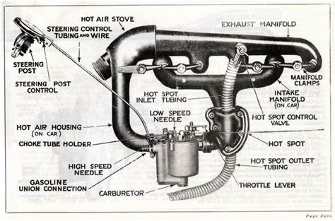

Re: **CARB ICE**
"Hot Spot?"
3
- Attachments
- 20231023_235755.jpg (8.76 KiB) Viewed 2254 times
________________
**FATE**
**FATE**
- Posts: 8677
Re: **CARB ICE**
A T engine would benefit from a well-regulated hot spot arrangement. Under severe conditions, both intake air preheat and a hot spot would be beneficial. Some newer vehicles have rather elaborate manifold heat and intake air preheat systems. They work very well when they are in good condition. If you live where icing/condensation are a frequent issue, modifying the heat pipe to collect more heat may be an option. The exhaust pipe from the manifold back to about the hogshead gets very hot very quickly, and putting a sleeve around it that is attached to the stock heat pipe would probably be helpful. A damper arrangement to prevent excess heat would likely be needed.

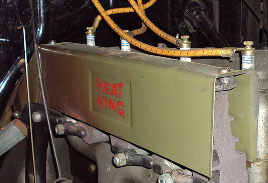

Re: **CARB ICE**
What about using one of those production bolt on heavy cabin heat shrouds and ducting the air to the carb.? I'd want some kind of controllable flap to increase and decrease hot air intake.
