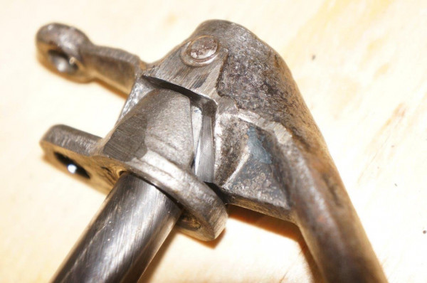

Since the notches are a spiral design they need to match that of the respective pedal. A new notch will not always mate well with a worn pedal.
Here is am older discussion if interested. viewtopic.php?t=15295

Re: question for those that know
If the cam & pedal ramps are good & smooth but worn I weld up the hole in the cam, add some to the outside & mill a new hole to put the
peddle in the correct possion & travel. I only do this on the brake & reverse, low always gets the cam & notch replaced. I also ream & use tapper
pins. I have found broken split pins, bent roll pins & grade 2 bolts in pedals & low notches. I have seen a grade 8 bolt threaded into a low notch.
With the thought that you could replace it without removing the HH??
Craig.
Craig.
Since you have to grind off the head and drill the retaining pin on the low pedal - I'm going to say "no".Craig Leach wrote: ↑Wed Oct 25, 2023 1:00 pmWith the thought that you could replace it without removing the HH??

Hi Tim,
Someone tapped & installed a grade 8 bolt in the notch thinking they could remove the bolt and slip the shaft out and replace the notch & cam
without taking the HH off.
Craig.
