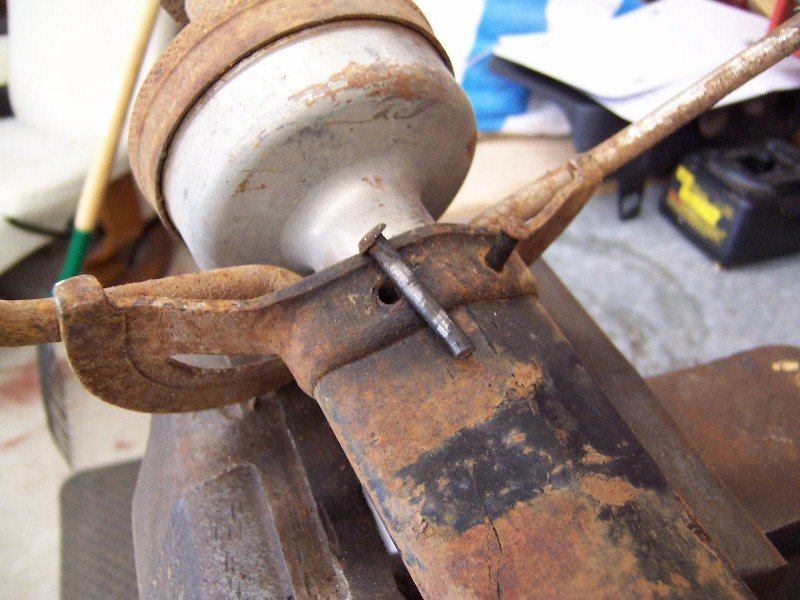

A Model T friend and I have similar problems. Both T’s are 1927. The steering column holds the steering quadrant and they are held in place by 2 steel rivets. On each of our cars there is excessive play (wobble) of the quadrant within the column. This play creates excessive play in the steering wheel. They both drive well but some tours do not allow a Model T on a tour if the play on the steering exceeds 2 inches, and we both tour, so we need the do-the-fix and replace the rivets.
We plan on using a rivet bucking tool on one end of the rivet and a pneumatic riveting gun to to the work.
Here is my question- Is the any advantage to heating the rivet?
Pro’s and Con’s please.
See the picture which was borrowed from a post made by Dan Treace back in 2012

You don't need to heat the rivet. I would also not use a rivet gun for rivets that small. It's very easy to do cold, with a hammer and proper rivet sets. You'll also have better control by using a hammer. Be sure to upset both ends of the rivet enough to make the head bend over, deform, to match the angle of the column tube.

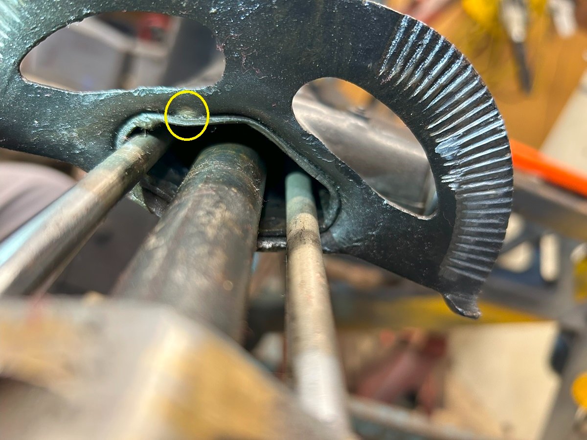

This is where I am now on my column. With the steering assembly removed from the car and in a vise with rubber jaws, I have found that a previous owner had attempted to fix the sloppiness. His work made my job of disassembly tough, to say the least. Take a look.
See the blobs of weld (obviously mig or tig). There was a blob in all 4 "corners" of the oval housing that the inner assy fits in. I think the purpose of these welds was either to tack the inner to the outer or possibly to act as shims to take up space.
It didn't work and 2 of the welds came loose when I hammered the steering shaft back.

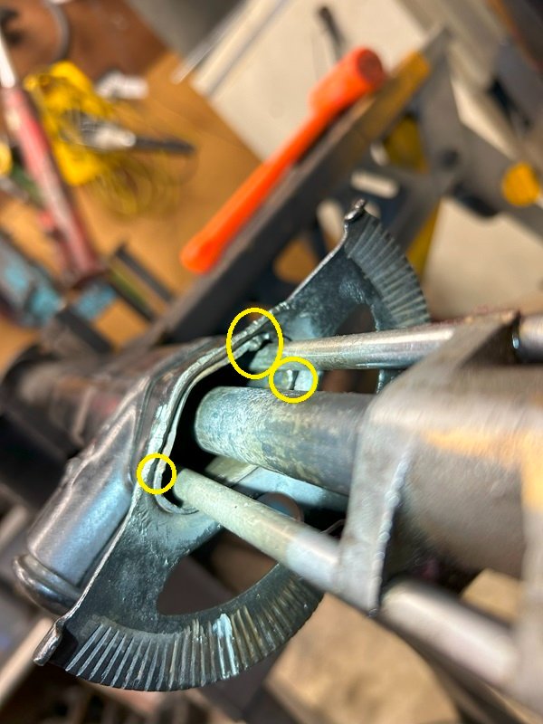

Now, look at this next image- column flipped over. Someone has either hammered a small chisel or screwdriver between the tube and the part that puts friction on the timing/throttle rod, thus bending the tube towards the inner assy, then adding another blob, in hopes of not needing any shims.
I'm meeting with Phillip tomorrow to examine has column and to come up with a plan.

Terry- what caused mine to freeze up was the friction from the welded blobs and the spot where the chisel lapped the tube onto the inner assy causing the part to slide out.
John- I haven't measured the gap yet, but I'm guessing it to be around .010". That equates to .020" wobble in the internal assy, and probably 1 full inch play in the steering wheel. :D

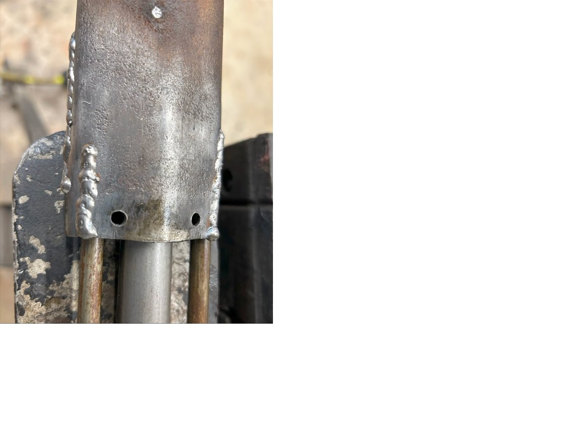

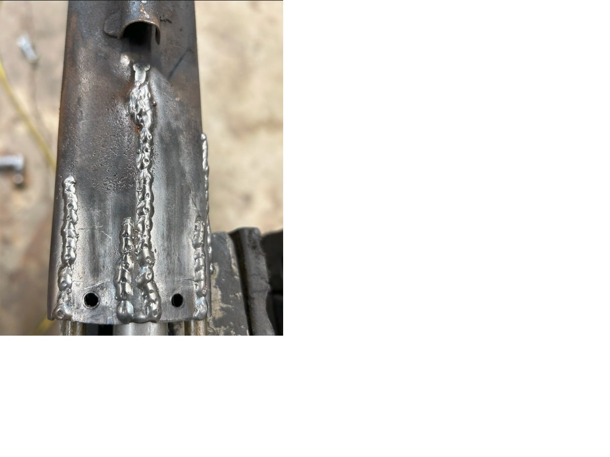

Today, we inspected Phillip's column. We found some cracks in the outer tube that were causing almost 3" back and forth play in his steering wheel. We found a total of 6 cracks. They have been welded and ready for the welds to be ground down tomorrow.
My column had no active cracks, but there is one that has been welded at some time in the car's past.

Report! Phillip and I got the internal wobble issue that was on the upper end of the 2 steering column resolved. On each column, we replaced the rivets near the steering wheel. We first tried a pneumatic gun type hammer and a bucking bar but we weren't satisfied with the results. So, we we used a heavy hammer, a 3/8" punch and a vise as an anvil. Things went really well. Neither column has any internal wobble now and both cars drive great. Thanks to all who offered help! This is definitely a TWO MAN JOB!
