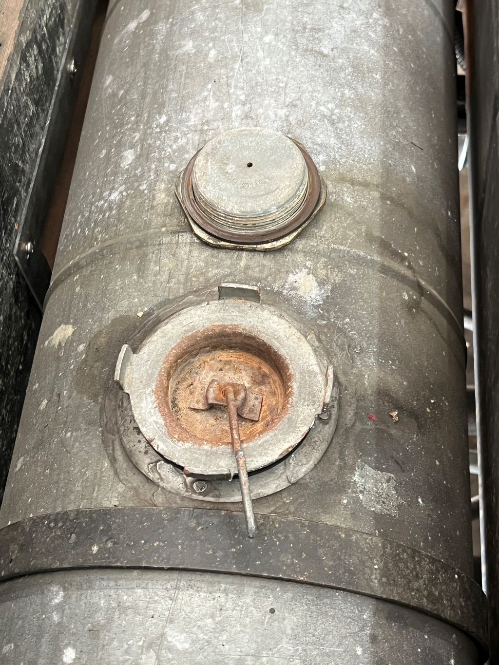

What is the gas cap size and thread on an oval 25 gas tank?

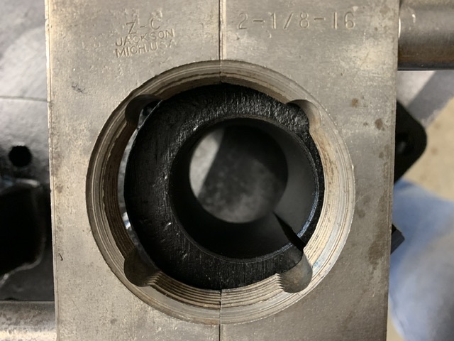

The gas cap is a 2-1/8" x 14 TPI thread.

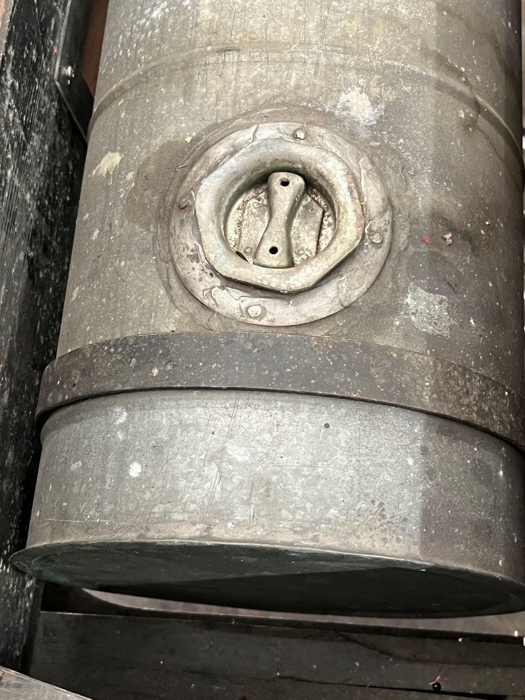

This is a 10 gallon round gas tank on a '15 Roadster.
The mount bands, shape and size of the tank are the same as the tank on my '16 Touring.
The cap however, is the same thread as a five gallon "jerry" can.
A Jerry can cap fits perfectly. (second photo)
