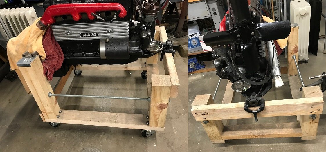

I mount the engine, less starter on an engine stand. Set the transmission end down to keep the weight low. I tear down the engine from it.
Sometimes I use a modified shopping cart. Basket removed.

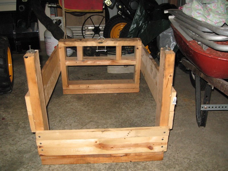

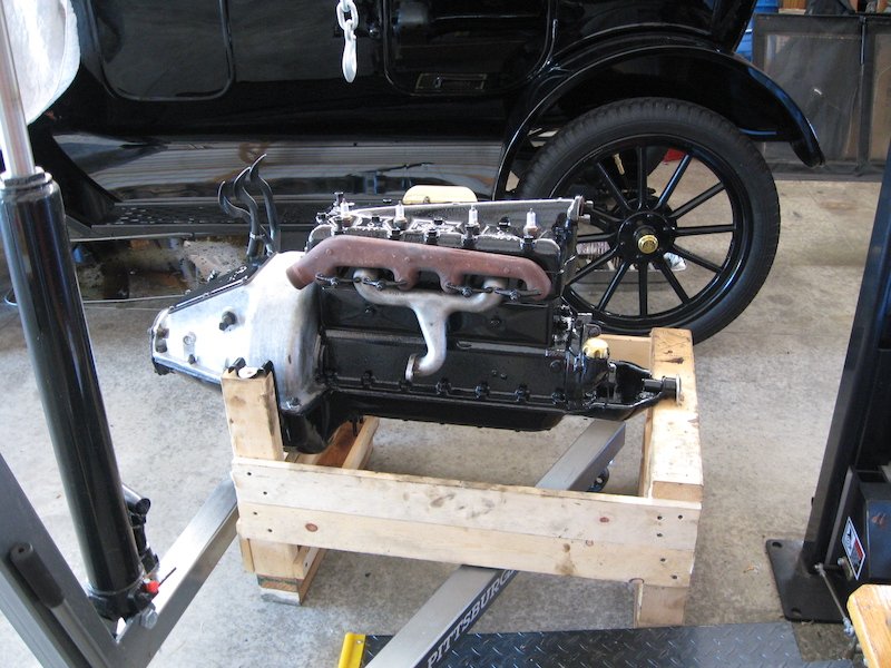

Something like this works real well for me. Stole the idea/dimensions from Joe Bell!Campbell Tellman wrote: ↑Wed Nov 01, 2023 3:44 pmI have a 1916 Touring with a 21-22 motor with generator and starter. What does the trans/engine weigh? What would you recommend to carry engine after removal from chassis?
