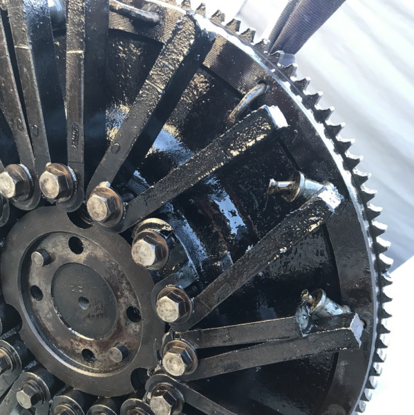

I used synthetic oil and this happened!!

Can you blame that type of damage on a certain type of oil?

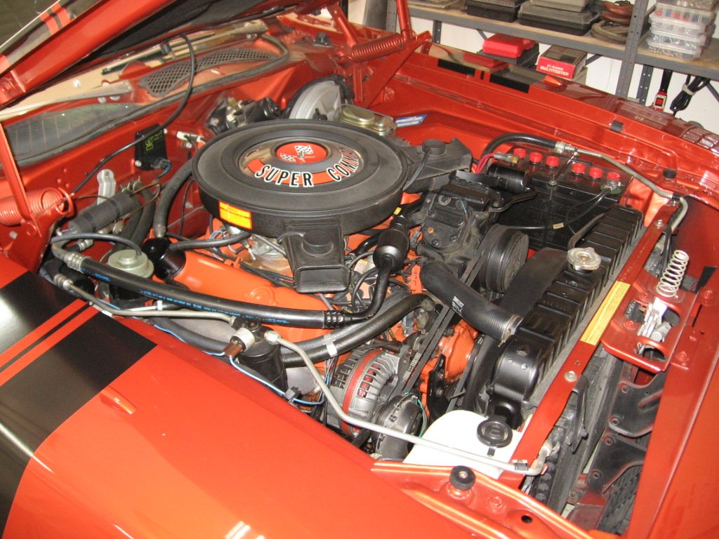

Mopar 440 (and other big and small block V8s of the period) still rely on splash to lubricate the cam lobes.
I used to own a 1971 Plymouth GTX:

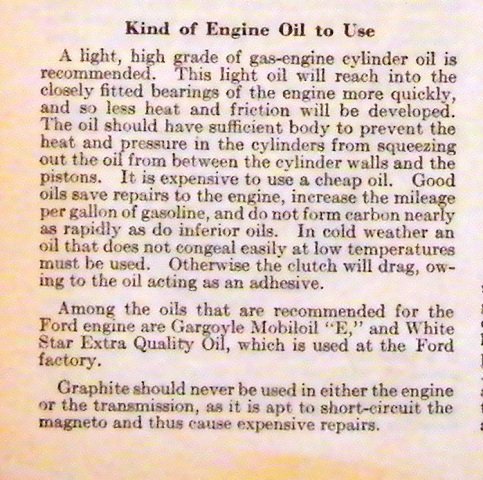

Ford specified the oil grade as “Light”. But what does that mean exactly? How do we know what “Light” oil is when looking at the oil available in the auto part store or Wal Mart? The guys who collect oil cans know the answer, because there was a period of time in the 1930’s – 1940’s when oil cans were marked with both the old “Light, Medium or Heavy” designations and the current designations. Here is an example of a “Heavy” motor oil from a Sinclair can of about 1940: So we now know the answer. Here is a cross reference chart:
Light = SAE 20 Medium = SAE 30 Heavy = SAE 40
So we know definitively that Ford specified SAE 20 when your Model T was new. Back in those days there was no such thing as detergent oil, and multi – viscosity oil was also decades in the future. Let’s consider the advantages and disadvantages of each of these technology advances.
